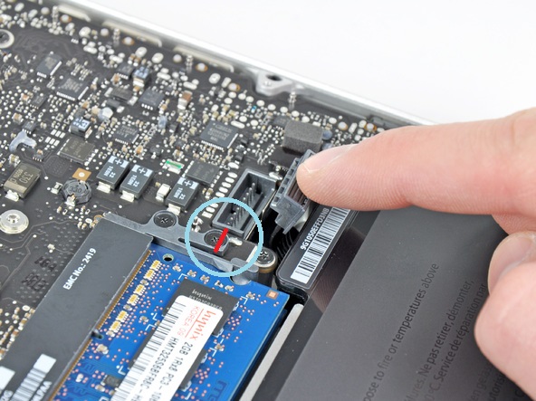

Hey Everyone, bumping this thread with an update. The 'battery not charging' symptom has been an intermittent problem on this laptop for a little while now. I have since starting this thread replaced the battery and the magsafe board to rule out those culprits, and have determined the cause of the problem I believe.
There is a fracture in the logic board right near the battery connector. I have attached an image identifying the location. Unfortunately because it is on the main board I'm not sure what my options for repair would be. I was wondering if maybe I could squirt some conductive liquid metal (is this a thing?) into the crack, thereby reuniting the traces, then use hot glue around the area to insulate it. Any ideas? Sadly I am not aware of anyone offering board repair services in my area, and I'm not quite ready to scrap this computer over this problem. Thanks for your help!
