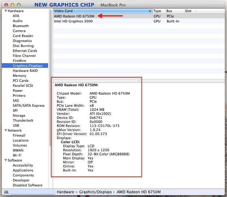

I am in the UK & found a number of independent repairers that offered to remove the faulty Chip & install a brand new, recently made Graphics Chip to deal with the problem.
There were a few of issues however:

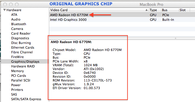

1) The AMD HD6770M that was originally in my MBP is no longer available so it would be replaced with a HD6750M instead. This is the same as that used in the Early 2011 models & I was told that compatibility was not an issue & the performance between the two was marginal at best.
2) There are fake chips being peddled around the market by Chinese vendors so it is important that any repairer is aware of this & only uses genuine ones.
3) The new chip must be replaced with leaded solder as opposed to the unleaded one.

They did an evaluation & after confirming it was most definitely the Graphics Chip fault, did the repair within 7 days.
I got the MBP back yesterday & have left it running for most of the time since using graphics stuff like Sketch Up, watching movies etc & it seems rock solid. I hope it lasts but time will tell.
