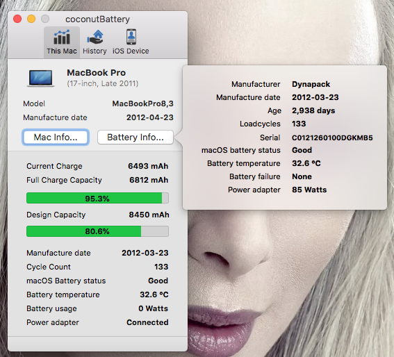

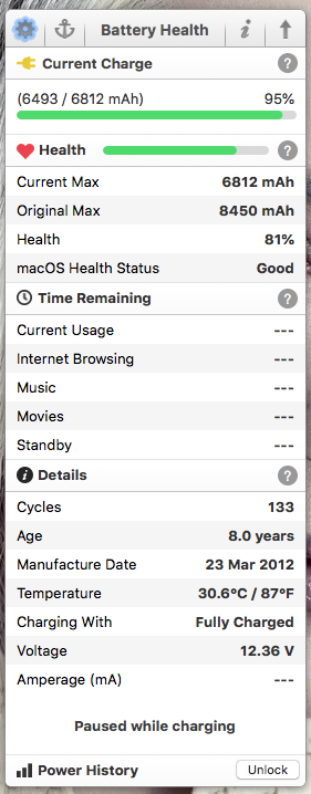

Again, thanks greatly for the info - I used the large 17" MBP as a desktop replacement so it was pretty much always connected to the mains ac power. Like a noob, I thought the low number would preserve the battery for much longer - luckily, it still charges to 100% - I have attached a couple screen-shots about battery health - I think for it's age it still looks good - can you confirm?
Many Thanks!

You will want to investigate whether the battery is going bad and has swollen. The 2011 track pad was hard to click and upon removing the battery, to check the trackpad from underneath, I found the trackpad then worked just fine. I discovered the battery was swollen and pushing on the trackpad.

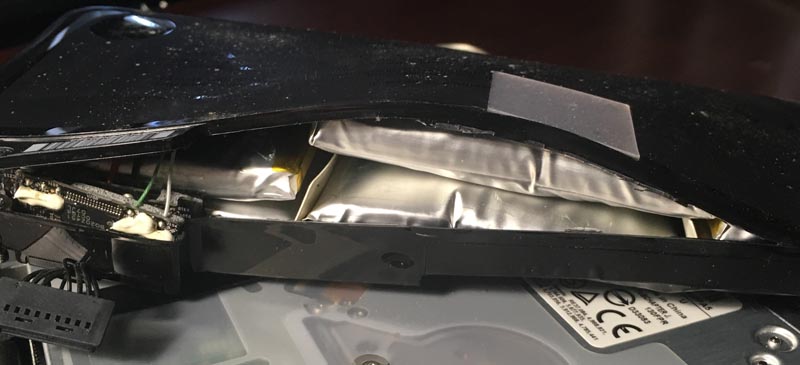

Once it starts to swell, it's a goner. You don't want that thing to pop. I pulled a friend's battery when it was swollen, for some reason he took it into his back yard, put it in a metal trashcan and started poking it with a stick. There were fireworks.
Ya.
I second the swollen battery probability being the cause of a tight trackpad.
My 2008 UMBP's removable battery swelled and made use of the trackpad almost impossible. The battery even made the battery cover pop off because it was so swelled.
I wouldn't trust that battery for nothing. Attached is a picture of a battery that was in a 2011 MacBook Pro 13" that wasn't used for almost 2 years and was then charged. Some time in the next week this is what happened. Had to drill out one of the screws that held the bottom cover on to take it off. A new battery for your MBP can be had at Other World Computing https://eshop.macsales.com/item/NewerTech/BAP17MBU95W/
