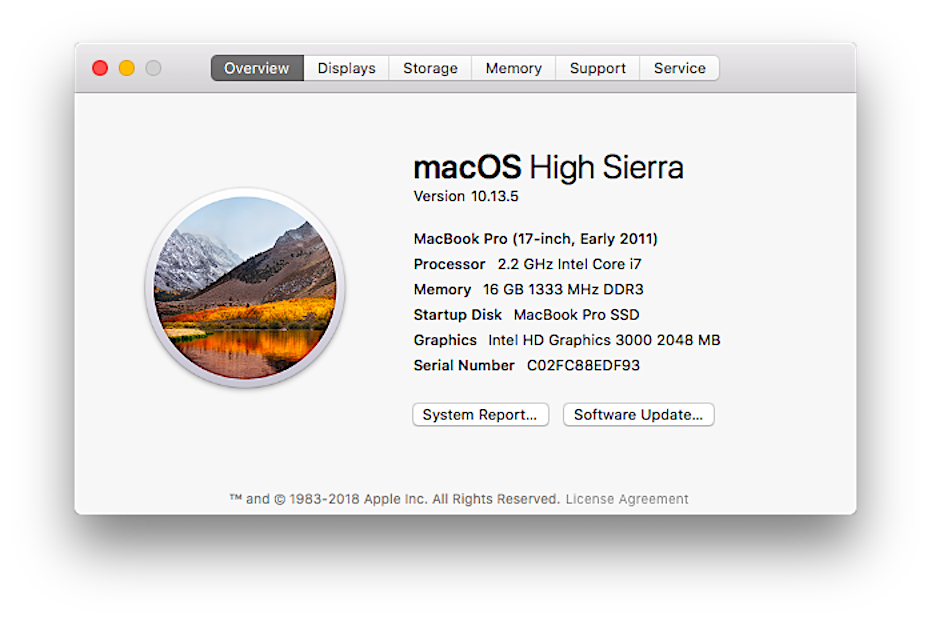

The 2011 & 2012 MBPs are approaching the zone where RAM will slowly increase in price. At some point in the not to distant future, the supply side will dwindle. As the available supply dwindles, the price rises. So, my respectful suggestion is to max out your RAM in these models. 16 GIG RAM is fairly inexpensive at this time, depending on where you prefer to buy. (07/07/2018). Available RAM in the 2011 • 17" model (and probably others) affects how much main RAM can be assigned for the VIDEO card. In my case the Integrated Intel HD Graphics 3000. See the photo.
