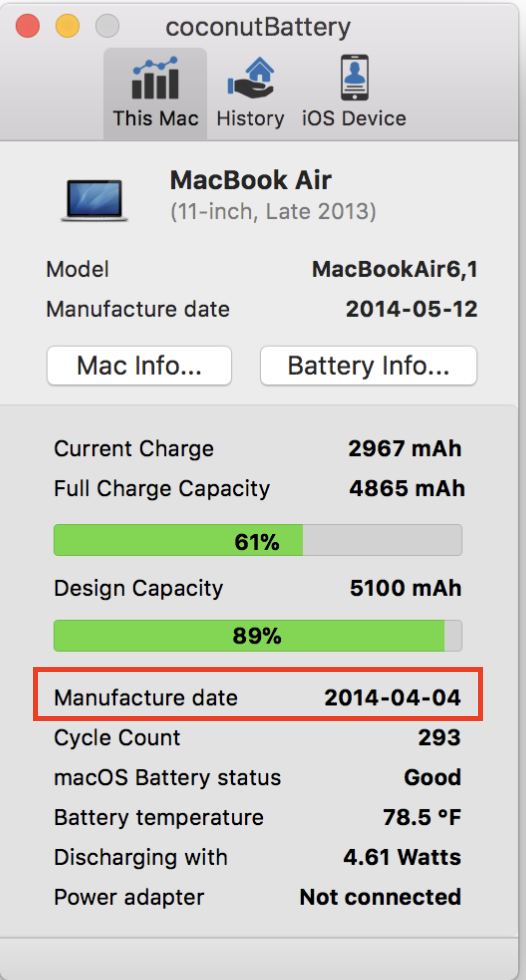

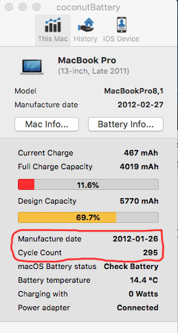

Installing CoconutBattery could eliminate the assumptions by revealing the battery's date of manufacture ;-)
For example;
Reactions: MIKX
