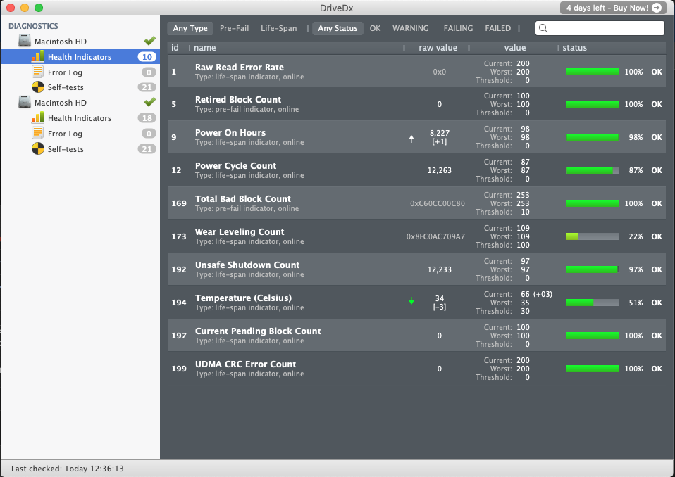

My late 2012 i7 iMac is still running at a very usable pace, except when it comes to using Windows 10 on Parallels. That takes 2 minutes to load and on first load of Chrome, its 25 seconds!
So, I ran a hard drive test using DriveDX and the results were not good for the SSD part of my fusion drive:
Lots of wear, signalling not far from end of life. Add in an error that cannot be fixed with DiskUtility and I figure I should switch to an external 1TB SSD drive. My internal fusion drive has a 128gb SSD part (less than I thought it was!) and a 1TB mechanical part.

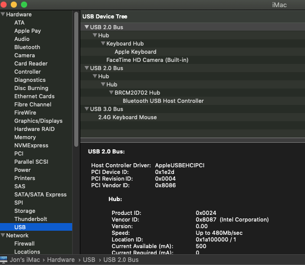

Does that mean USB 3.0 Bus is only available to my keyboard and mouse?
No, the Late 2012 iMac's USB ports are all USB3, or what is now called USB 3.2 Gen1.
It looks like you have a wired Keyboard which has USB ports on it, creating a USB2 hub. Your Mouse appears to be wireless, and maybe the receiver is plugged into the USB ports on the back of the iMac?
The iSight camera and BT internally connects to USB2.
If you go with a USB SSD, I suggest using one of the ports on the back of the iMac. The keyboards ports are not powered and are the slower USB2 speeds, but will would work if you really needed it to.
