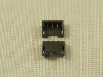

I did save the connector, but there is a pin missing from it and I don't know what happened to it. Guess it fell out...
Hope you held on to the connector and did not throw it away, sometimes little things like that can be time consuming to source.
You can source them for ~$4 from 2-5 pin on eBay. But whether that can be soldered in a DIY fashion is another matter.

Lifting of the tracks due to overheating is a common thing and easily fixed. Good find on the connectors on eBay, I suggest you get that connector which will save the repair outfit spending time on sourcing it.
