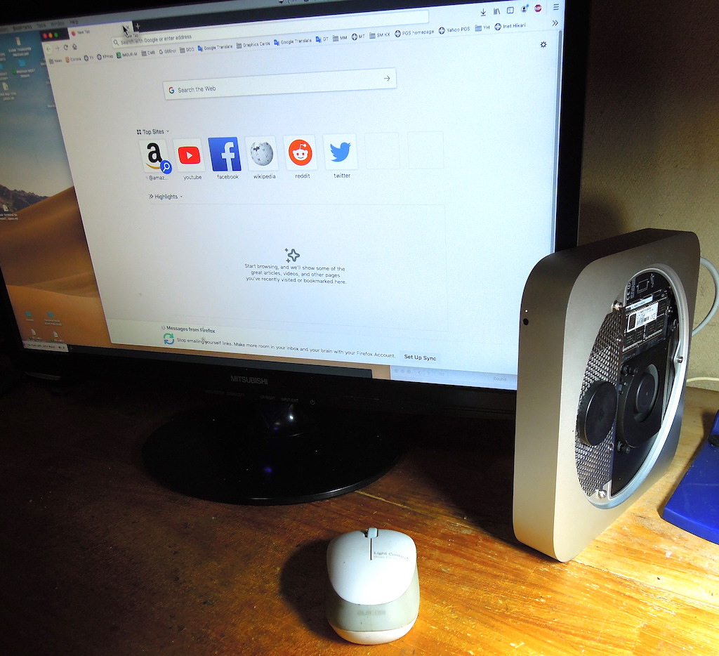

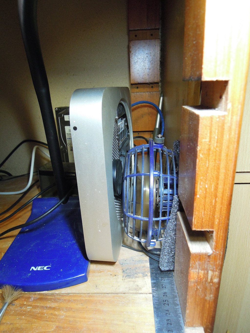

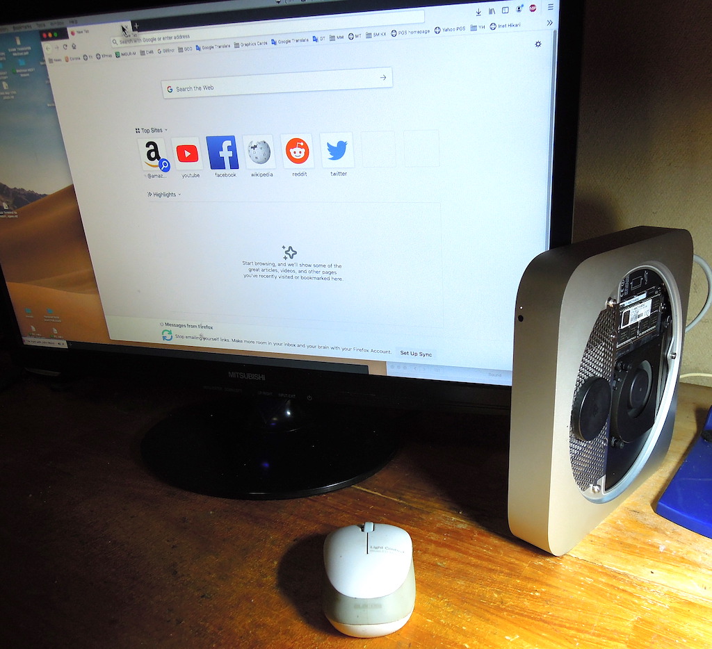

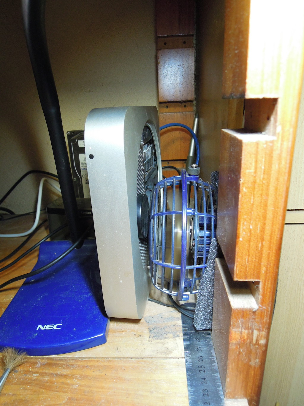

I have a late 2012 Core i5 Mac Mini. 16 gb RAM. internal 480gb sandisk Ultra 3D SSD running Mojave 10.14.6 This M.M. uses the aluminum chassis along with the internal fan for cooling.
have look here. Post #12
This was my first cooling solution.
I live in hot, humid Japan. Now that Japan's summer is approaching I have a cheap PC shop external USB fan aimed at the bottom of the Mac Mini - works extremely well.
Once a month I blow our internal dust with canned air.
