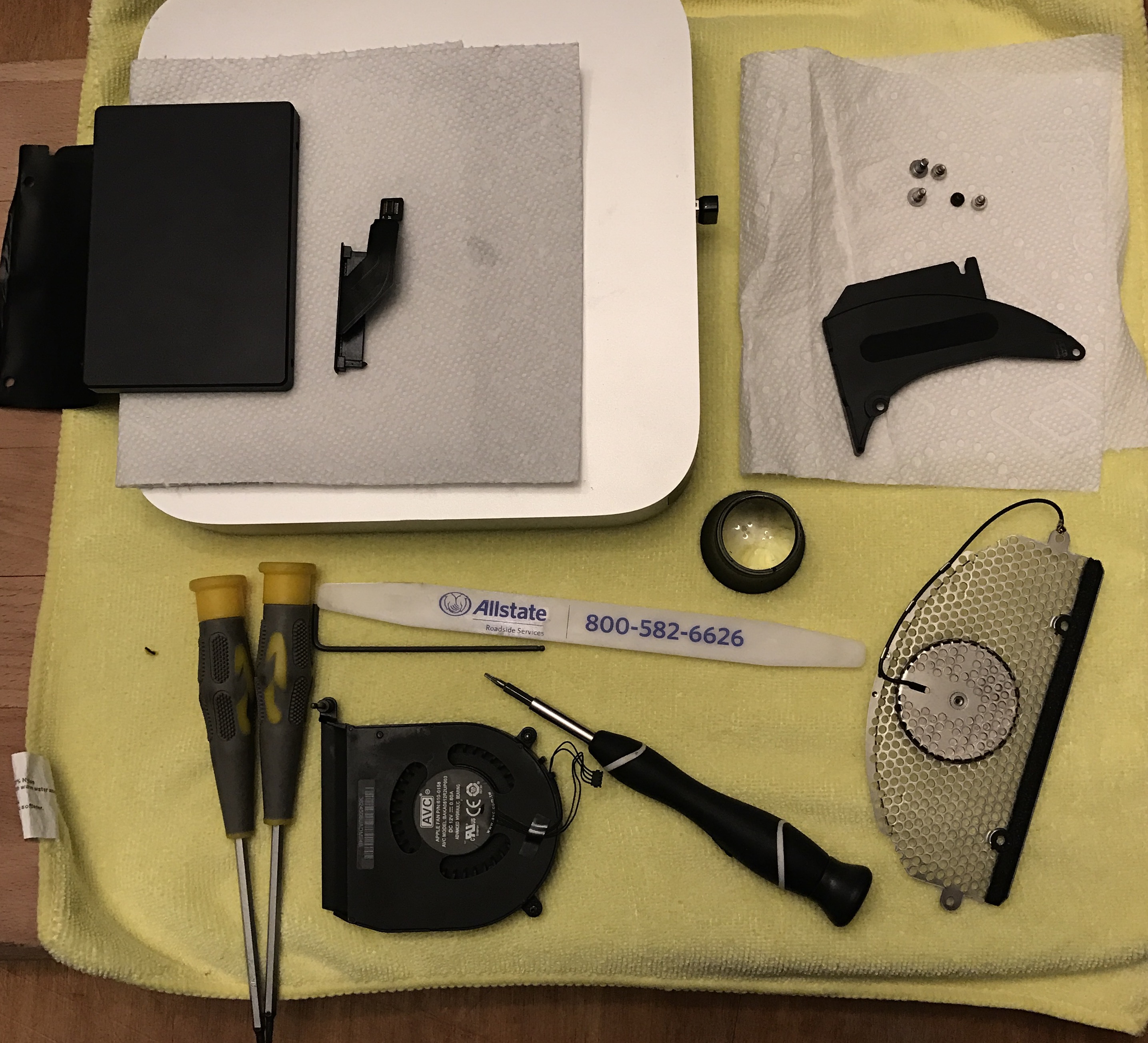

Again, keeping it level, uninstalledn the fan, grill, and subsequently discovering dampness on the hardrive, removed that as well.

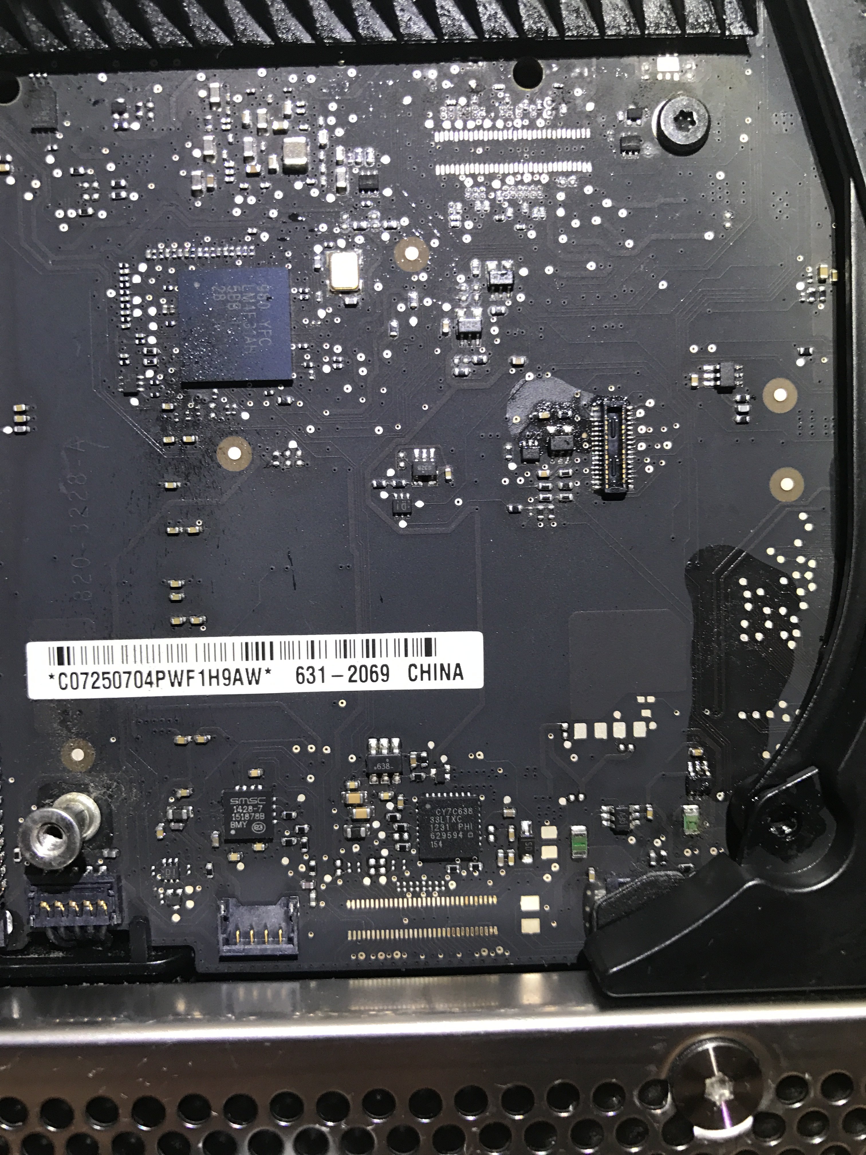

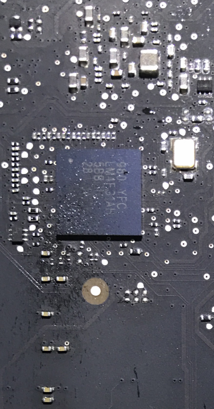

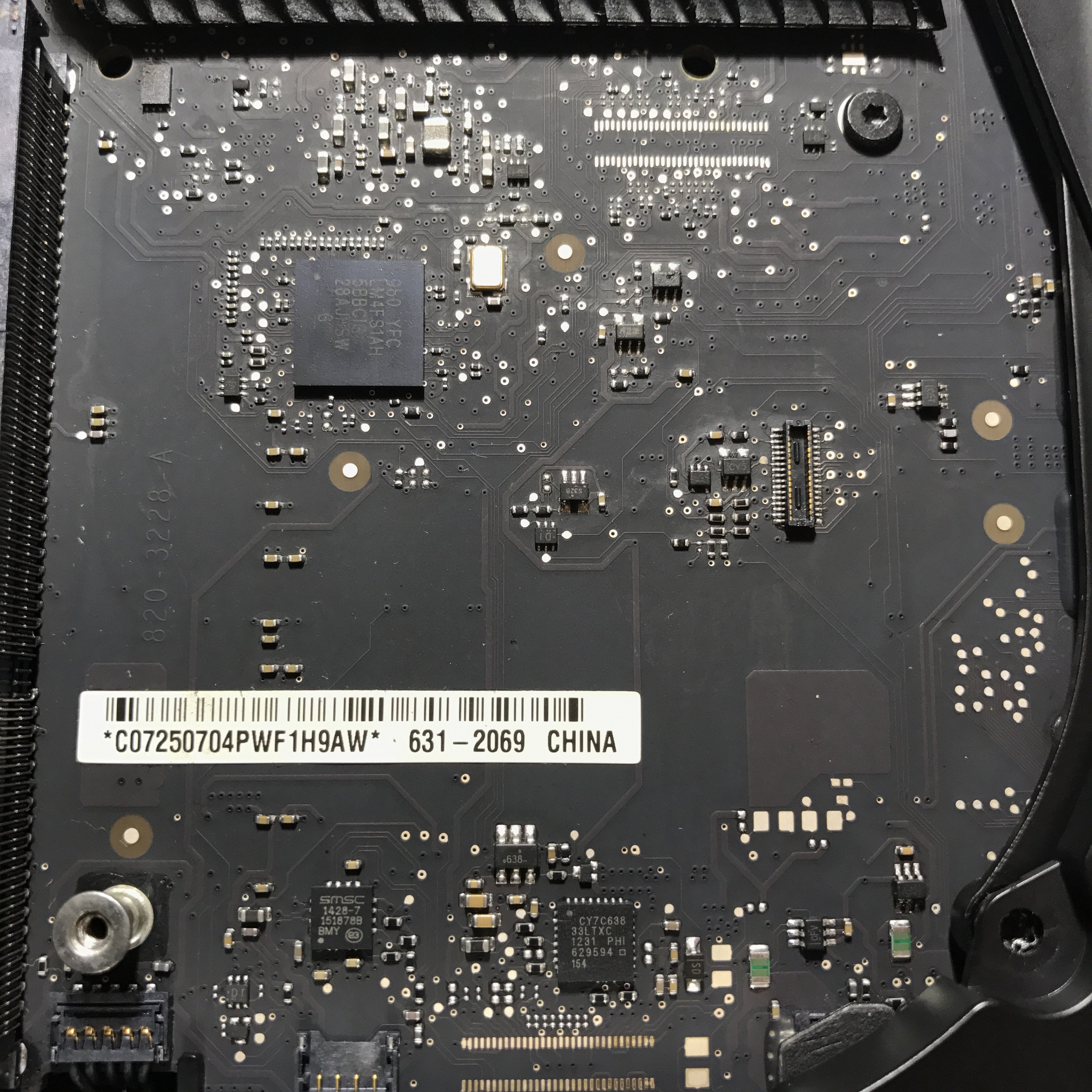

Pix included show motherboard directly under cooling fan where it appears liquid was flung across some of the components.

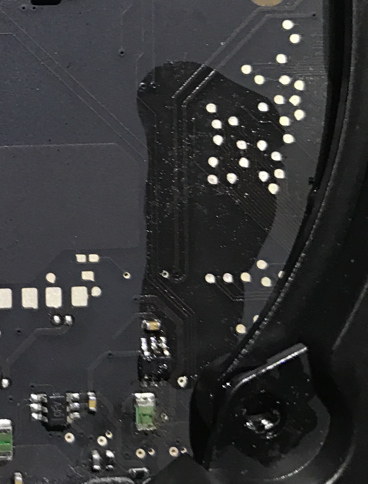

Also anothe detail spot that looks leakproof and sticky.

Doused the fan and SATA connector with isopropyl and dried with light blasts of air.

My biggest concern is trying to clean (or even if I should) the 2 areas of the MB.
Was thinking of a new tooth or other small detail brush, and isopropyl, but not sure that would sufficiently clean dried sugary apple juice residue.

For the system board (and any other circuit boards - such as the bottom of the spinning disk) - I'd use q-tips rather than a brush. You're just trying to get that sticky juice off. For the fan, maybe spray it with some windex / all purpose cleaner - use a can of compressed air to get it to circulate and dry out.

Did have a can of electrical contact cleaner in my hand at Home Depot today, but put it back since it dissipates so quickly and I need to agitate the surface where the sticky is, thinking a small artist paint brush would be gentle enough not to damage anything.
Agree Q-tips would work well on the smooth chip surface and flat circuit board area, but would think the fibers would get pulled on the soldered areas/prongs...

Sounds like you have a good plan. And yes cotton fibers on q-tips would tend to get stuck on any raised or pointed tips like solder points.
Small artist's brush, Q-tips, isopropyl and patience.

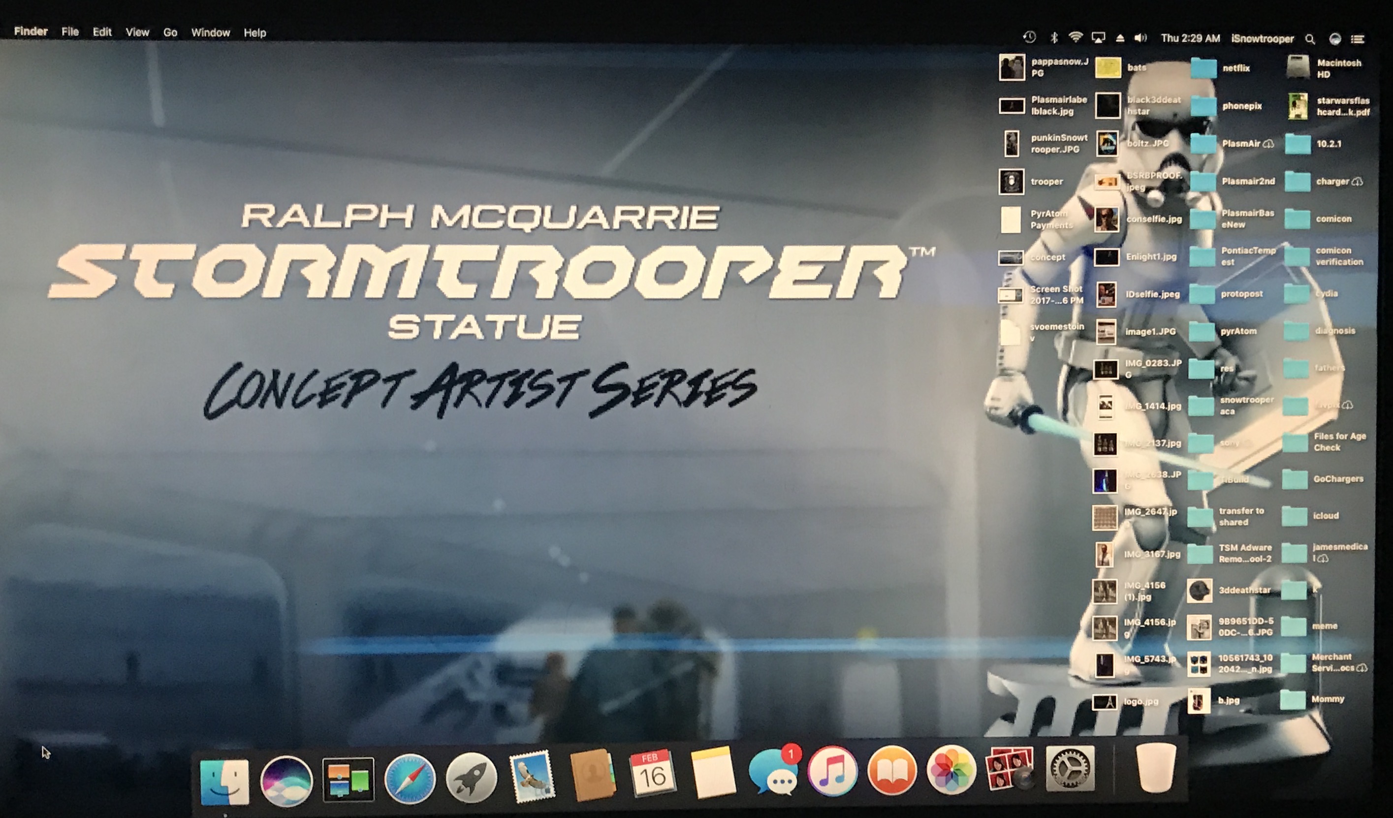

Cleaned up nicely.
Reassembled, fingers crossed.
Booted right up, back to same page as when I yanked the power.
Incredible after taking a bath in Apple (yes, the irony is not lost on me) juice....
