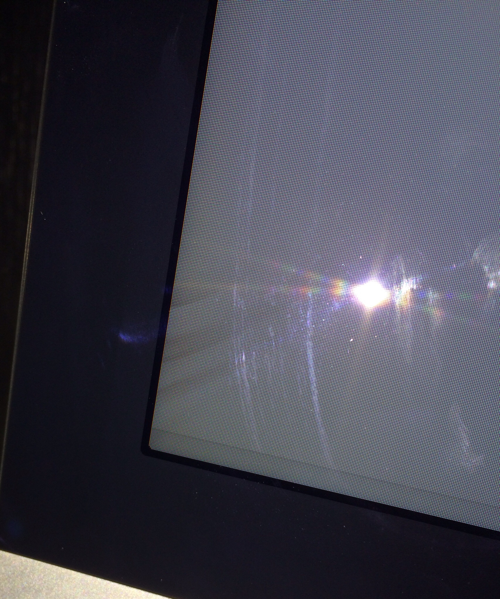

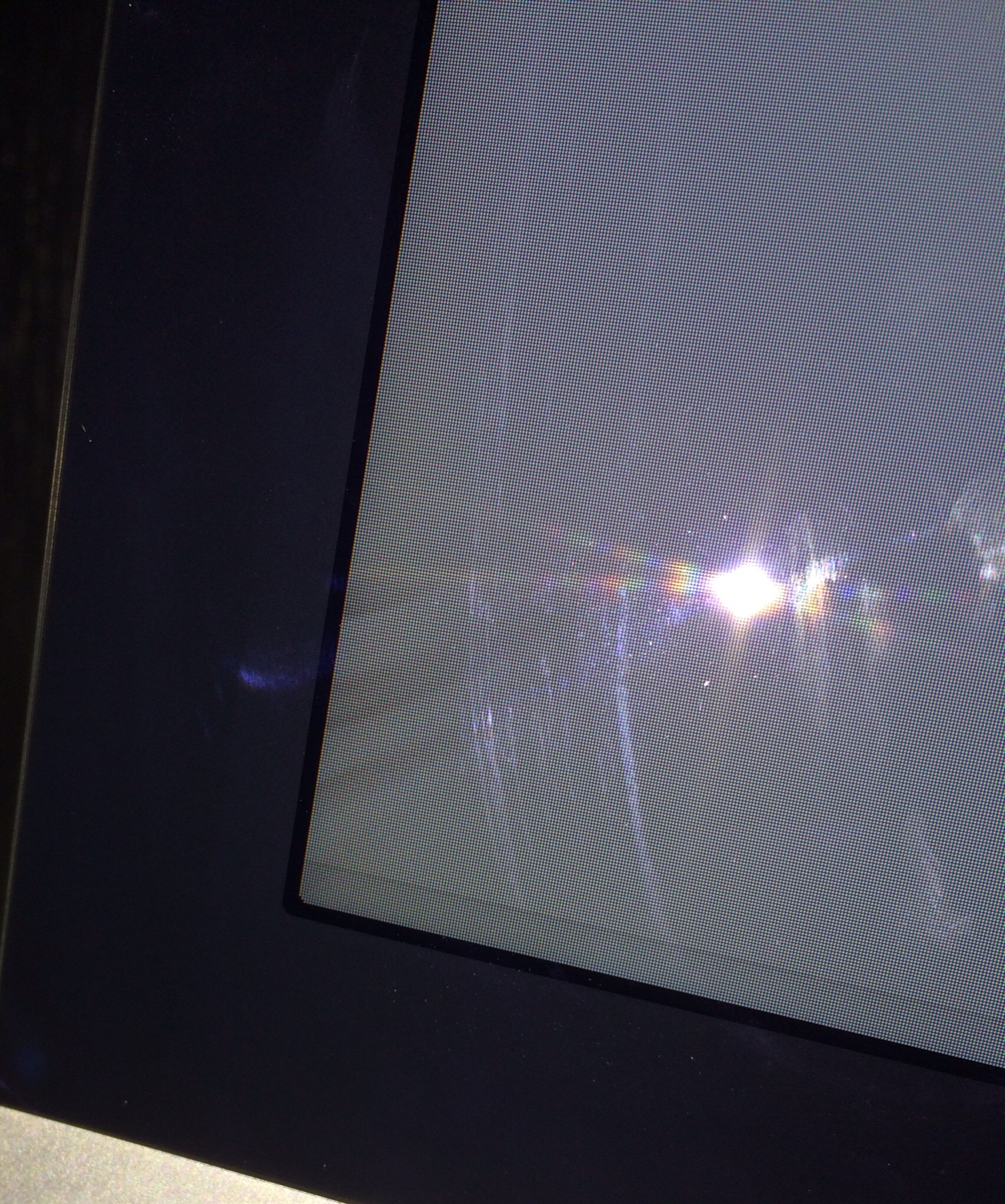

My late 2012 imac which is only a bit more than a year old has dust on the lower left and lower right corners. Its been there for a few months now and looks to be slowly getting worse. I thought that the slim imacs have the glass and the lcd panel laminated together so there isnt any gap between them, so how is this dust showing at all? It also seems to me that it has something to do with the fans and air flow since the dust has a pattern as you can see on the picture.
Not sure what to do. One of the reasons of getting the slimmed imac was that i thought the dust issue was solved. I cant seem to find any other threads about this issue specifically for the slimmed imac (maybe people havnt started noticing yet or is it just me?).

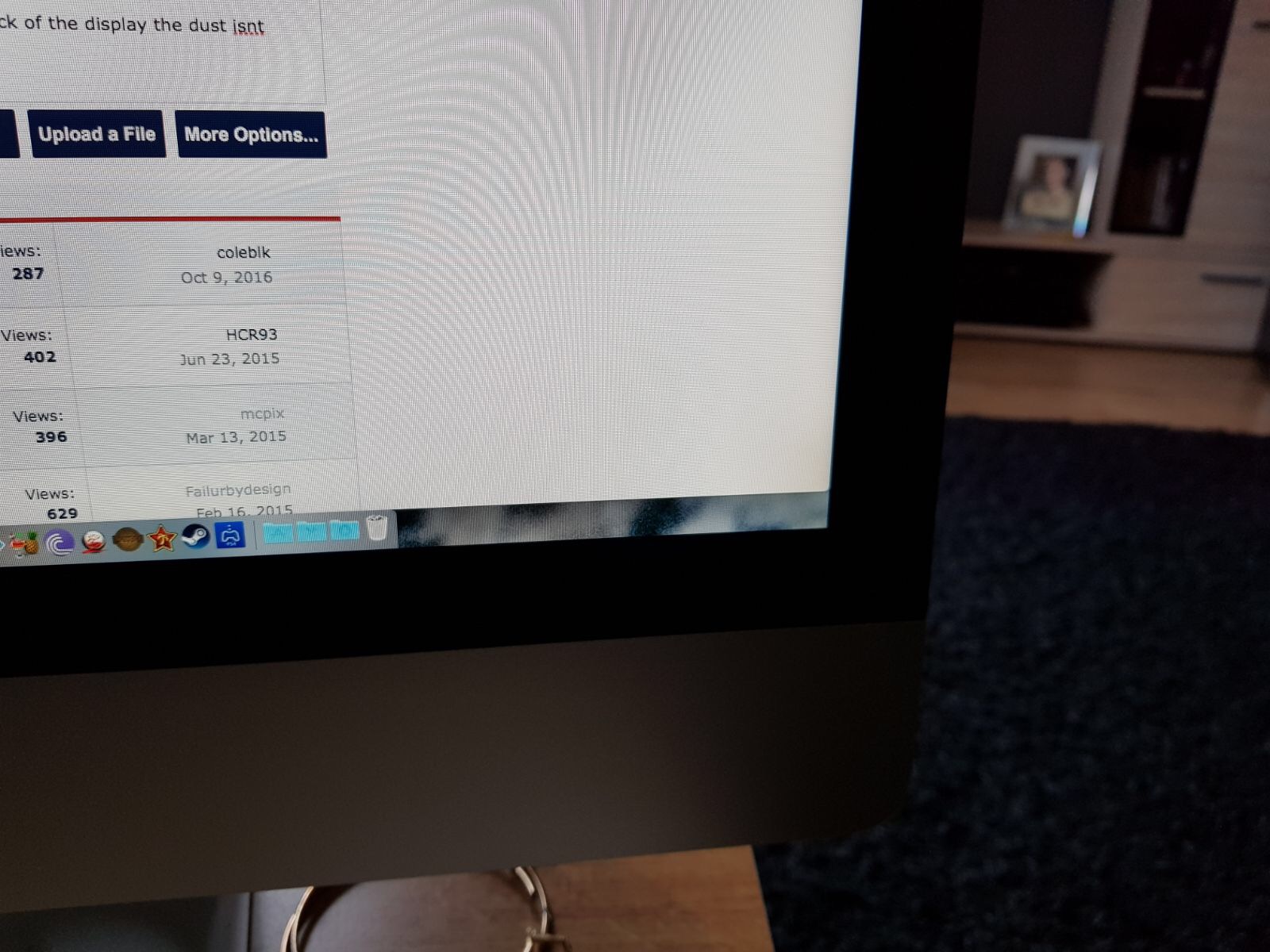

Here's another pic with flash on. Its hard to get a good photo of. Its most visible on white backgrounds and high brightness. Also this is a 21.5"
My impression as well. Possible you have a rare unit with gaps in the corners, or the laminated parts separating. If you don't have extended ApplCare, take it to an authorized 3rd party shop and ask what they can do. Sometimes Apple will fix things under a program they don't advertise (speaking from experience - once they replaced an entire 27 panel for me when I took the unit in for the HD replacement program - I joked about seeing what they could do about the dusty panel, not expecting anything and the next day the shop called and told me Apple was replacing it free - it was 2 years out of warranty) Apple stores normally don't abuse it. A 3rd party shop is interested in your repair business, so.. give it a shot.
Seriously? 🙁 This is a HUGE disappointment just to see a single case of this.

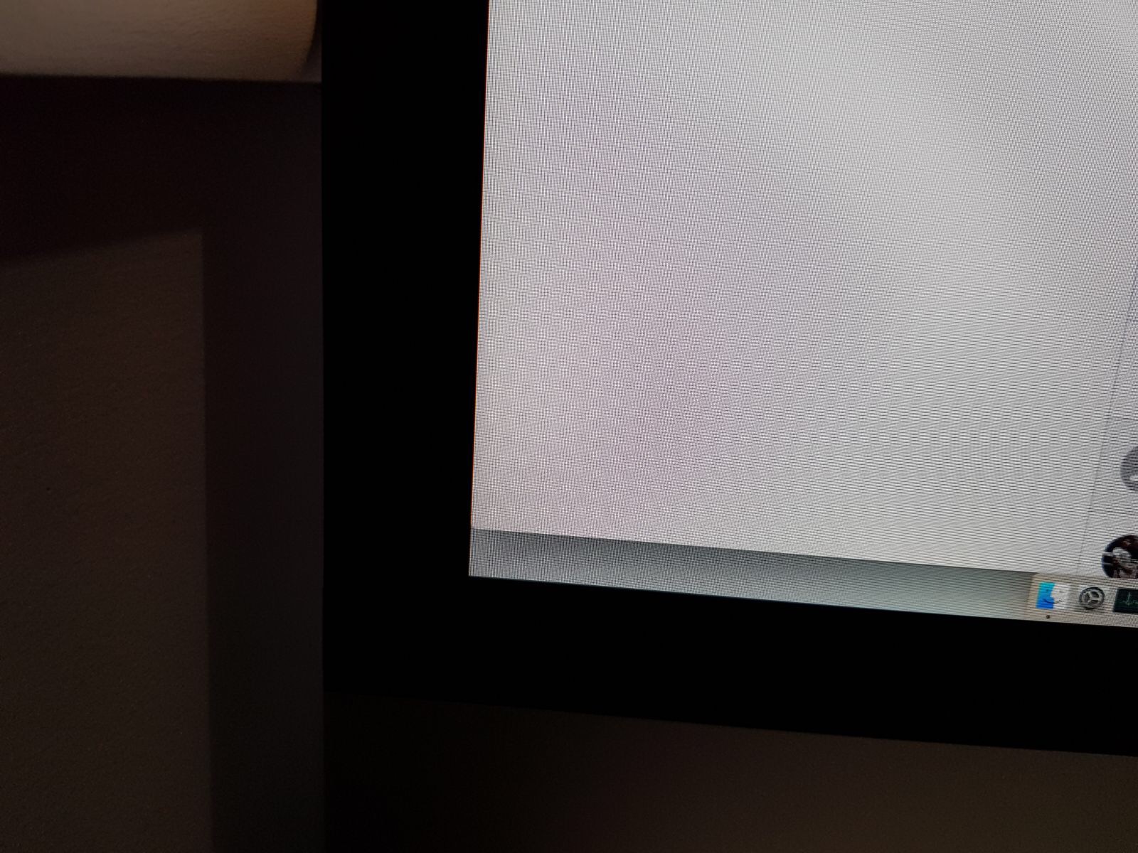

I've recently discovered some very disappointing smudge marks that are definitely below the glass on the lower right side of the panel on my 6 month old Late 2013 iMac.
I'm going to be sending it back to Apple for a replacement panel. 🙁

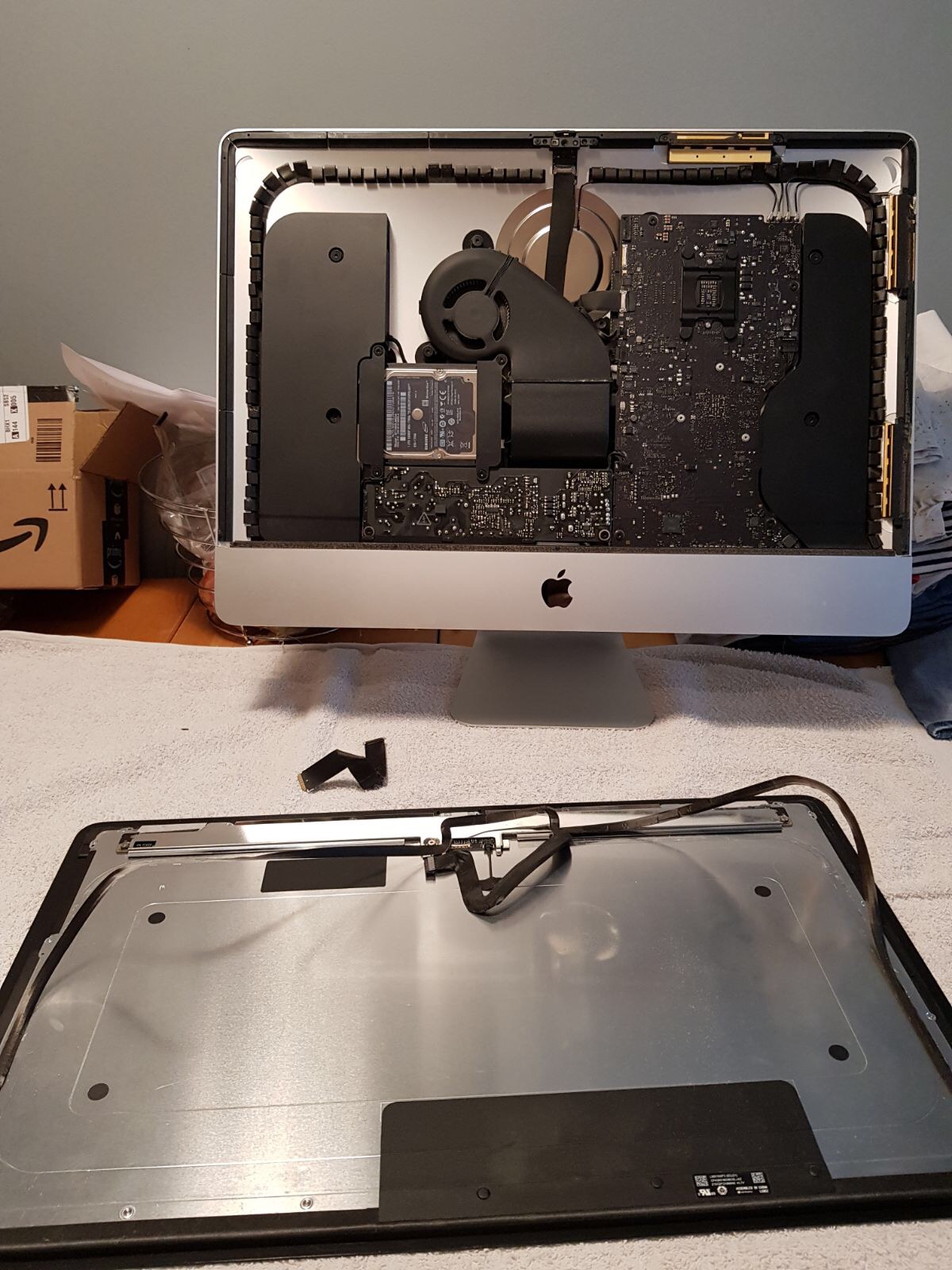

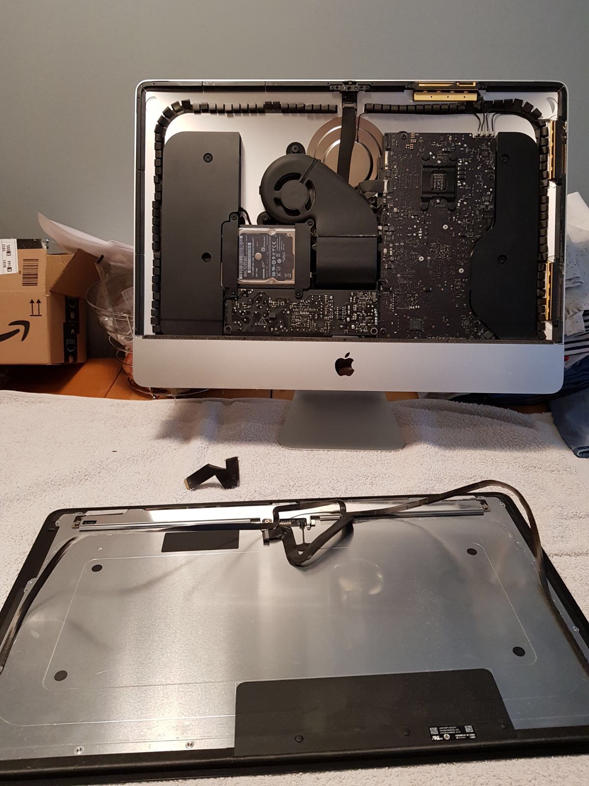

i had the same problem with my 2012 imac and can confirm it is dust between the lcd and backlight i took mine apart today after watching a few youtube tutorials its a fairly easy job if you take your time the new tape to put screen back on is fairly cheap off amazon aswell

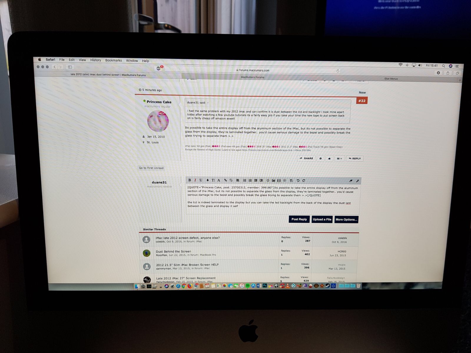

Its possible to take the entire display off from the aluminum section of the iMac, but its not possible to separate the glass from the display, they're laminated together… you'd cause serious damage to the bezel and possibly break the glass trying to separate them >.>

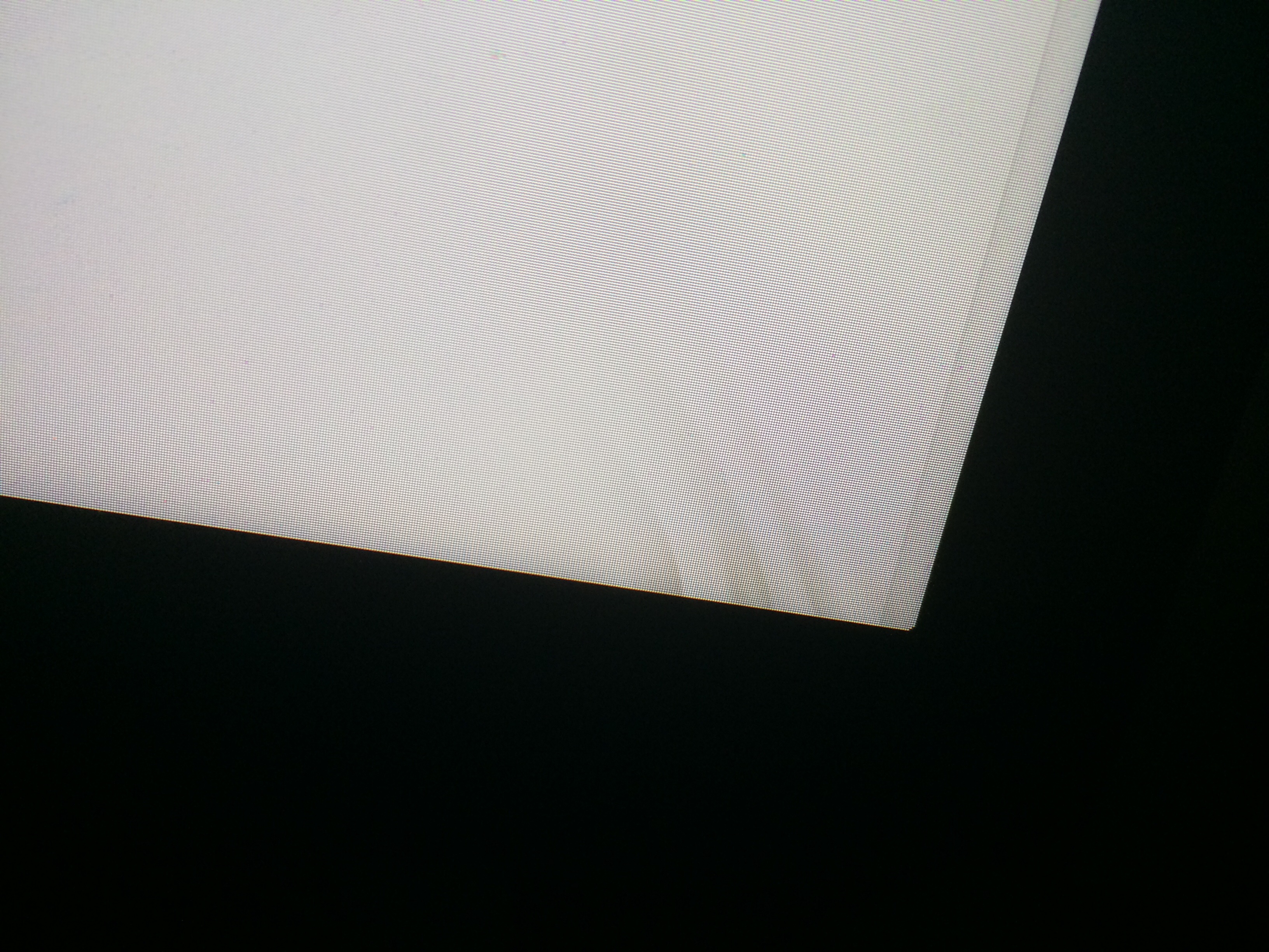

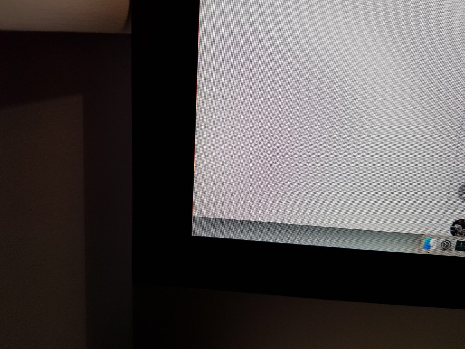

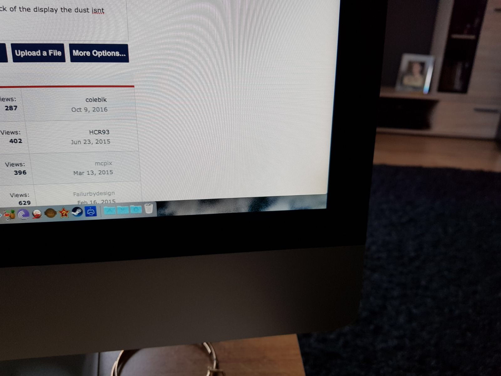

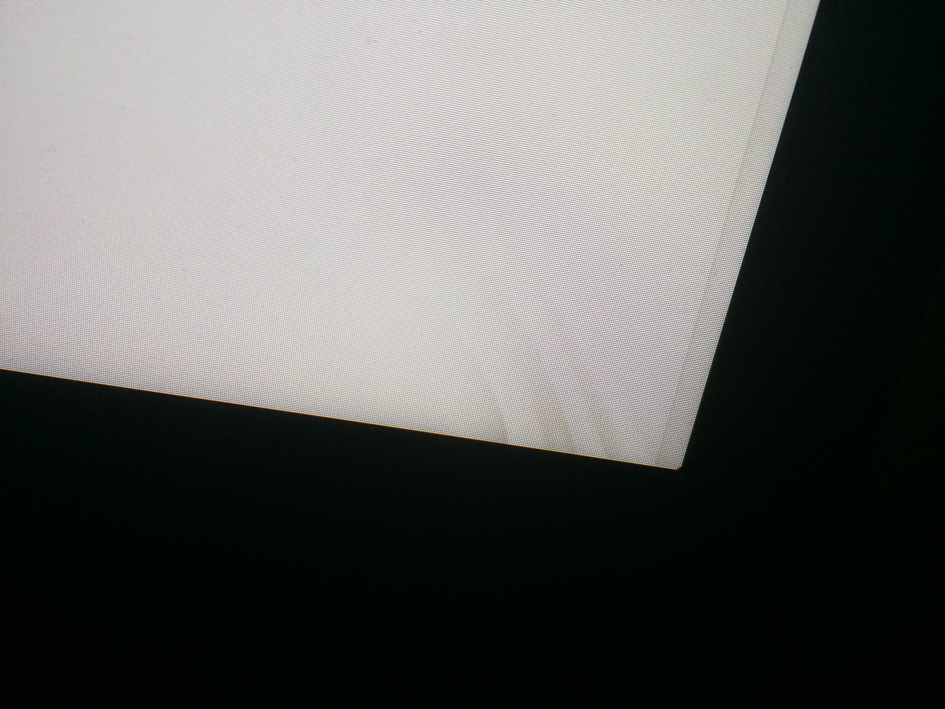

the lcd is indeed laminated to the glass but you can take the led backlight from the back of the display the dust isnt between the glass and display it self as you can see from the pics there is no smudges or dust ;-)

Are you saying it is possible to repair (clean the dust) the 5K 27" iMac (2015)? If yes, I am very interested to hear about it, and how exactly it is done.
i cant say for sure with yours as mine is a 2012 model but would say the process is the same, if you take your time the screen is actually pretty easy to get off no heat gun is needed
