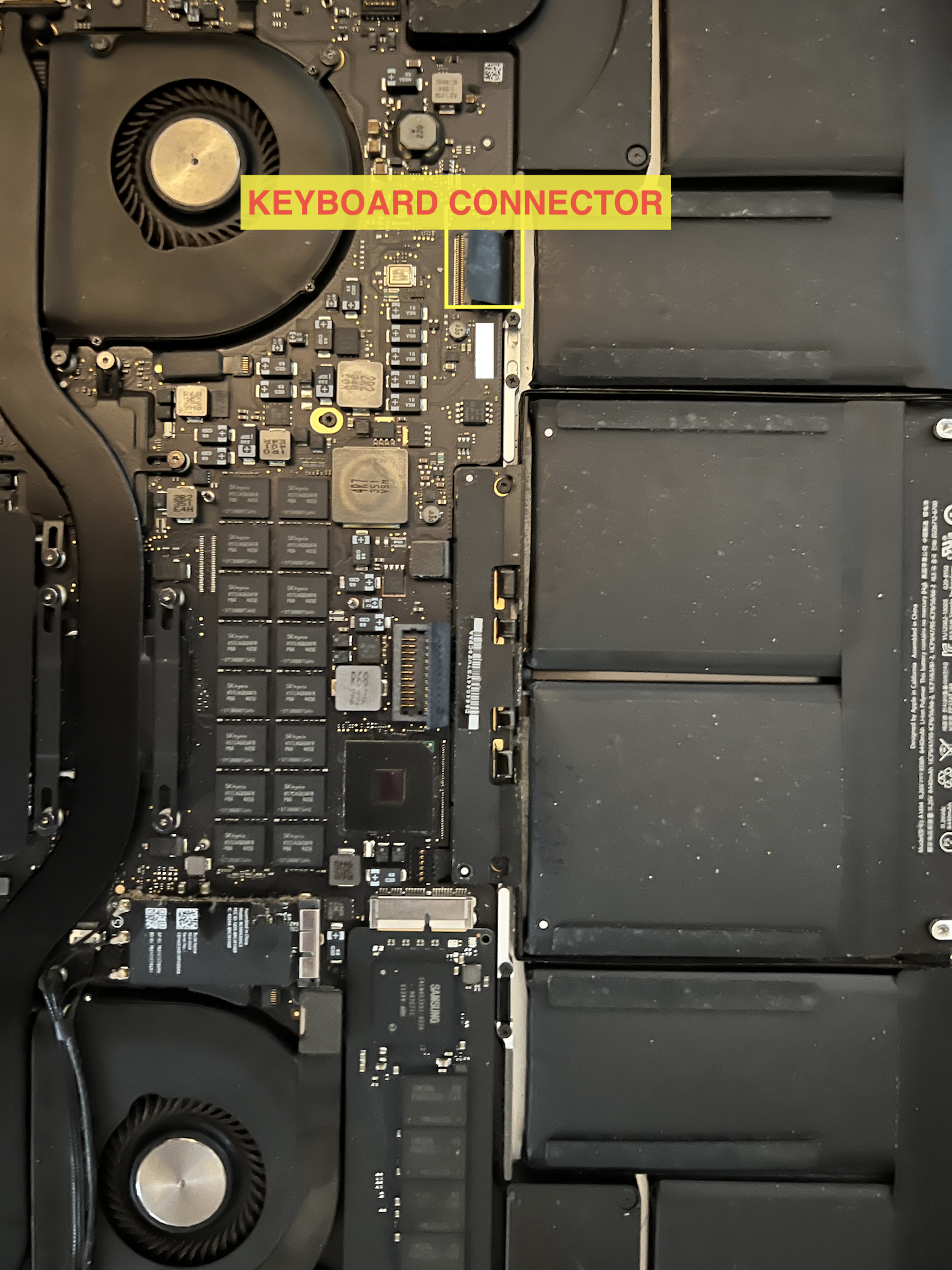

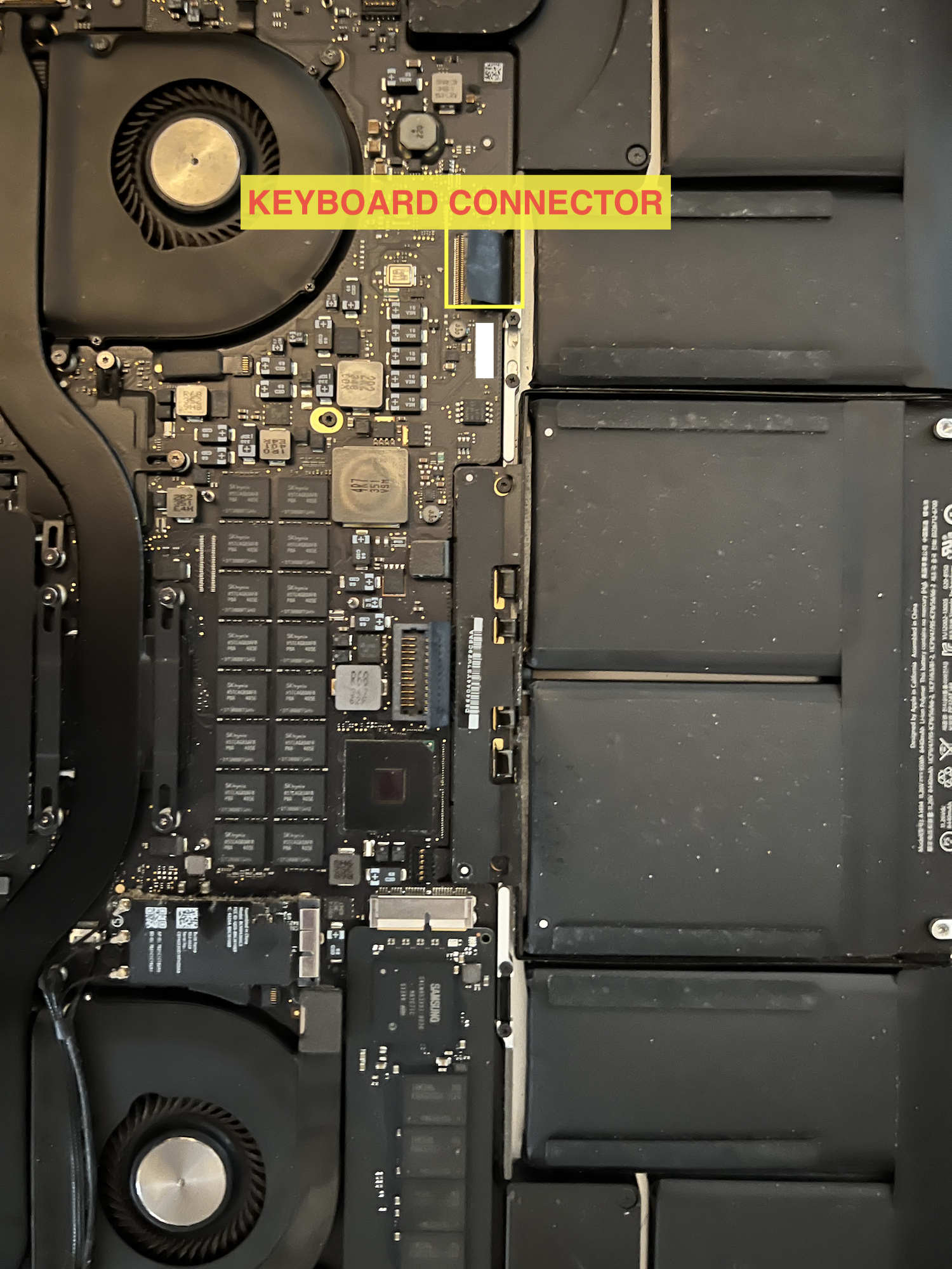

Attached are 2 pictures of my late 2013 rMBP: I highlighted the keyboard connector that is unplugged (please confirm)

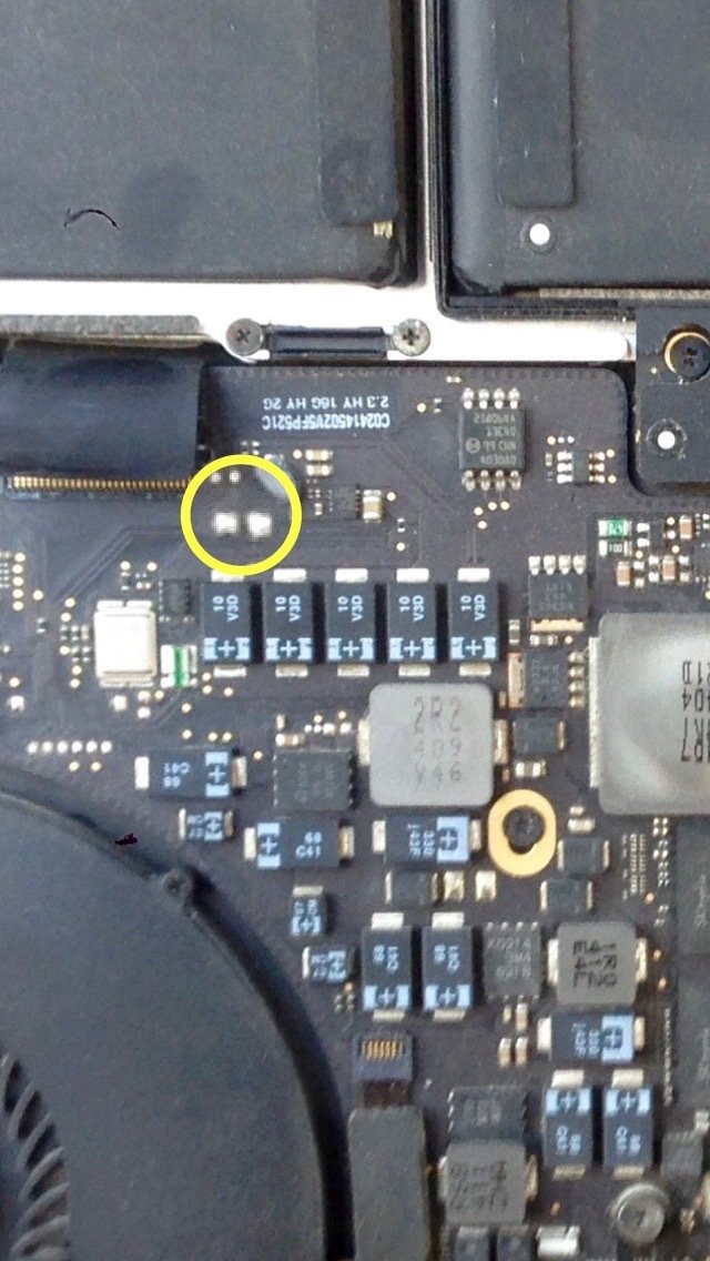

The second picture is the portion of the back -- can you confirm which are the power pads?
Thanks again.

the one closest to the keyboard ribbon, or just try both.
now gently place the small screwdriver on the 2 points until you hear the chime.
this might be a few seconds
the logic board is covered with a film that prevents shortage, but still be careful not to tap anything else.
keep the batter attached, but the MBP unplugged!

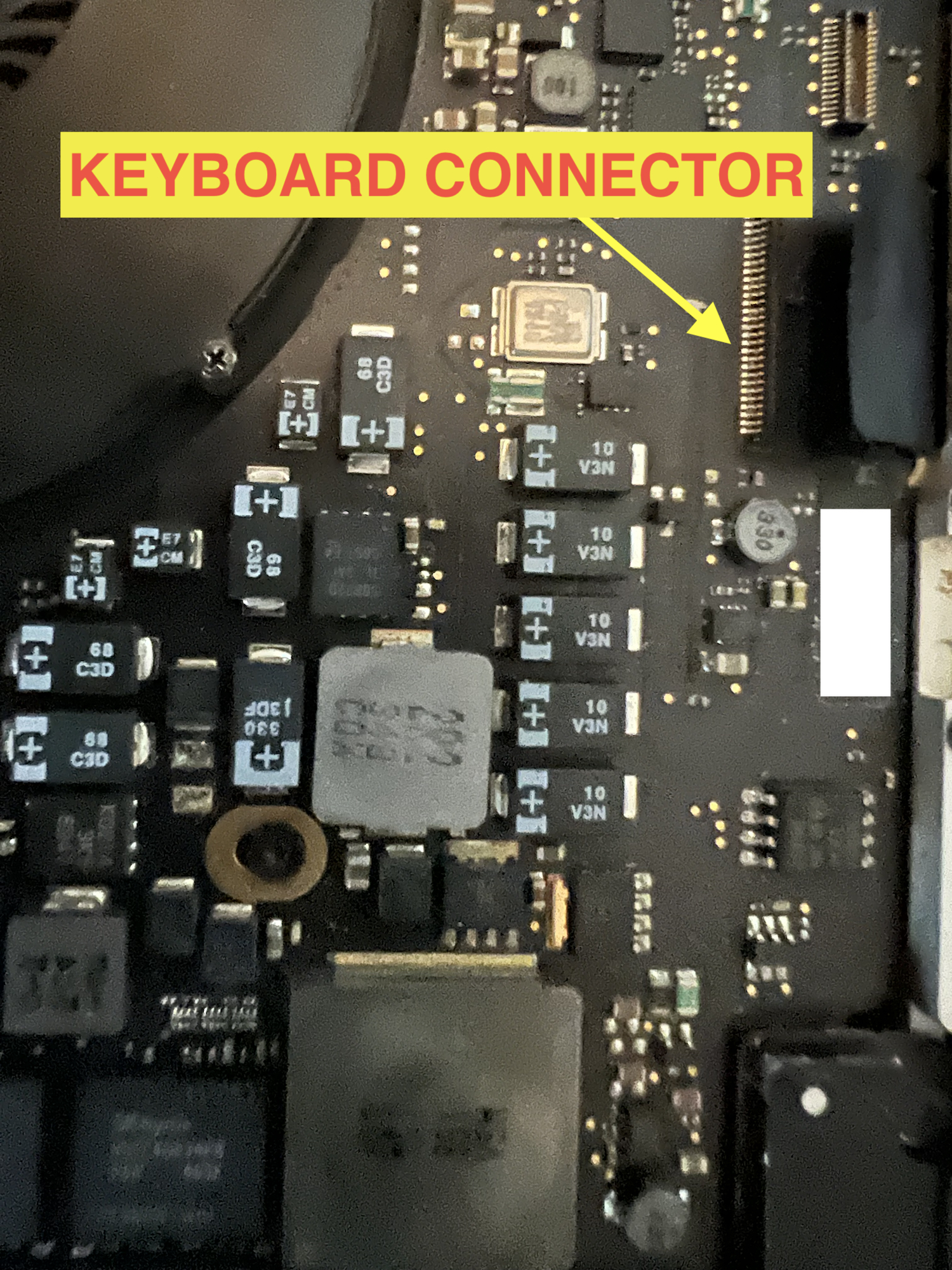

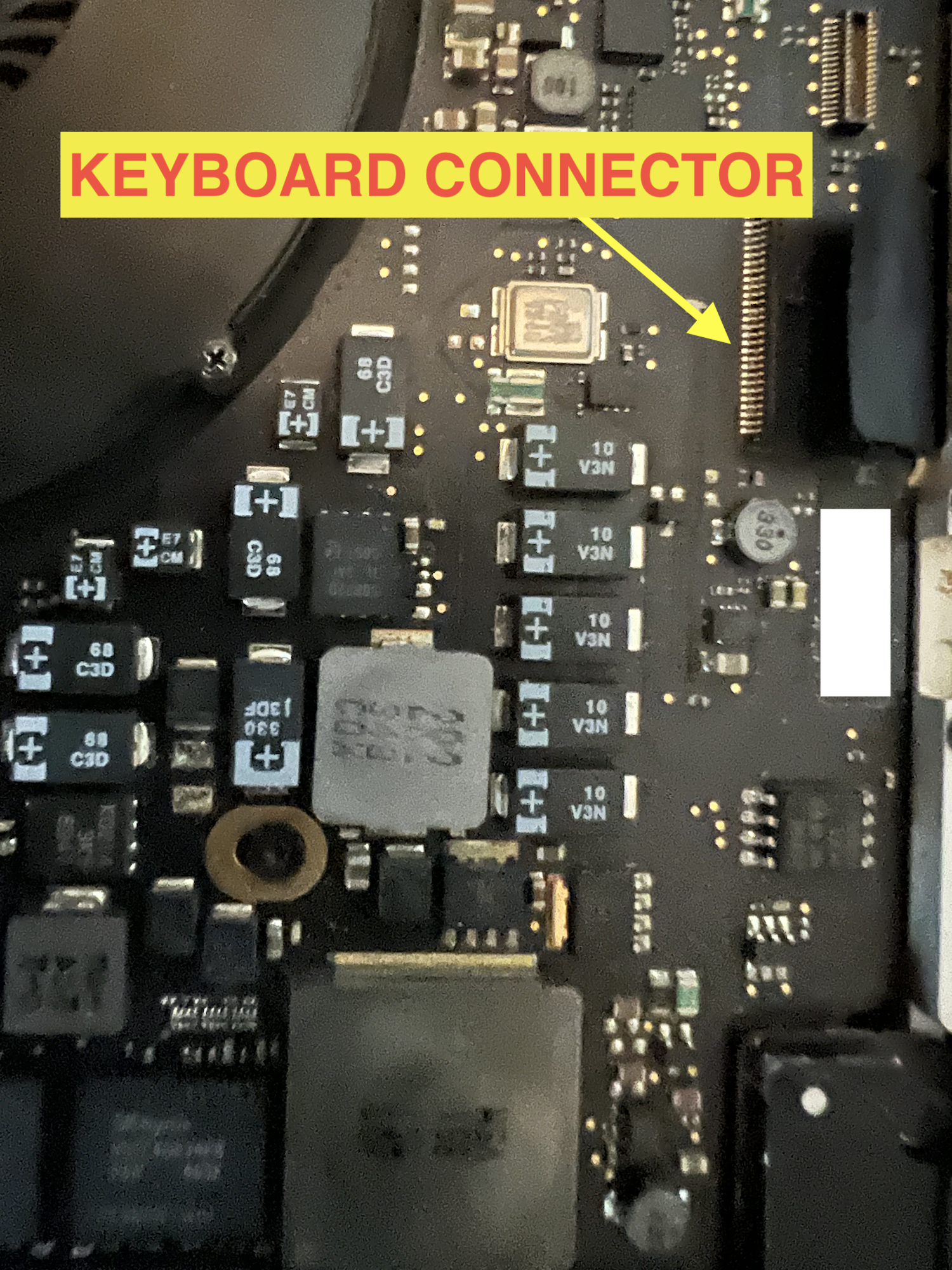

Thanks again.
this will work
keep the battery ribbon connector plugged in, or this wont work (physic 101)
tap any 2 points near the keyboard ribbon connector for several seconds,
those 2 on the top, left of that round circuit would be my first try.
and wait for the chime,
