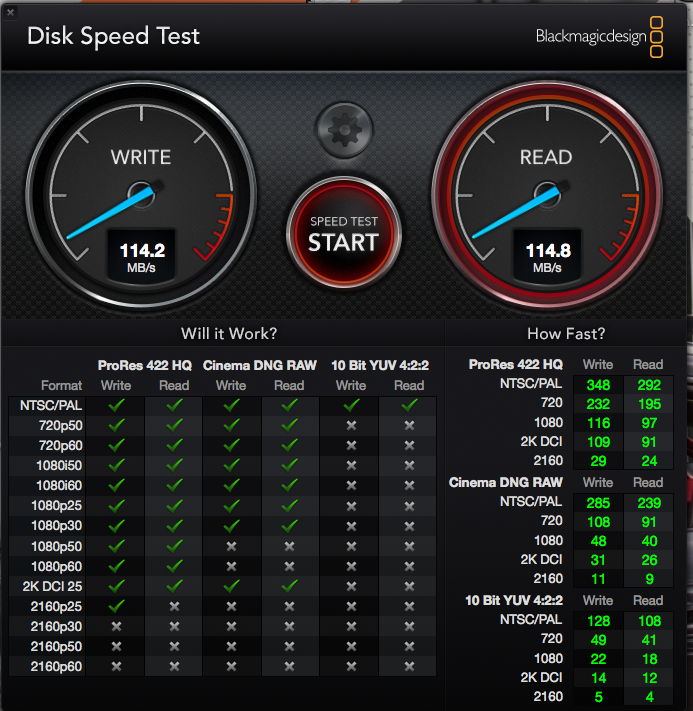

This is before the SSD

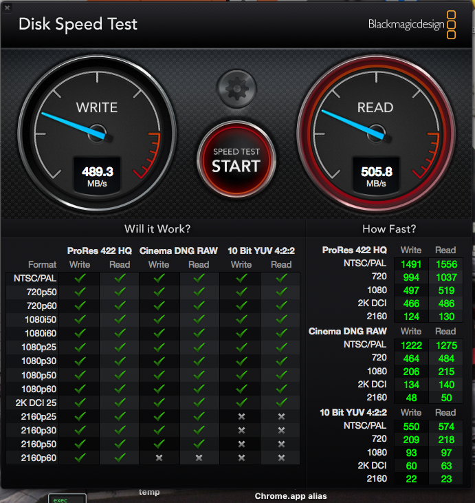

This is with the SSD
The difference is definitely noticeable.

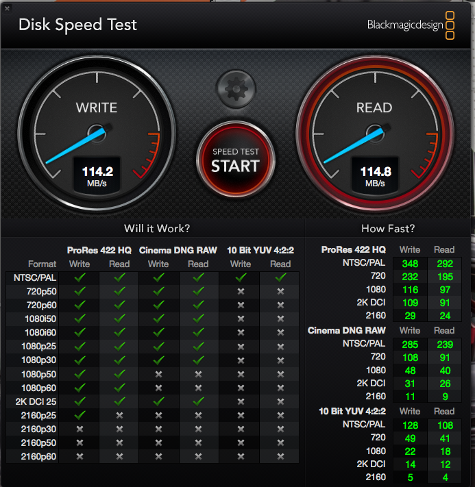

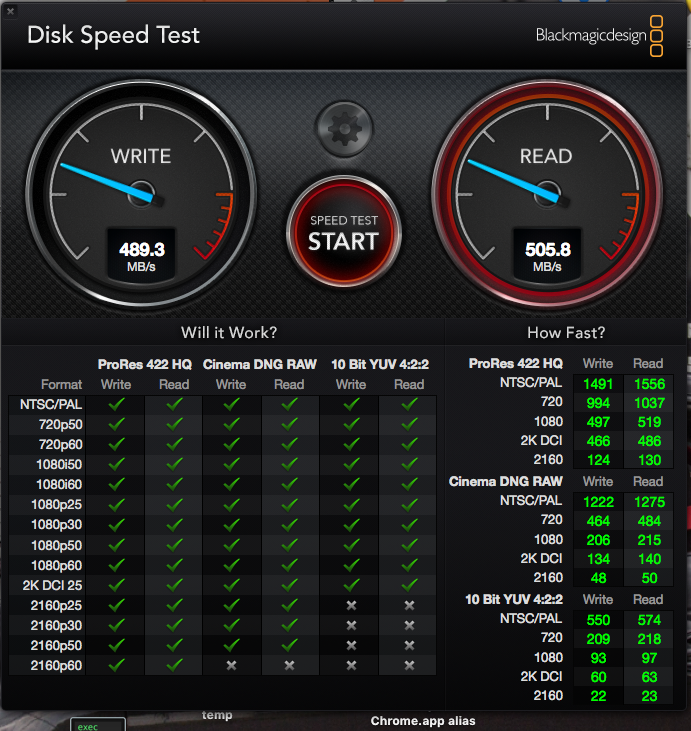

That's the difference between HDD and SSD.
