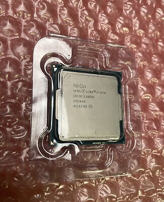

Here in Ho Chi Minh City, I bought
Xeon E3-1246 V3 = 25$~30$
Core i7-4790 = 35$~40$
I'm surely don't want to spend 30$ just to save 10$, under the high risk that a Xeon is not compatible.
Just go buy the core i7 from the begining. Save myself the headache.

Out of China, (I'm living in Vietnam, though), like in the US, you might obtain them even cheaper. Like from the dumpster or from the Salvage Army stores.
Or ebay....

In the ebay link above, the seller offer free shipping... Australia is not a far far away country I suppose. Unless you insist on buying your parts locally.
Regarding the 8 core and 10 cores Xeon, I already said in my previous post.
8/10 cores Xeon => LGA 2011 will not fit to the LGA 1150 socket on the logic board of iMac 2013 you own. Go read something about it from Intel web page then keep dreaming....
