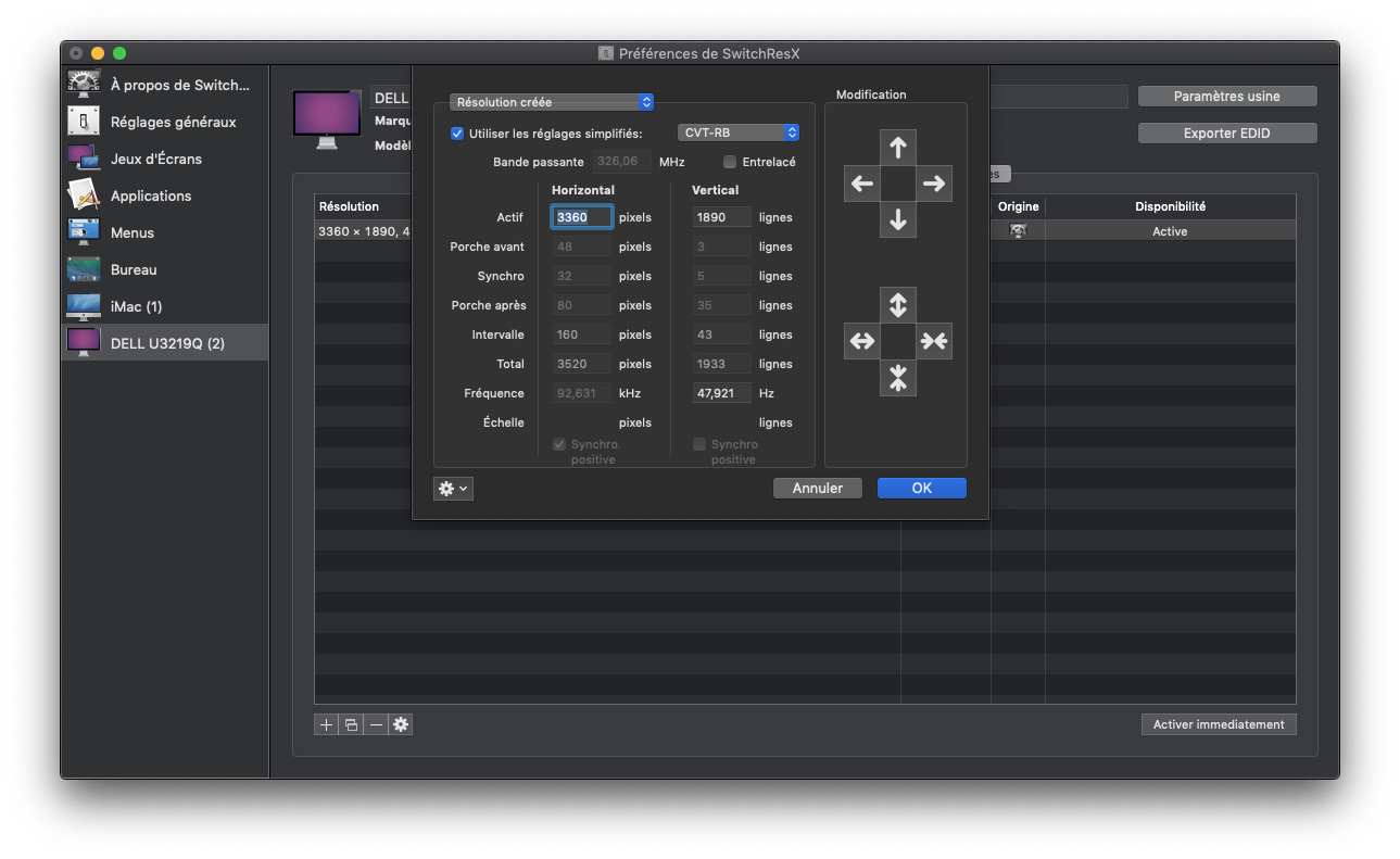

Hello
with my setup I've just reach this resolution @ 48Hz :
iMac 27 late 2013 - Nvidia 780M - Thunderbolt to hdmi 2 adapter from 3dclub (CAC 1170) - HDMI 2 cable (same brand) - Dell U3219Q monitor (HDMI input)
Using SwitchResX settings :
I don't think I can go beyond ... so that's not 4k@60Hz but that's ok for me
