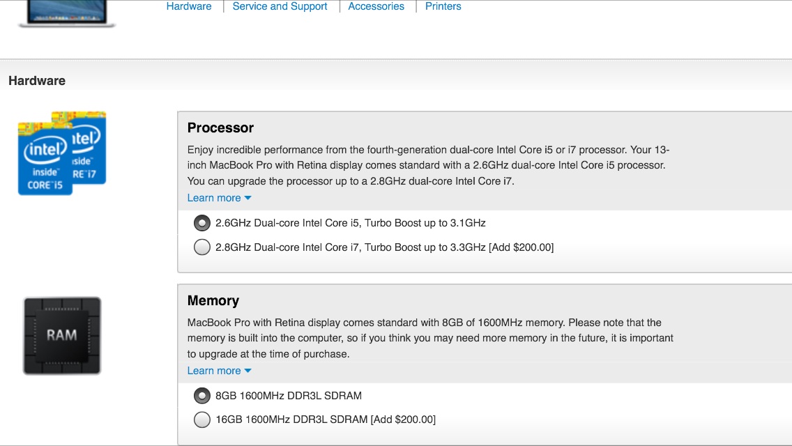

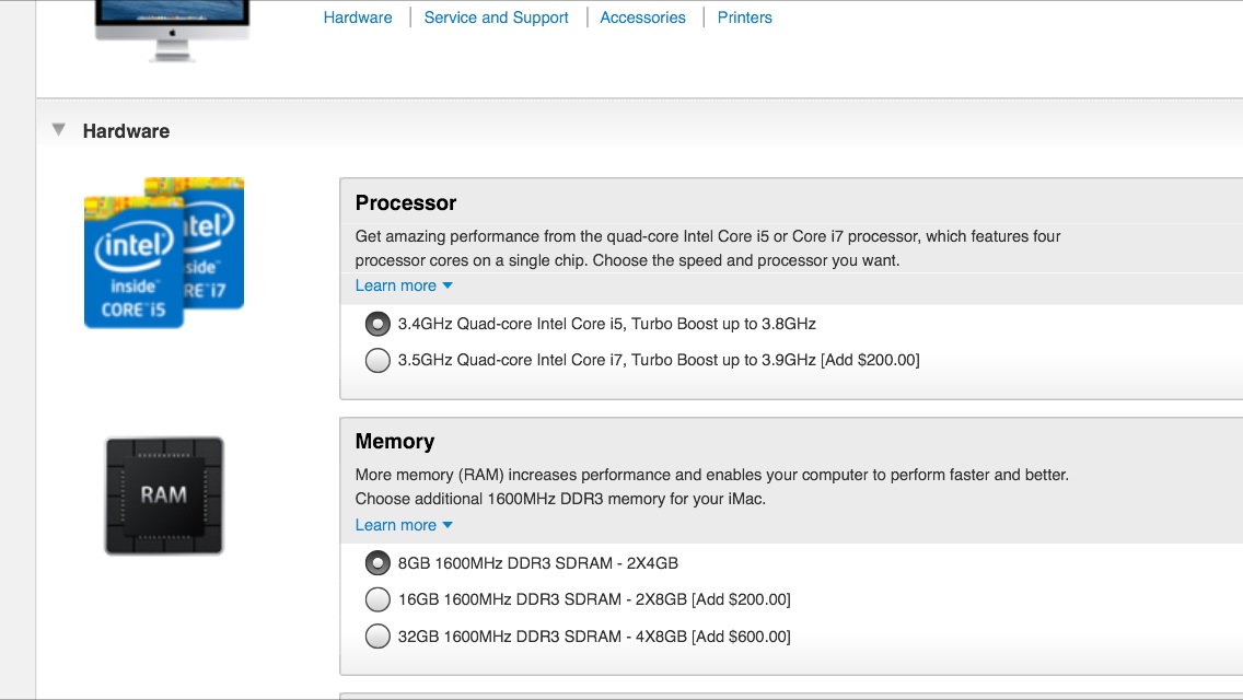

Well, there's your problem. You're using DDR3L, which you're not supposed to use. The DDR3L is only meant for rMBPs and MBAs.
The iMac uses the standard DDR3 1600MHz RAM.

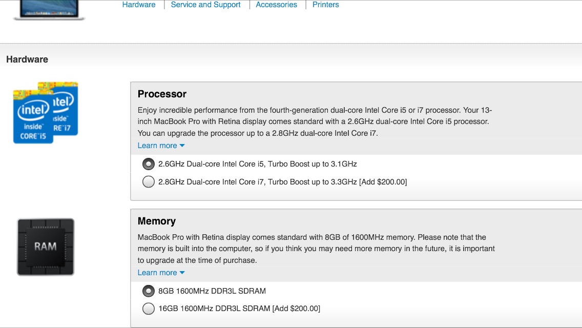

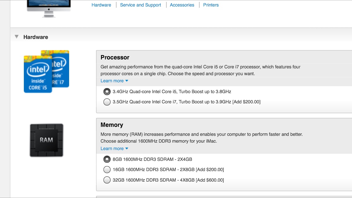

Mine shipped with DDR3 (not DDR3L), I checked in System Info. Meanwhile my RMBP clearly stated DDR3L.
And also if you check Apple's site and customize the iMac and RMBPs, you can clearly see that in the RAM area of customizing, it's DDR3 for iMac and DDR3L for the RMBP.
And if you look at the attachment in my previous and current posts, you can see tha the iMac is DDR3 and the RMBP is DDR3L.
If it's DDR3, it's 1.5V.
If it's DDR3L, it's 1.35V.
