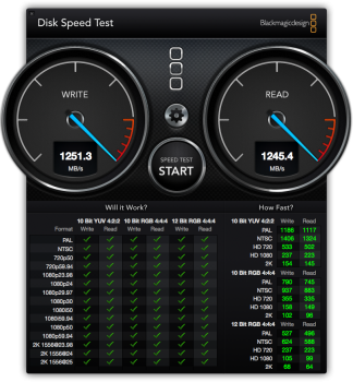

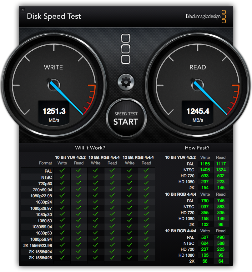

So my wife was using a late 2013 rMBP with a paltry 128GB ssd. I decided that i would upgrade her to an iMac since she rarley takes the laptop out of the house ever since finishing college. I personally own a mid 2015 rMBP 15" with a 256GB ssd. Well fast forward to a lazy Friday night as i was prepping her 13" macbook for sale. I ended up thinking to myself..."I wonder if the pci-e SSD is replaceable?" Lo and behold it is! So then i had the clever idea to pull MY ssd from my 15" rMBP and place it in the 13" in hopes that it would work, why wouldnt it right?
So long story short, it works, and its quite a bit faster than it was. The 128gb ssd was running at x2 link speed where the 256gb ssd from the 15" rMBP is running at x4 link speed which means that i went from a 300-450~ read/write to a whopping 1200-1500~ read/write speed.

Check out the snippet!
The new ones use 4 lane PCIe and the old ones use 2 lane PCIe, this is the reason for the speed increase, simple as that.
Well when i comes to laptops (macs mostly) im not too keen on what Apple does to their boards but i was always under the impression that the pcie bus was running at x2 speeds (at the connector) not the pcie device connecting to it much like sata is. So when i saw that it was running at x4 speeds i was quite impressed with the difference. Thanks!
Completley worth it considering the speeds. This thing feels like new again (maybe cause i wiped it clean too....) 10/10, would do again.
