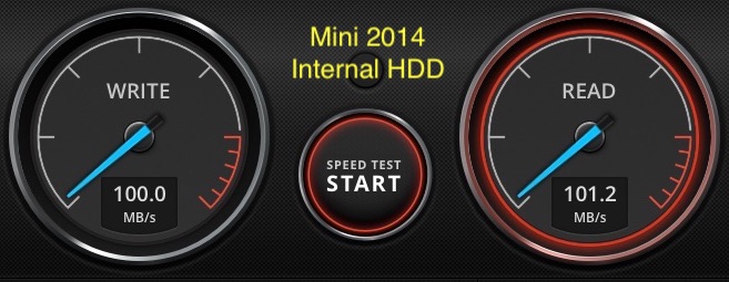

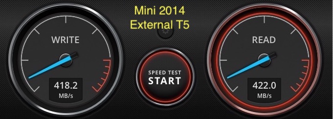

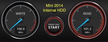

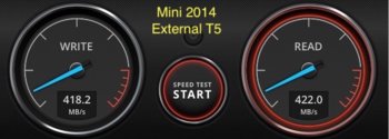

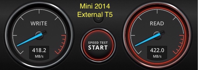

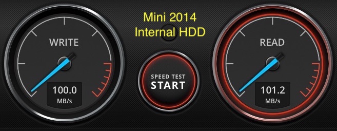

There are three basic ways to speed up a Late 2014 Mini — they all involve an SSD.
1- Add an external SSD like the Samsung T5. This gets you quite a bit of performance improvement with no “brain surgery”.
2 - Swap out your HDD for an SATA SSD. This gets you roughly the same performance improvement as an external SSD and keeps the data inside your Mini. BUT… it requires the most “brain surgery” to install the SSD. And you lose your HDD space unless you put it in an external case.
3 - Add an internal NVMe SSD. This provides the maximum performance improvement, keeps your current HDD for 'whatever' and requires only minimal “brain surgery”. Note: adding an NVMe SSD requires an adapter unless you have a fusion drive.
FWIW I took the easy way and added a T5.
The external USB SSD is certainly the easiest and also offers decent performance. I boot my 2012 quad-core Mini Server from a 1TB Samsung T3 and use it pretty heavily with Final Cut Pro and Logic Pro with no problems. The external also has the advantage of being easily moved to a different computer in the future. But the 2012 Mini is a little different situation, since it has a slower internal SSD interface so there isn''t a lot of difference with an external.
I get similar performance from my Samsung T3 as getrealbro, but just FYI, this is what I get from the internal NVMe SSD on my 2014 Mini. It has a faster internal SSD interface, so you'll see a more significant difference in speed. Whether you really need this level of performance is hard to say. If you have a base 2014 Mini with only 4gb RAM, it should speed up virtual memory, which might make a noticeable difference.
It's good to see a test that allows a comparison of an external T5 and internal NVMe SSD for a 2014 Mini.
