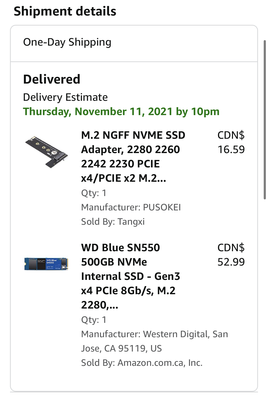

Also, IMO you would have been better off buying an NVMe M.2 SSD and adapter (unless you just want to tinker). The NVMe install takes just 5 minutes, even for a beginner, as there is nothing to disconnect. You can just leave the internal hard drive in place and use it as a Time Machine backup or something.
Since your needs are light, you can go DRAM-less for the SSD. For example, if you're in the US, Best Buy has the SanDisk Ultra 1 TB for US$80. Or the Western Digital SN550 is $84 at Amazon.com. The NVMe adapter is $14.

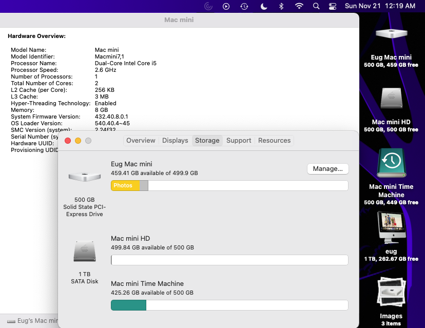

This is my 2014 Mac mini setup, with 2.6 GHz Core i5 and 8 GB RAM:
Monterey runs very well on this system.

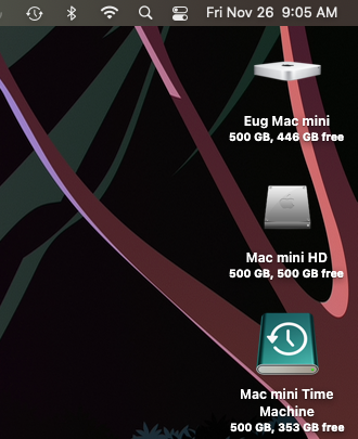

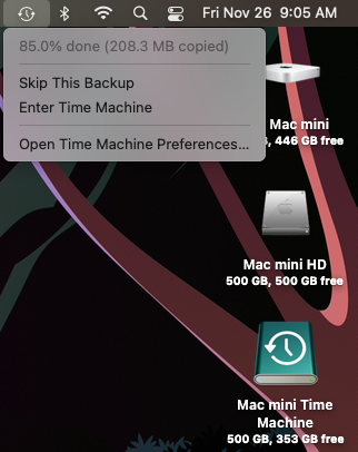

I don’t have a lot of stuff either so I partitioned off 500 GB for Time Machine and left the other 500 GB free. The machine now silently backs itself up several times a day, without any intervention from me, and in total silence. (See below re: noise.)

EugW, thanks for your suggestion. Truly appreciate that. Just finished my order. Got the Samsung 970 EvoPlus for the added DRAM cache. Should I expect my Mac mini to recognize it to initialize it or should I consider getting an enclosure for it? Not sure what is the best way to restore a clone to it.

If it's defective, then yes remove it. However, if it's still working fine then leave it in and do the much easier NVMe upgrade, which also happens to be faster than SATA. That way you'll have not only a faster boot drive, but a nice large extra storage drive as well. I partitioned my original hard drive into two partitions, one for Time Machine, and one for extra storage. Backups are done in the background, silently.
Currently I only have 500 GB for the Time Machine drive since I'm only using about 55 GB on my SSD, but if the SSD were to fill up more, I'd expand the Time Machine hard drive size to the full 1 TB.
