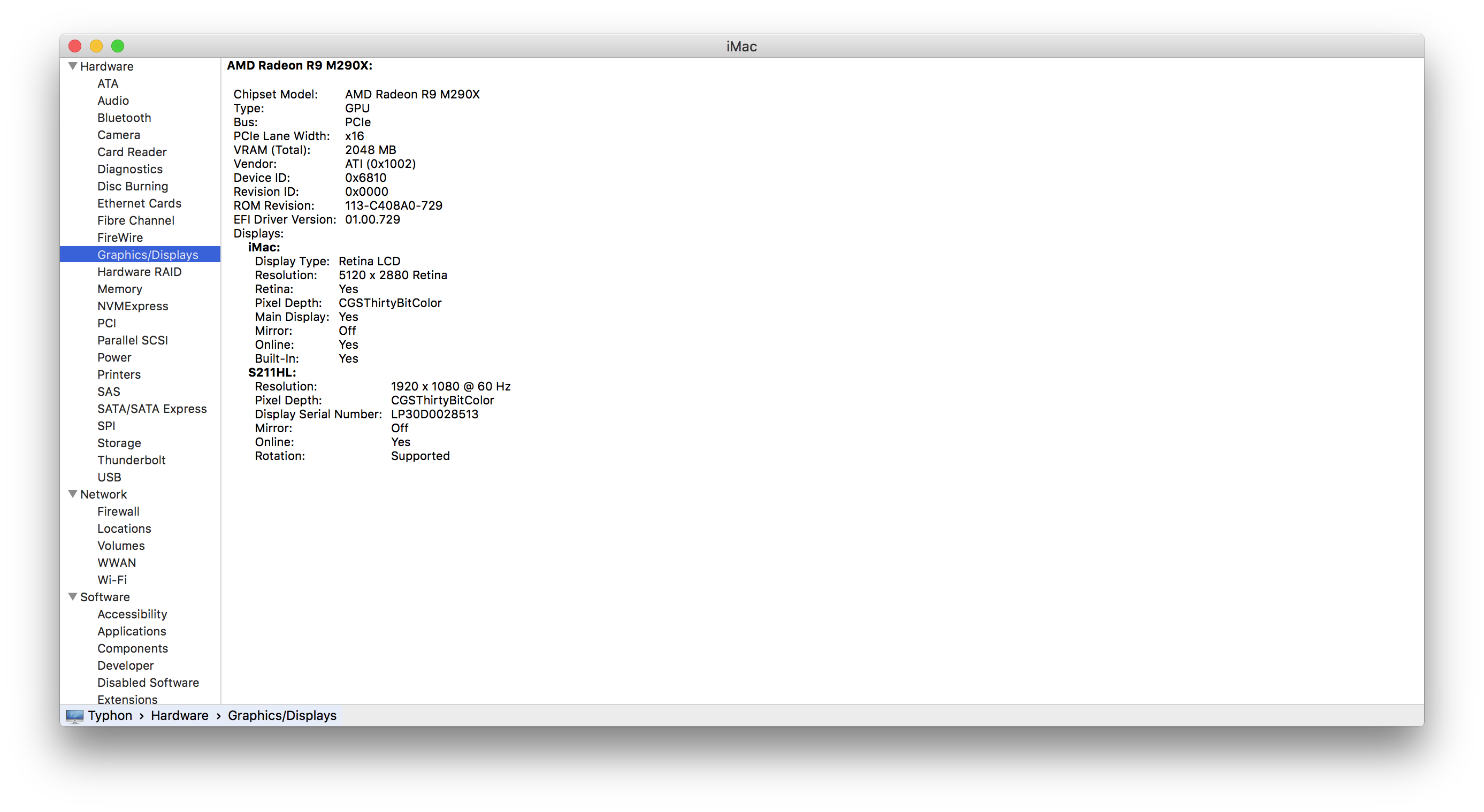

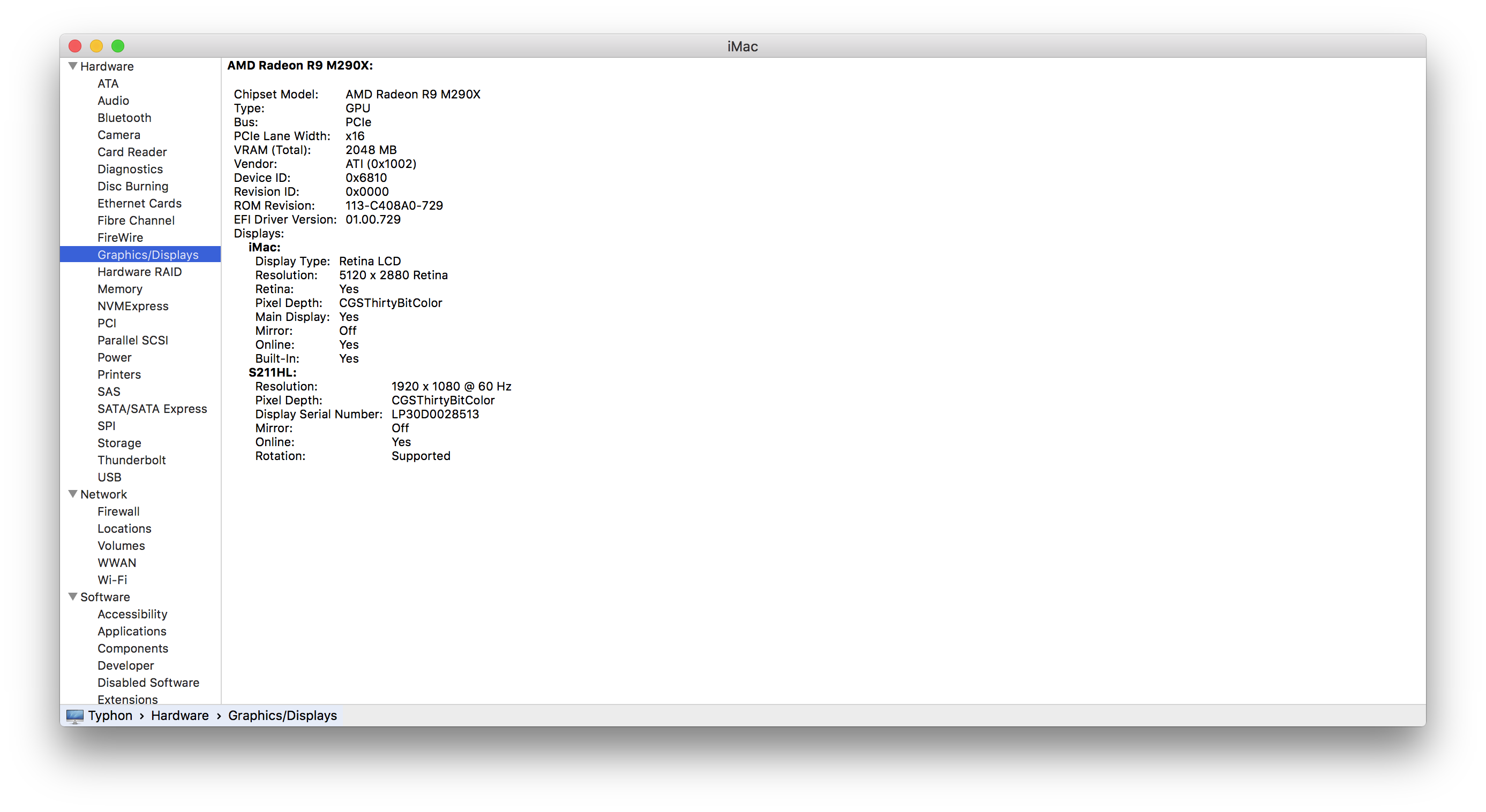

Not quite sure what CGSThirtyBitColor actually means in the real world. The S211H is by most measures, a pretty crappy display, and I'd be surprised if it was 10 bits per channel. Does DVI support more than 8 bits?
Thanks a lot for the screen grab!
Really interesting... according to that, it suggests that it is indeed 10-bit color. Every other Retina screen on macs till this were designated at 32-bit, but parsed out as 8 -bits per channel, including an alpha channel. Your screenshot seems to possibly indicate actual 10-bits per channel, since there is no other calculation to amount to thirty bit color other than 10-bits per RGB channel.

The thing is-- I'm running a first generation retina iMac. So maybe it's a El Capitan thing.

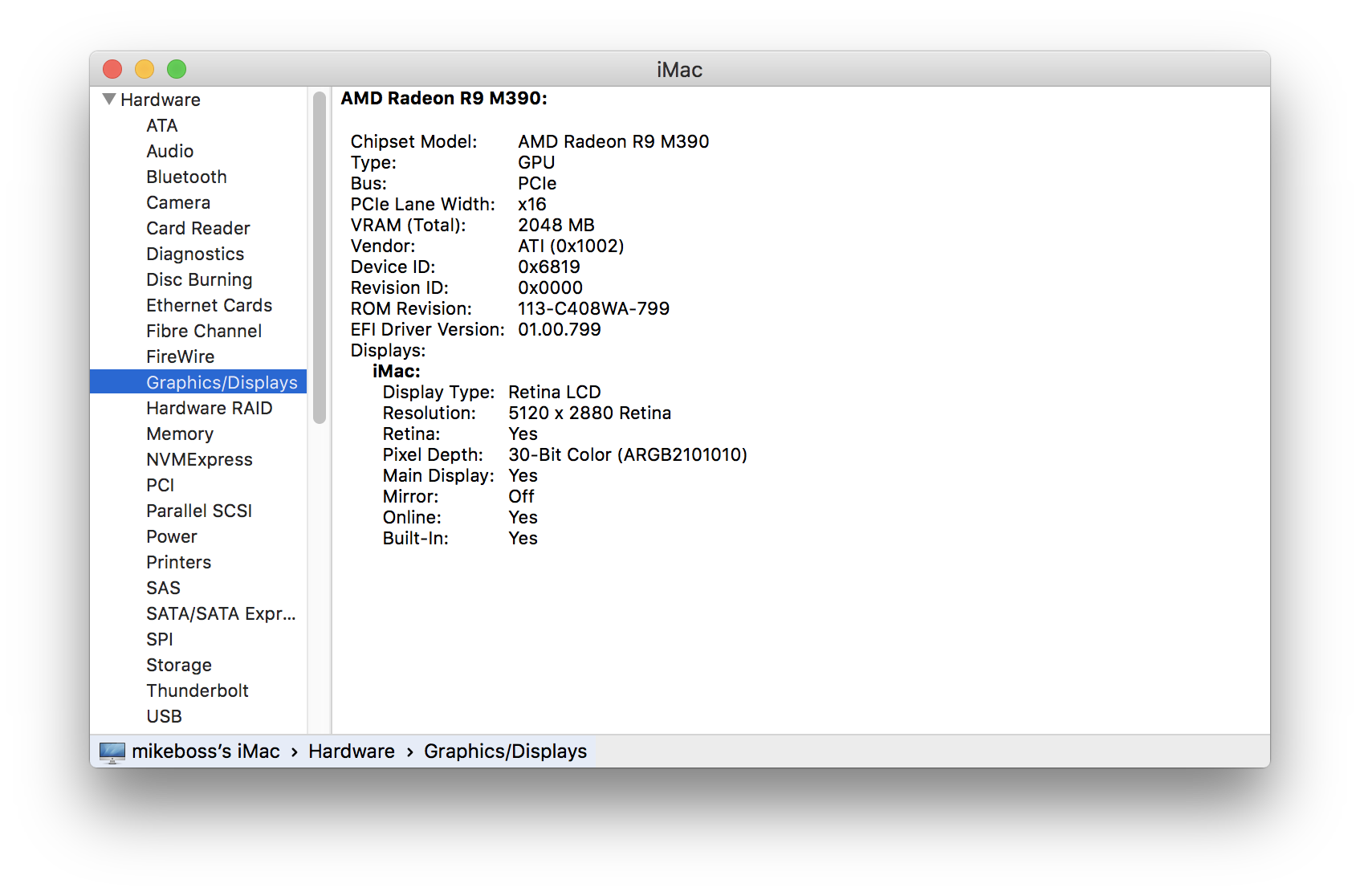

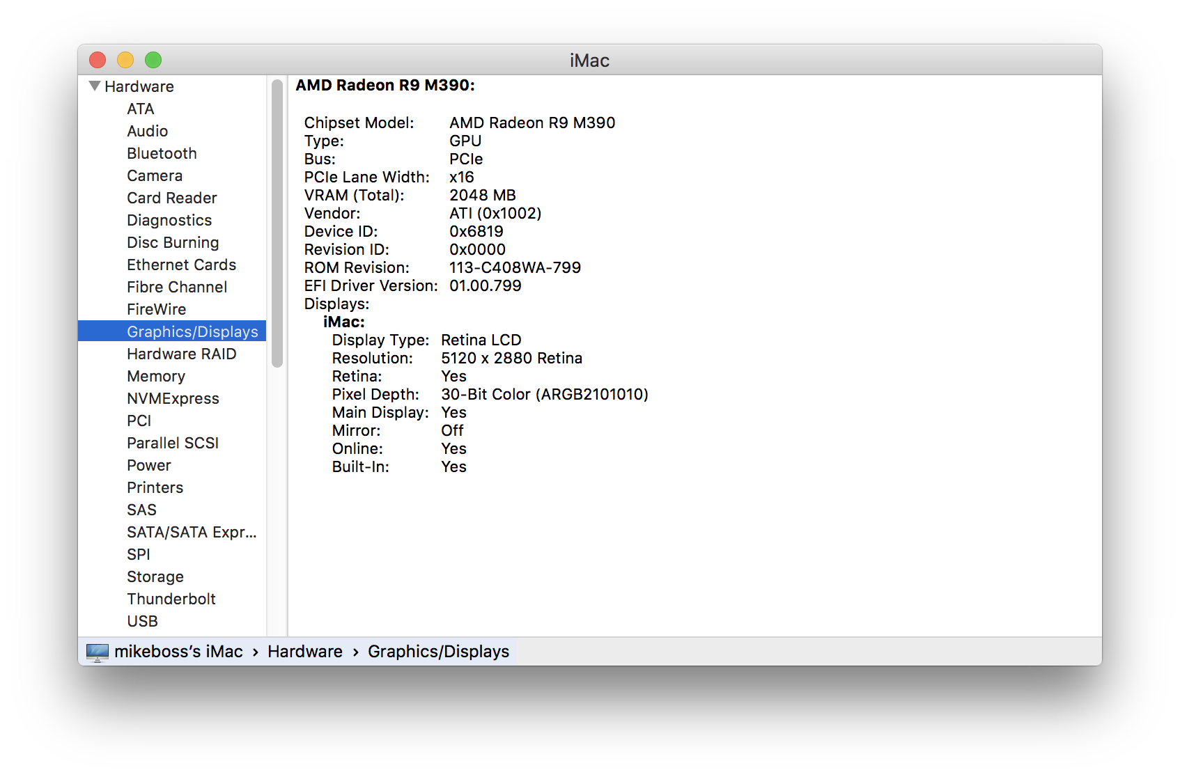

german IT magazine "Mac & i" got confirmation from Apple that we indeed do have 10-Bit (LCD panel and OS X)!!!
article unfortunately in german: http://www.heise.de/mac-and-i/meldung/iMacs-lernen-10-Bit-Farbwiedergabe-2854496.html
Yup, it's the real thing.
Currently, you can only view these 10bit in Preview and in the "Edit" mode of Photos, apparently.
(Which is what the article says)
I don't have a new iMac. But I trust heise.de ;-)
Any bets how long it will take before Adobe picks it up in one of their apps?
That said, there seems to be no mention of it in the developer-documentation (that heise could find).
