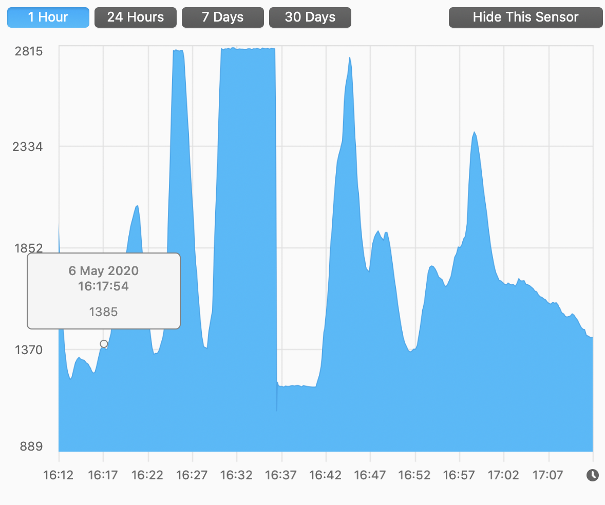

This is what it looks like in the last hour when I was testing it out.
That's the RPM, Temperature would ben better. But the Fans not run that high, so temperature should be ok. hmmm

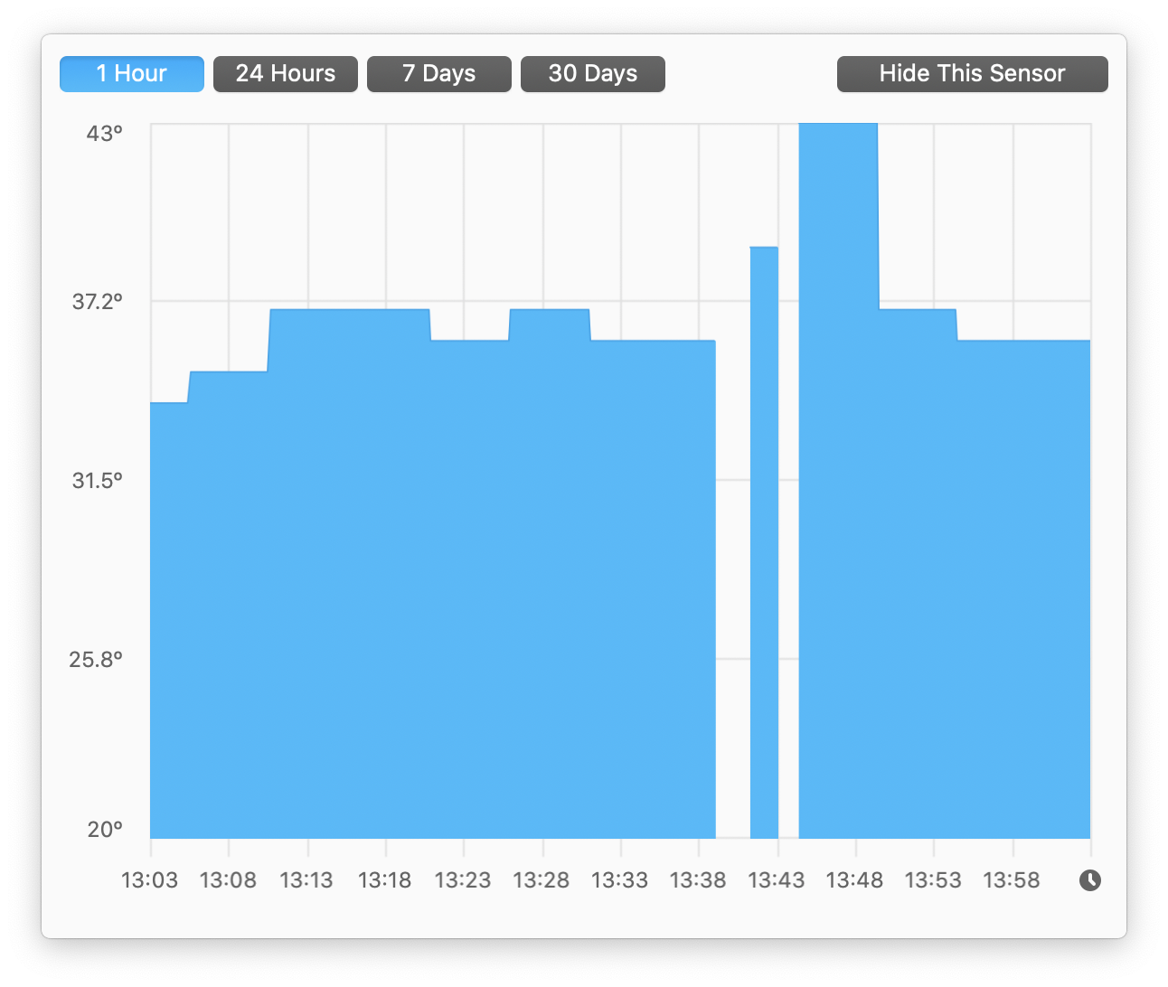

which temp should I be look at in iStat? Another crash there and the fan wasn't even running that high.Screenshot 2020-05-12 at 14.03.33.png
This screenshot of the SSD is worrying. It crashed at about 13:45
