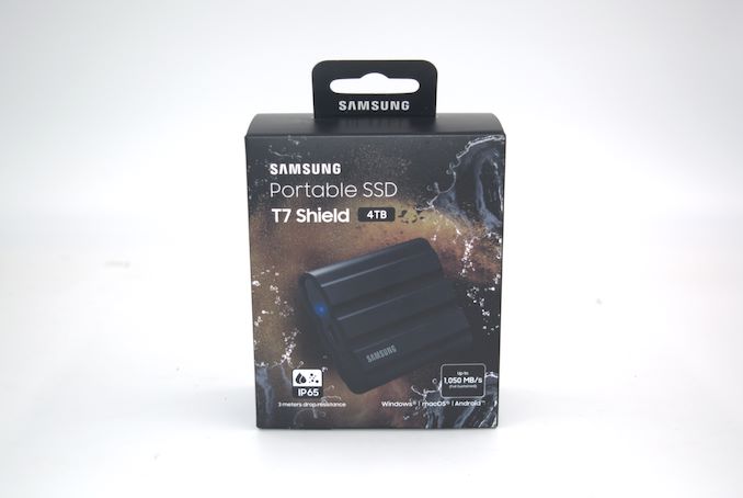

I looked into replacing an internal hard drive with a SATA SSD and I don't think the small gain in speed is worth the hassle of replacing the glass, and you seem to be happy with using an external SSD currently.
Even though you have the Extreme Pro, its speed is limited to USB3 anyway, so there is no benefit to that model given your interface. If you can't wait for the updated firmware/replacement of your current drive, you could look at another external SSD. It seems like the Samsung T7 Shield is good, though the 4TB version runs slow. Also, there have been reports of thermal material leaking from the regular T7 models (not the Shield).
Some references:
Look at the Crystal benchmarks on page 2 and compare the Shield 2TB and 4TB models
