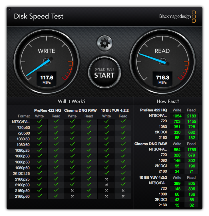

Lessig
macrumors newbie

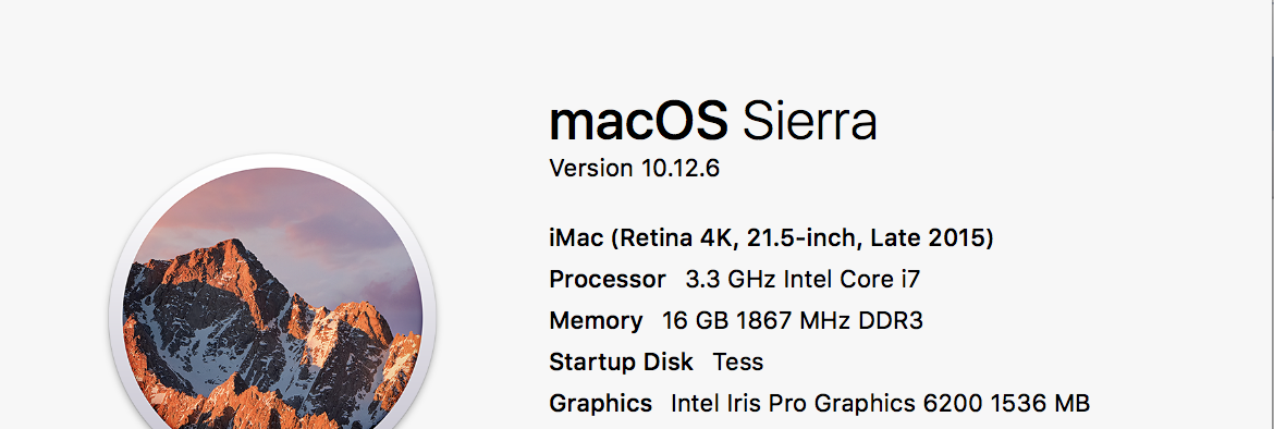

I'm convinced by late 2015 iMac disk is radically under-performing. I've found lots of cool tools for measuring the speed, but nothing that gives me a clear benchmark about what I should expect. Can anyone help? (Blackmagic run at 5GB)
Something is just not right. Dug out my late 2013 i7 3TB Fusion and booted it up.
Black Magic shows Write 320MB/s and Read 688MB/s so Write is way down.
It looks like SSD read speeds and HDD write speeds. Since it is a Fusion Drive it seems reasonable.
I just dug around on the Internet a bit more. It would seem that the 6xx/3xx read/write speeds are the norm. So I would say that nambuccaheadsau is right. Your write speed looks too low.
