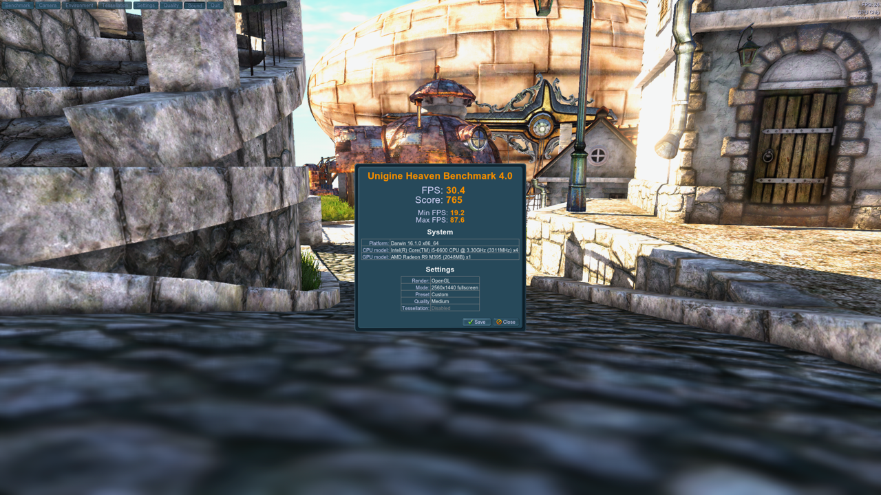

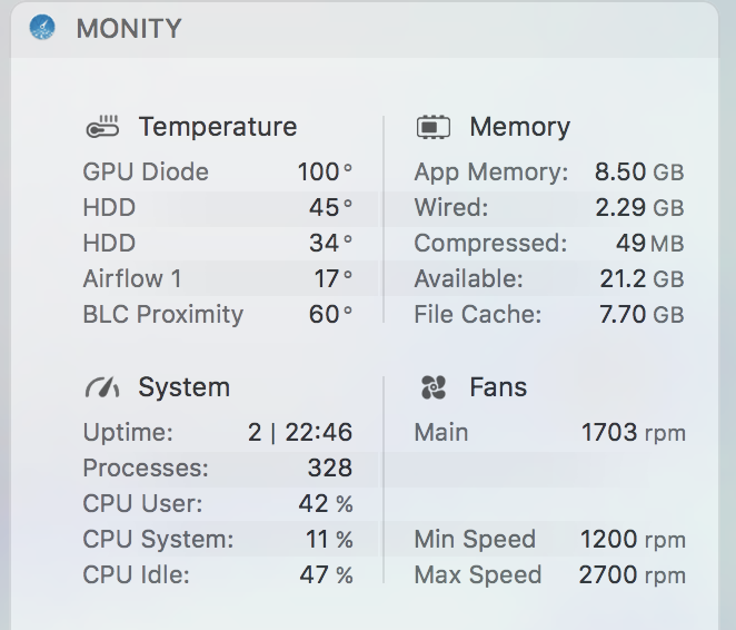

Well I down loaded the Heaven Benchmark test and I got up to 99 C on the 2nd time. I checked my Monity Stat which agreed. The fans were not loud and under 1500 RPM, It did not feel that warm to me. I guess operating temp in 100C is not unusual when gaming.
Curious Merlin what did you score on the bench mark using i7 M395X?
View attachment 673829 View attachment 673822

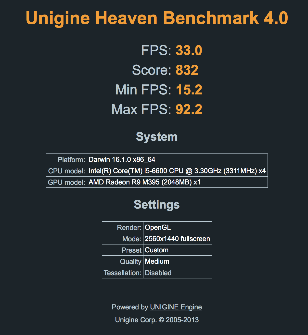

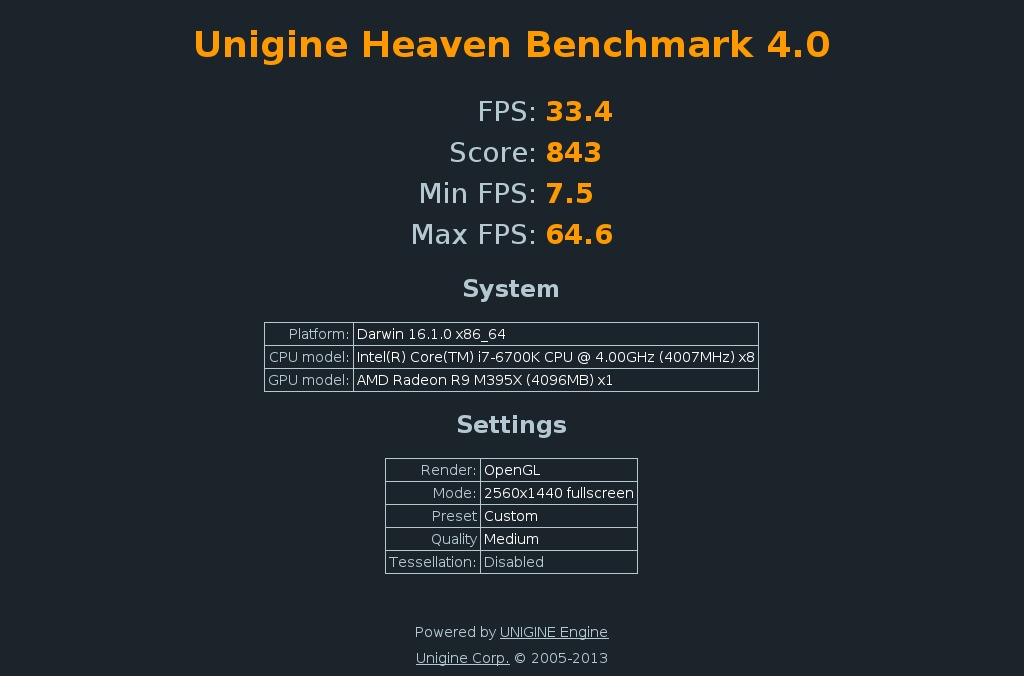

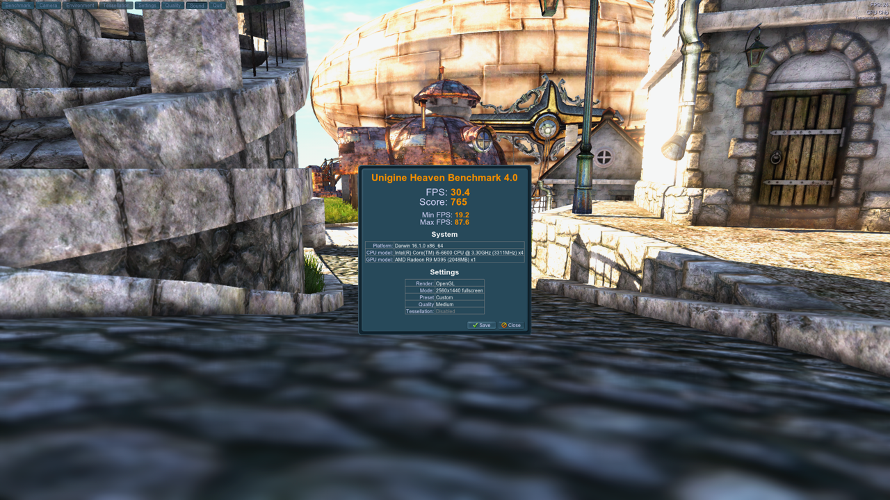

Here's my bench mark. I'm not sure why my minimum and maximum frames are lower than yours. That does seem a bit strange. I guess the overall score difference is about what I'd expect.
Mine got up to 99C on the first run, on the second run, it rose until it touched 102 C, then the fans got a little louder (still just over 1500), and the temperature dropped and then hovered around 99-101 C.

I did get lower min max numbers but the score stayed about the same. I just posted the best numbers 😉

I hope someone tests this on the i7 M395X for you. I ran a few more tests on my i5 M395 and found the fans only get up to mid 1700's after 3 tries, ironically is seemed to get cooler on the 4th run. I found I could run this test in the background to view the temp and fans. Also ironically I started getting better scores, not sure if that was because it was in the background?
Screen Shot 2016-11-22 at 8.11.38 AM.png Screen Shot 2016-11-22 at 7.59.48 AM.png

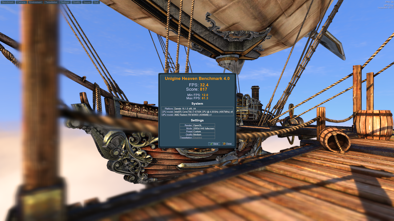

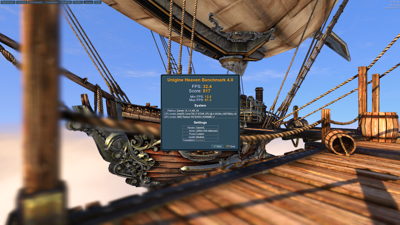

Well, my temp made it to 86C, but I also have my fans turned up to about 2500 (they will go to a max of 2850) running SMC FanControl 2.6. Seems to be ok? Yes, the fans are a bit noisy, but my MAC's stay cool. When doing intensive work, I generally turn up the fans to a tolerable level. By the way, the temp in the house is 72F right now. This is a late 2015 27-inch running Sierra. Thanks...
