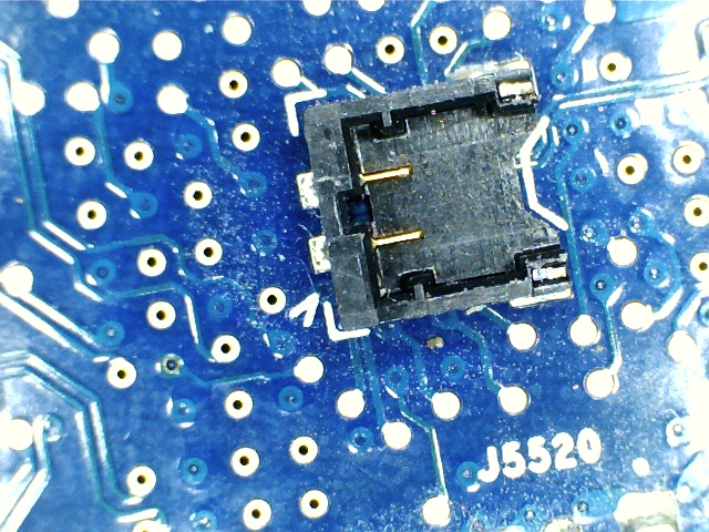

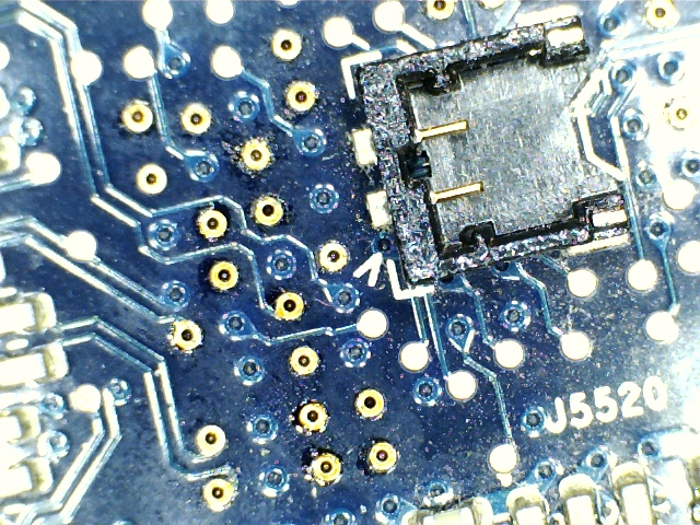

Under a microscope, the solder joints are a nice toasted shade of brown instead of the shiny silver tone they should be.. Since you probably don't have ONE OF THESE and probably never will, I snapped some high res images for ya.
  1. Here's an ultra-high res image of how solder joints should look on a logic board: IMAGE
  2. And here's the burnt one that aplussalesinc tried to pass off to me: IMAGE
