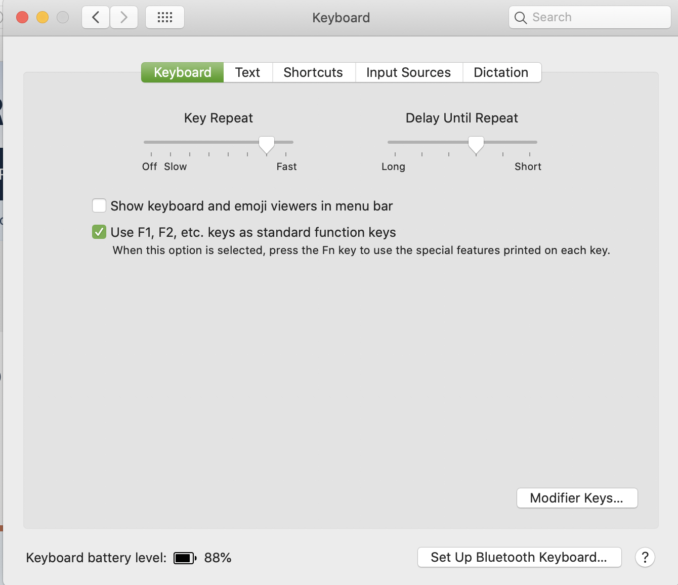

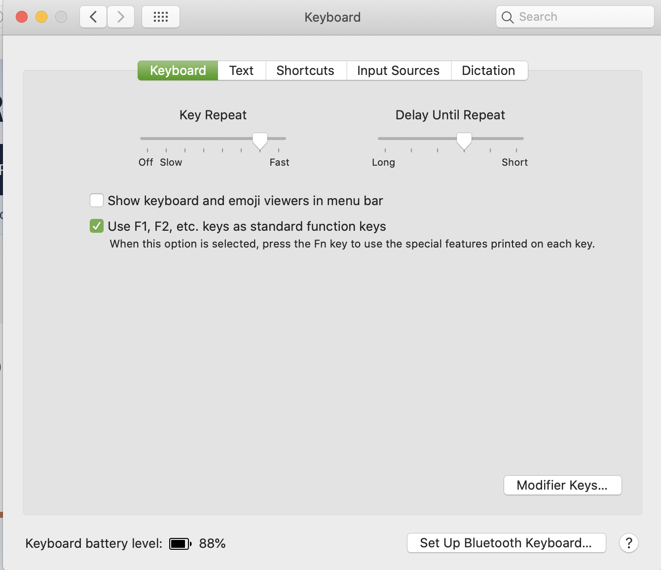

Or try checking this box:

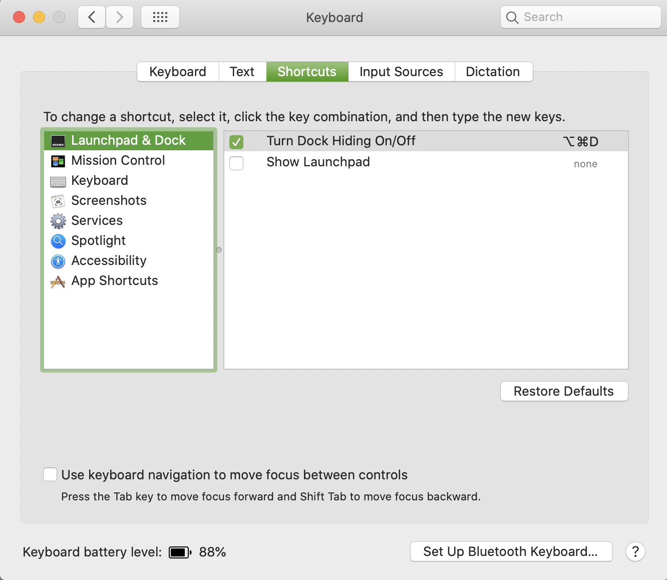

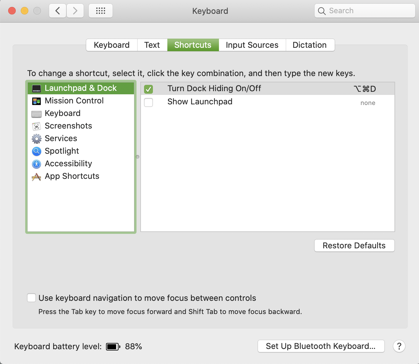

Also make sure there are no shortcuts for "Show Launchpad":

Hey, Yeah so I checked the keyboard viewer and I can see the f4 key (which was the shortcut to open launchpad) lights up when I hit the other keys as well as the actual key I've hit lighting up. So there is the issue...

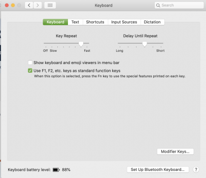

A quick fix is to check "Use F1, F2 etc as standard function keys" in System Preferences - Keyboard. That doesn't solve the bigger issue of why the f4 key is being activated by other keys, but it makes the keyboard usable in the meantime (albeit without the function key shortcuts).
