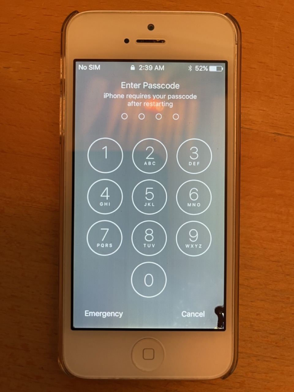

When a relative moved, we found an old iPhone 5 in one of the drawers. The body is in great condition and the battery seems fine, but the LCD shows a blemish (bottom right of pic) and the digitizer doesn't work. There is no crack however. Power button and home button both work fine. I cannot test the volume buttons because I can't get into the OS, as the digitizer doesn't work.

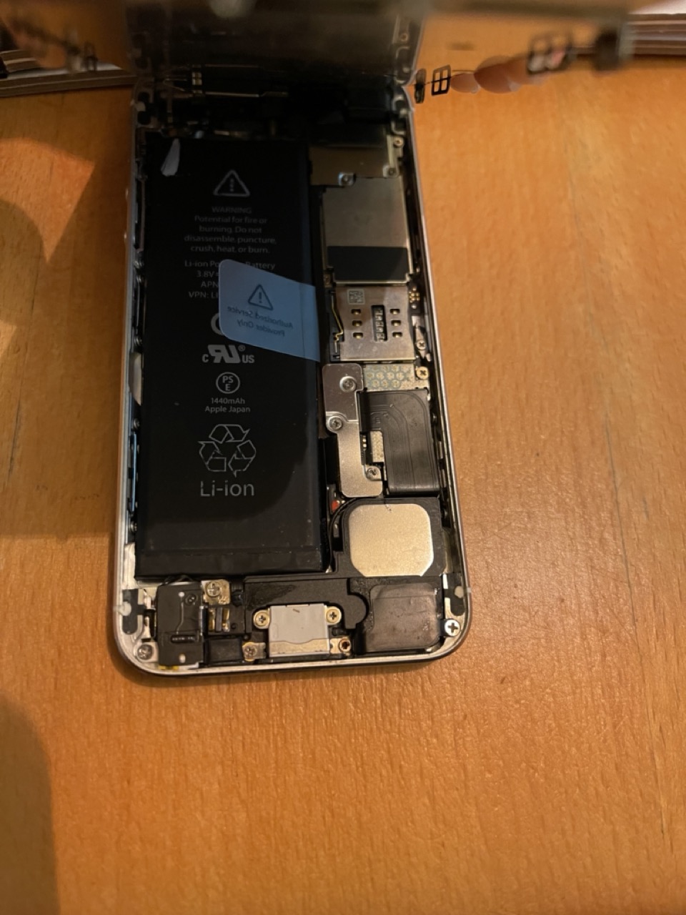

I found out from another family member that the phone did indeed get wet. Some water dripped on it. I opened it up just now (which was remarkably easy to my pleasant surprise) and I see that red dot near the bottom right of the battery. That confirms the water damage, correct?
In this context, is it a waste of time to try to replace the screen and digitizer? I'm still tempted to try it, considering AliExpress sells the digitizer and LCD assembly for less than US$15 shipped.
Can you see any corrosion or other indications that water has damaged anything on the motherboard? I'd say its worth a try to replace the LCD/digitizer especially if everything powers up ok.

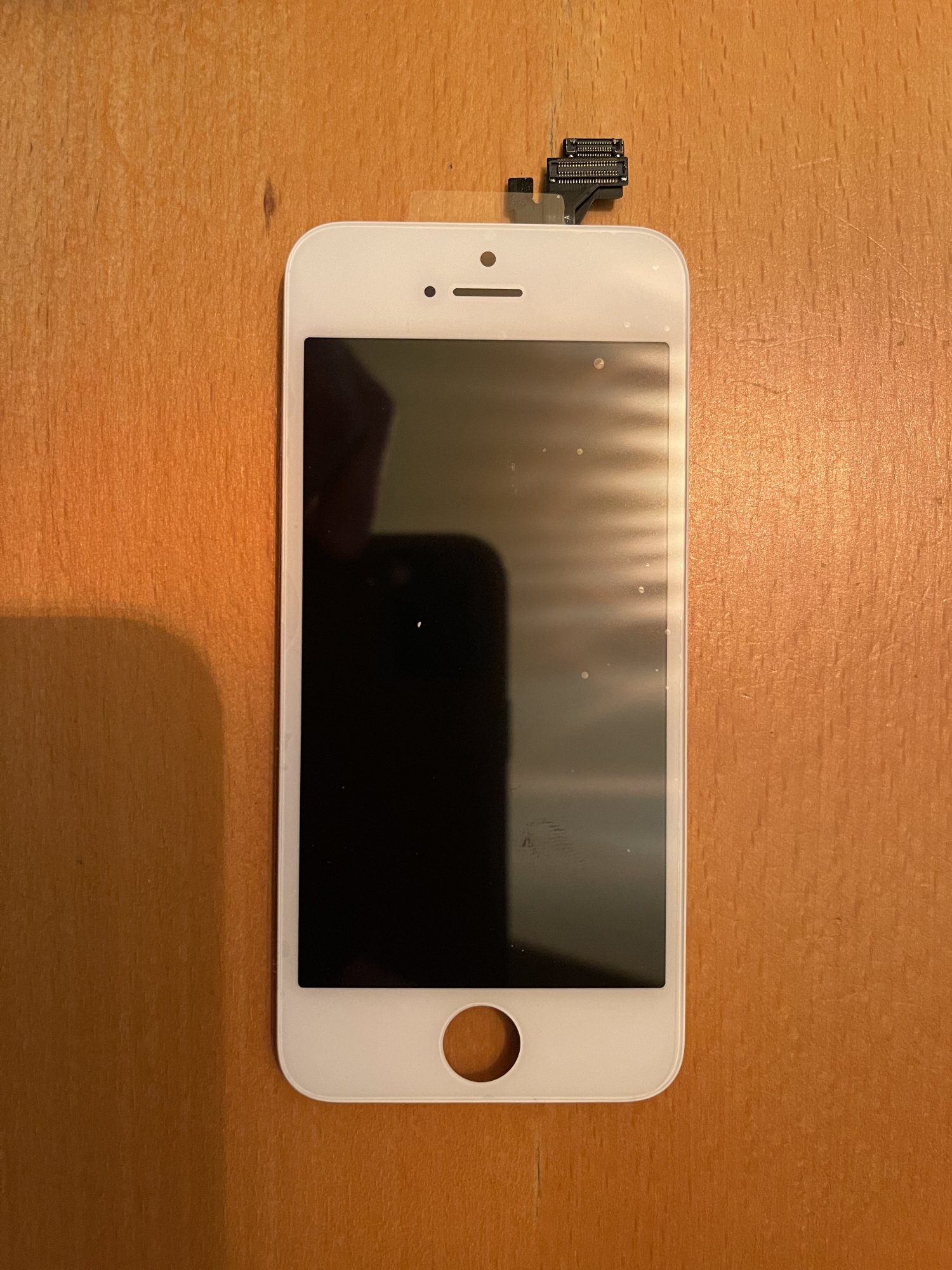

Here we go. This is what I need, right?
Inexpensive, and free shipping to me. I am assuming all of these listings would include both the LCD and digitizer, because they are fused together. Is that correct? Just checking before I order.
You can see that the liquid indicator is red, so I would suggest to remove the board if liquid came that far
Well, this happened a couple of years ago, so it should be dry by now. It’s been unused all that time.

That looks like exactly what you need. All you'll need to do is swap the home button etc..

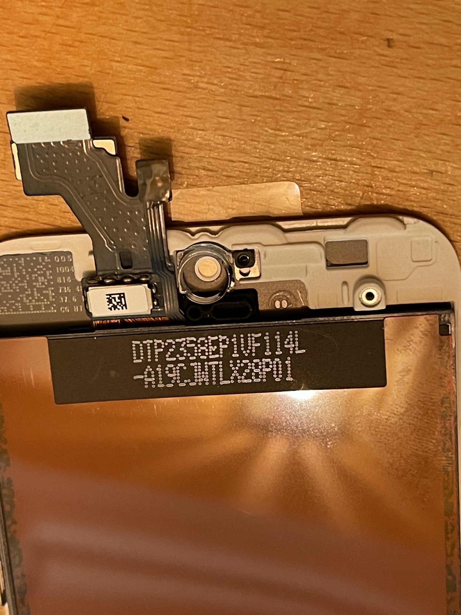

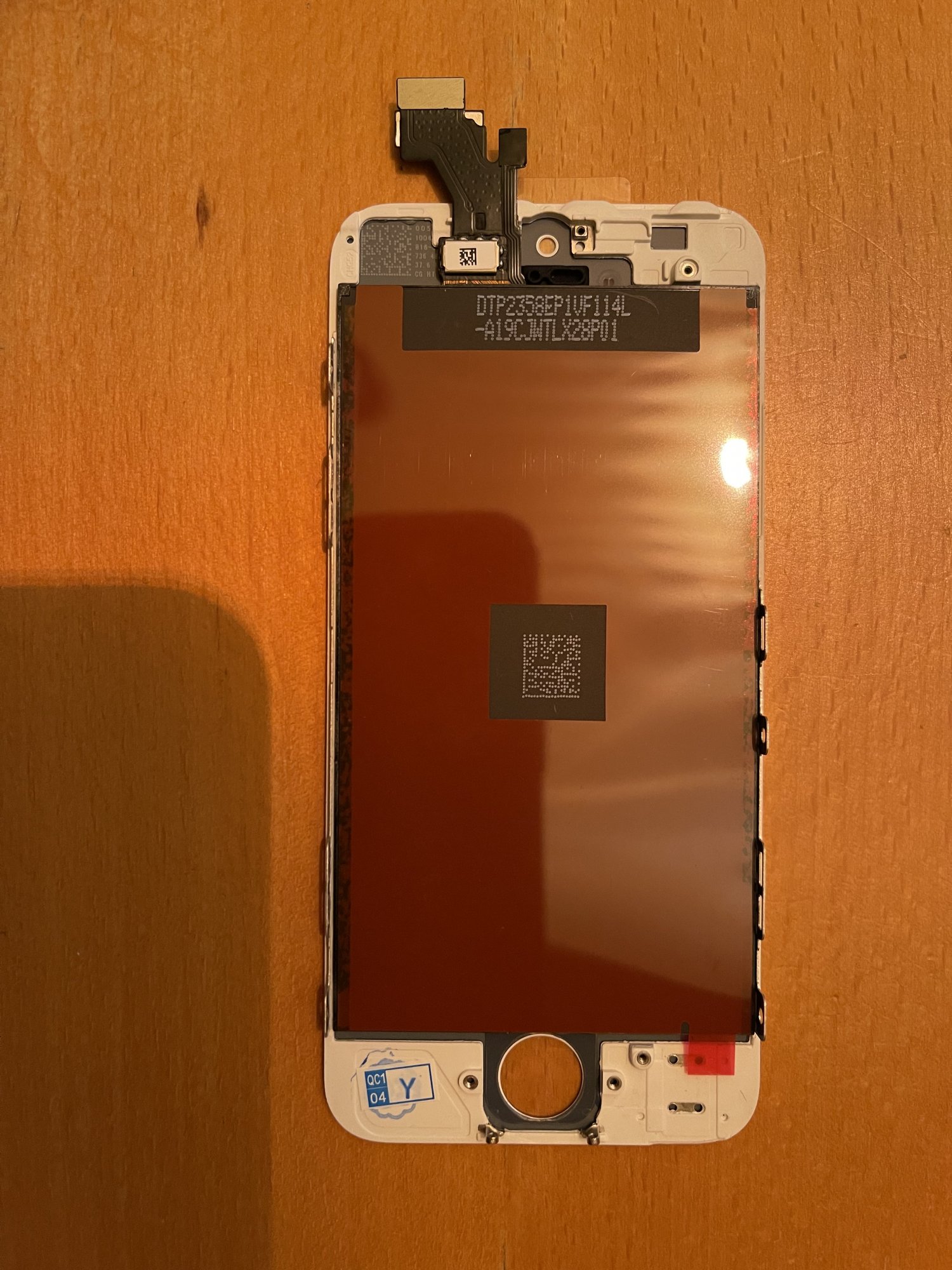

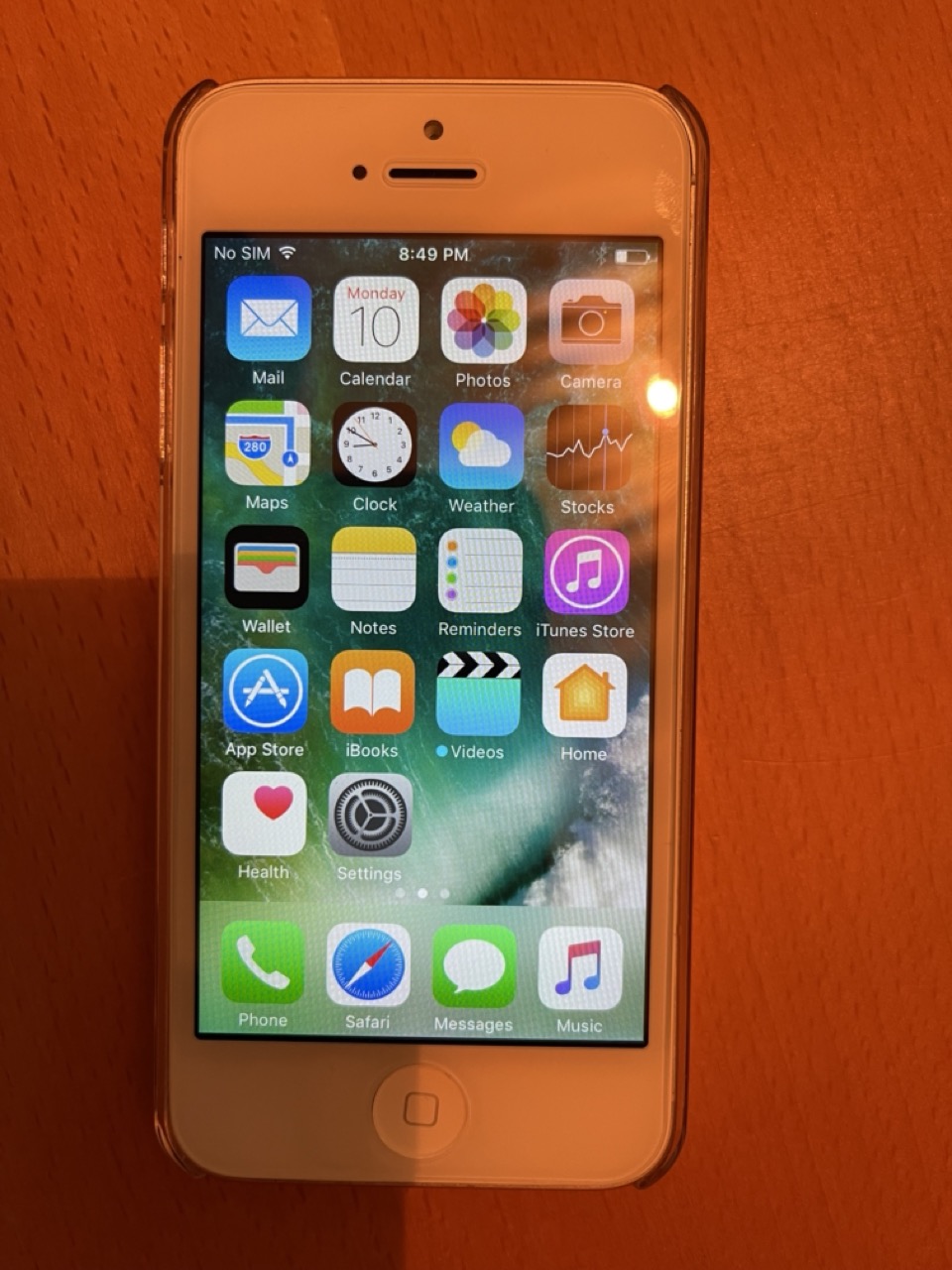

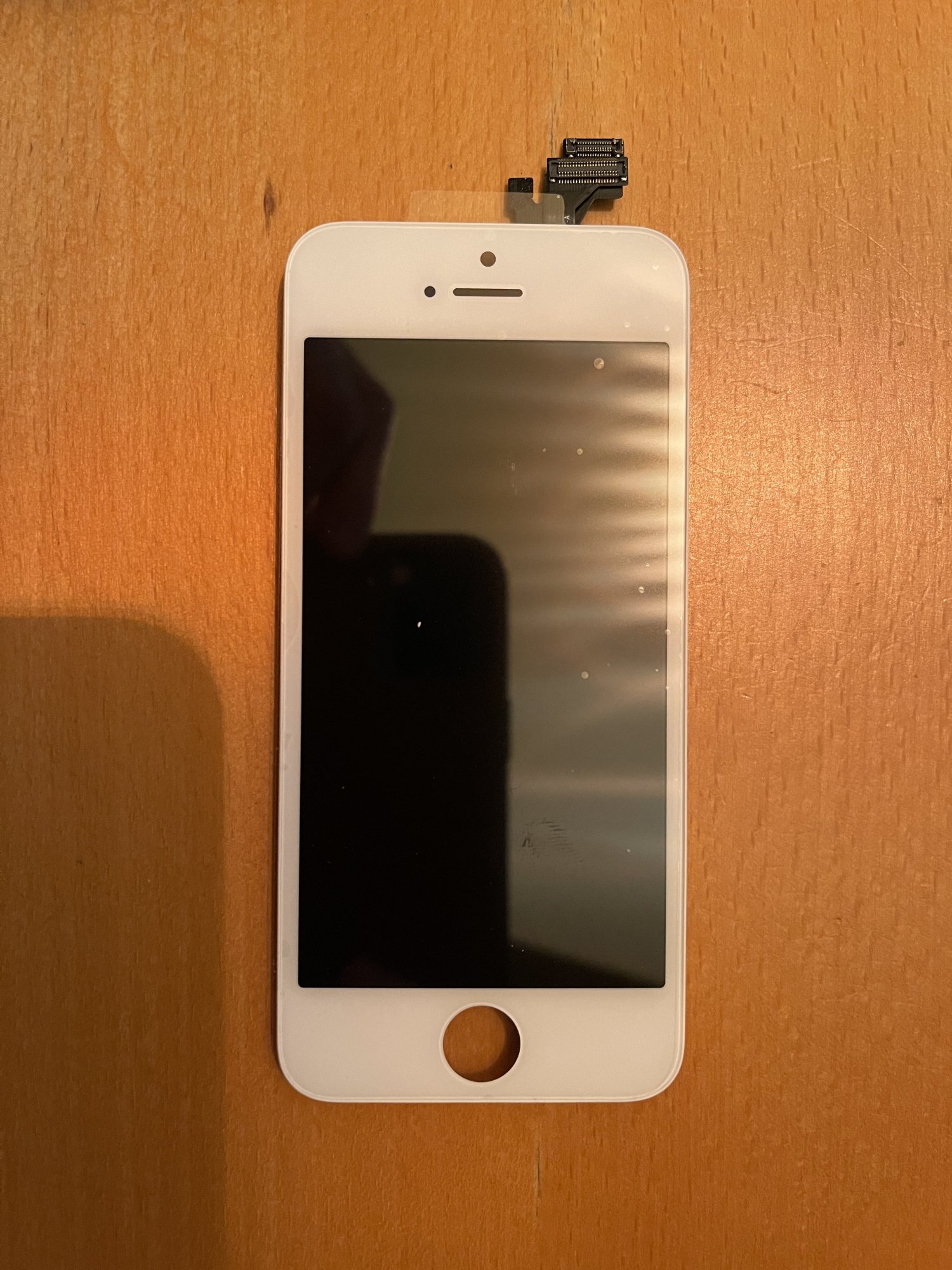

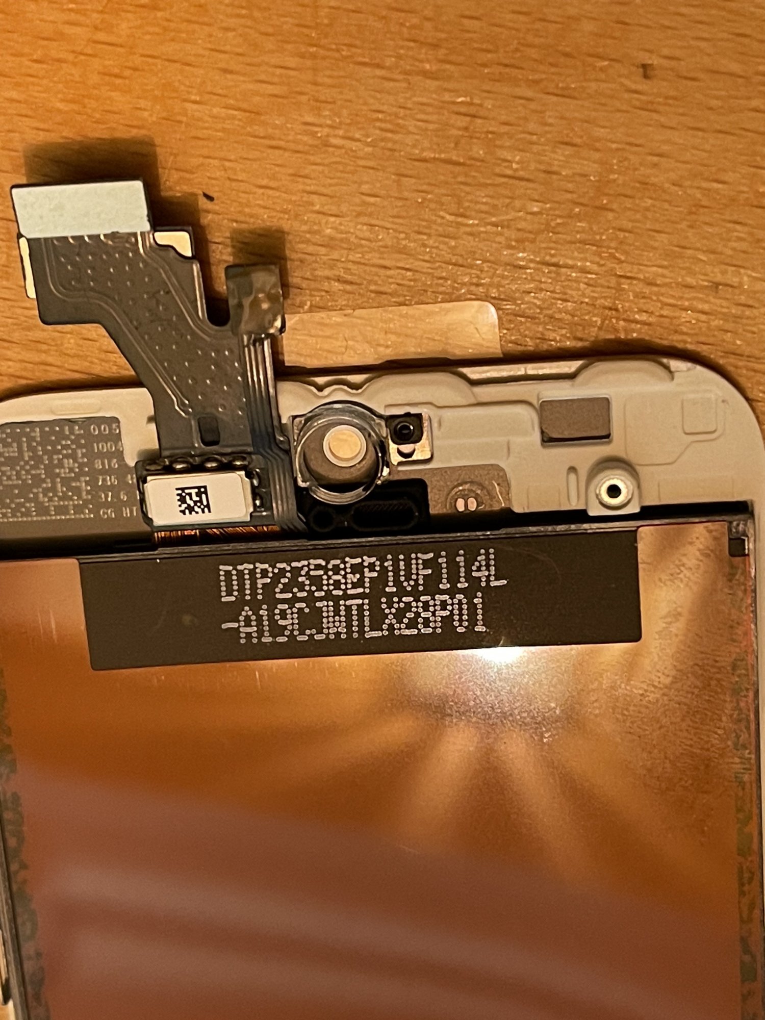

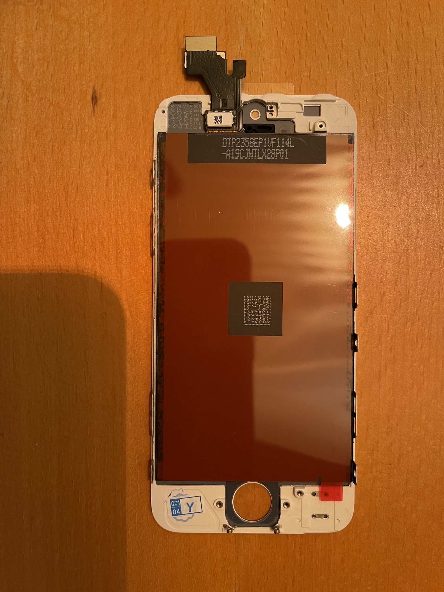

Got the screen/digitizer today and went ahead with the repair. I didn't remove the motherboard but did notice right near where the screen was damaged, the screw on the metal backshield and the adjacent shield were rusted. I didn't see anything obvious anywhere else. My original screen underneath the shield was the bare screen back. On the new one there was this red-brown plastic cover. I saw one YouTuber do the repair and he just left that in place, so I did too. Not sure if that's correct or not.

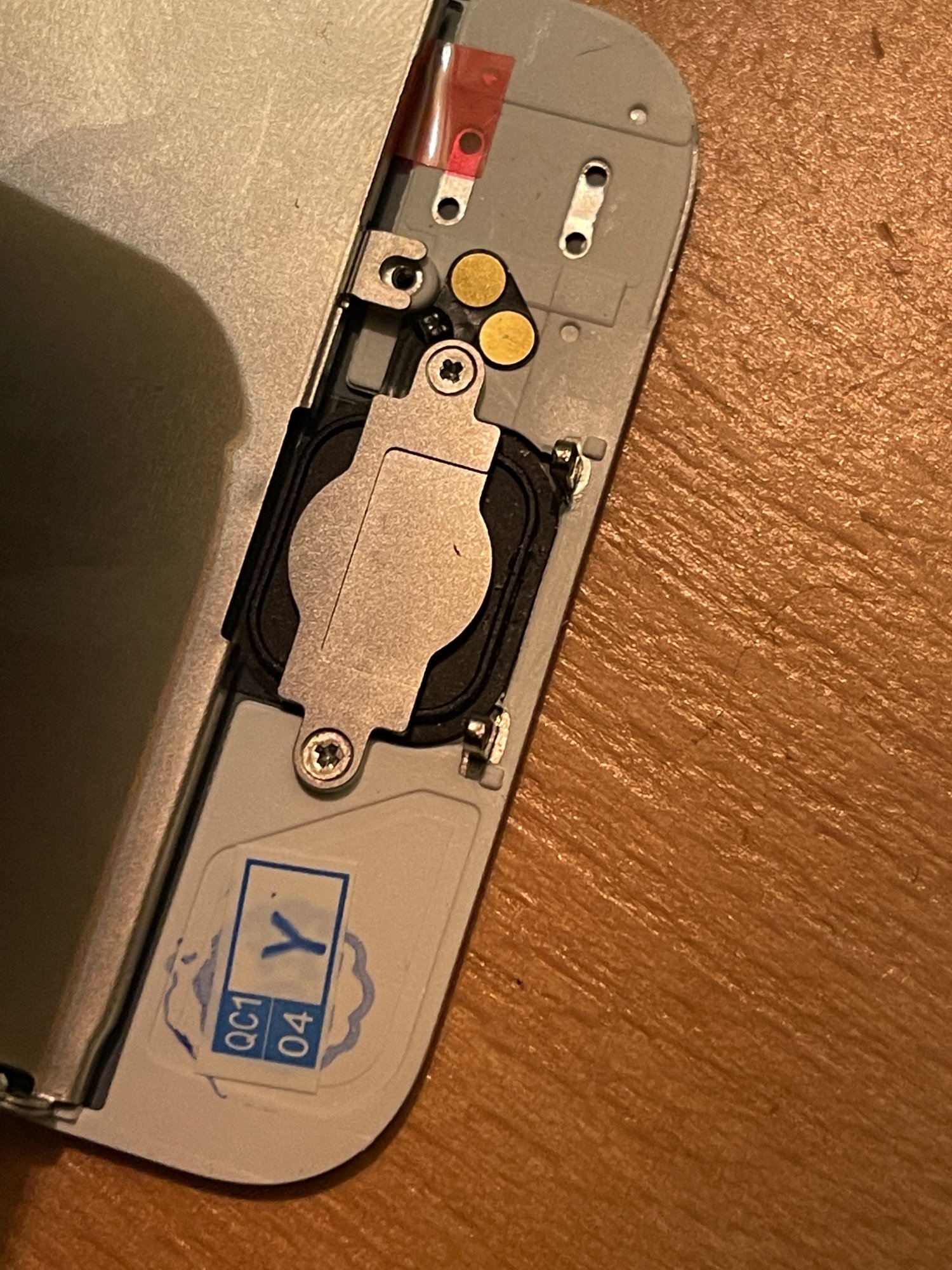

The most nerve wracking part of the repair was peeling off the home button cable and peeling off the camera cable. They are glued on and took some prying and peeling. But luckily I did not rip the cables.
However, the actual hardest part for me was getting these tiny little fiddly pieces in place including a tiny little black rectangular piece around a screw hole and a plastic ring guide for the front camera. The black piece is loose and it took me way too long to install the camera without that black piece moving around. As for the plastic ring, it was glued in before but now it isn't so it is loose. However, it seems fine, and both the front and back cameras are working fine, as is the earpiece and the light sensor.
However, the phone has been worked on before. A couple of the screws were missing inside, but they didn't seem critical.
Anyhow, my relative told me the iCloud password so I was able to turn off Find My iPhone and set it up as a new phone. All buttons and ports work, as does audio. SIM works too. Yay! 🙂
Unfortunately, on iOS 10.x it's quite slow. I guess I can't complain though, given it only cost CA$14 (US$11) shipped for the replacement screen, and the screen looks as good as the OEM. I mean I didn't look too closely but on casual inspection it looks good. I've seen other iPhone 5 screens before that looked visibly worse.
Thanks for the help!

Oops. I see that my home button is not straight. Oh well...

Not sure what I'll do with it yet. Probably not much. I'll just keep it as a backup, and maybe as an iPod for the kids too although they would normally just use their iPads.

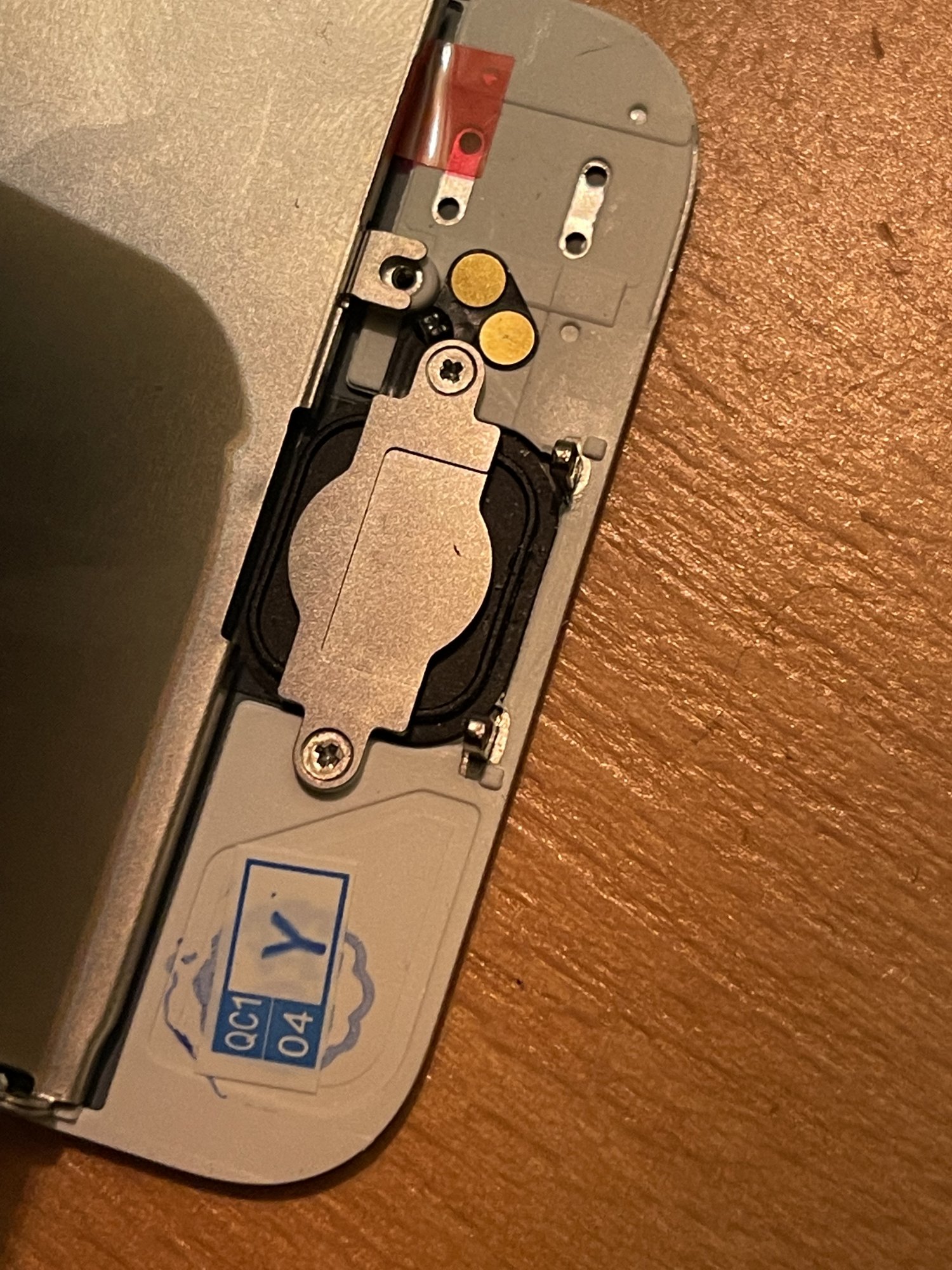

I have learned this is a known issue after screen replacement when you remove and transfer the home button.
It turns out the black rubber gasket around the home button has lost its stickiness after I removed it from the other screen, meaning that it no longer holds the button in place.
If I push the button and shift it up (or down), it can get stuck, and I have to push it the other direction to get it unstuck. Fortunately, I generally don't do that in regular usage. However, the button will rotate slightly in either direction with regular usage.
Thread here:
I tried sticking the gasket back down, but no joy. Oh well, I'm just not going to worry about it. I'm not going to bother buying a new gasket/adhesive at this point.
Thread here:
It won't hinder the function of the home button it just might turn slightly with use. Not a big deal IMO..
