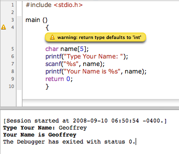

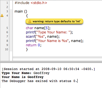

i'm curious about one thing. when i write this code it gives unexpected results based on the book i'm reading "The Absolute Beginner's Guide To C (1994)".
Code:
#include <stdio.h>
main ()
	char name[5];
	printf("Type Your Name: ");
	scanf("%s", name);
	printf("Your Name is %s", name);
	return 0;
in the program i've entered "Geoffrey" and i'm expecting the output to be "Geof" (5 characters including the null zero), but XCode seems to ignore the array length and just prints the entire string (see attached image).
am i doing something wrong, or is the information in this book out of date?

Code:
main()
is not valid code. Use either of the following:
Code:
int main(void)
or
Code:
int main(int argc, char **argv)
As for your program you have a buffer overrun which is bad. You need to put some checking in to make sure you only read the number of bytes that the array can hold. Use fscanf() instead.

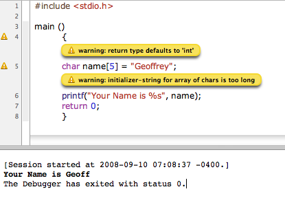

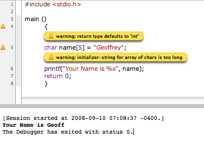

also, i've noticed that if i write this code it doesn't seem to incorporate a null zero in the array as i'll get the first 5 characters of the string, instead of the first 4 and a 5th to represent the null zero...

Code:
char name[5] = "Geoffrey";
This won't work because Geoffrey is longer than 5 characters. Increase the size of array to handle it properly.

sure, but i mean... because of this "null zero" i'm reading about that we're suppose to have enough room for in our character arrays, shouldn't the output say "Geof" and not "Geoff"?
No because C has no array boundary error checking meaning that you will actually get Geoffrey written to memory it will just overwrite stuff it has no right to touch. This is the number one cause of security issues in C code. Never ever try to put something into an array which is larger than the array itself, and also remember to make the array one larger than the string you are putting in to allow for the '\0' (null) terminating character.

so why does
Code:
output "Geoff" and not "Geof"?
see example in post #3 of this thread.
Because the \0 is after the y. C does not automatically terminate at the length of the array with \0: it is added to the end of the string.
So "Geoffrey" is ['G','e','o','f','f','r','e','y','\0']. When you assign this to a 5 element array the first 5 elements are assigned. As you can see this will be ['G','e','o','f','f'].
As noted above C will then write ['r','e','y','\0'] into the next 4 char sized (so 8 bit) areas of memory after what you have declared. If you are lucky your program will crash. If you are unlucky some of your in-memory code will get corrupted.
Always either check your bounds or use the string copy functions to protect against this.
