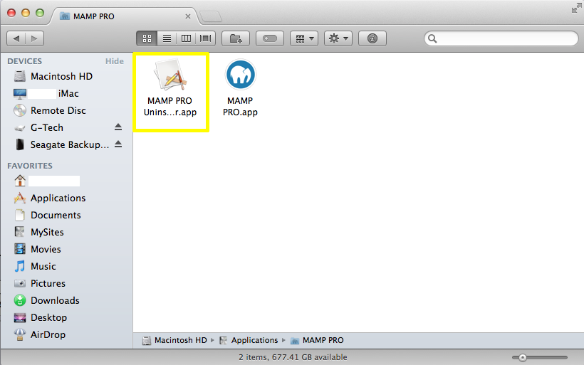

Maybe you can help. I downloaded and installed MAMP and just for the heck of it the 2 week trial of MAMP Pro which ended up installing a suite of apps. When I tried to run MAMP I got a warning that I should only be running MAMP Pro. My post on Stack Overflow is here. Any advice?
Hi firedept,
You should have two folders in your Applications Folder. One will be MAMP and the other MAMP PRO. Inside the MAMP PRO folder you will find the uninstaller for MAMP PRO. Just double click and your on your way. It will leave MAMP behind for you, which is the free version.
Thank you - worked like a charm. Much appreciated.
