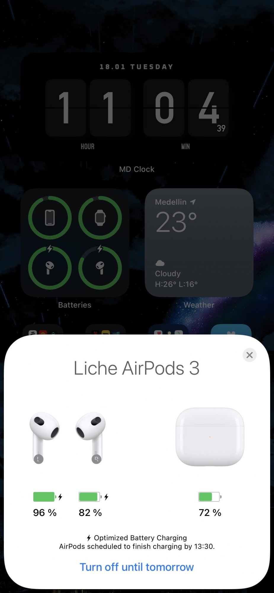

I have had something similar but not the same happening. I will share some details just so that we can compare. In both cases the right bud was charged up to 80 %, the left was at 20 % and the case was dead. In both cases I saw that the Airpods Pro have tried to connect to my phone overnight (have Shortcut automation when the APP are connected to my phone). I have optimized charging on so in a lot of cases the bud would be charged up to 80 % and not 100 %.
Either way so far my assumption was that if the case does not have enough charge to charge both buds sufficiently, it would charge only one of them so that at least one bud can be used while the case and the other one are charging. Not sure if this is the case though.
