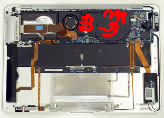

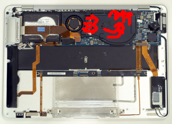

According to this picture from another post, the fan blows hot air from the right to the left side.
The left side of my MBA is warmer too. It's not defective.
That makes sense... but I feel the left palm rest area is hotter too...
