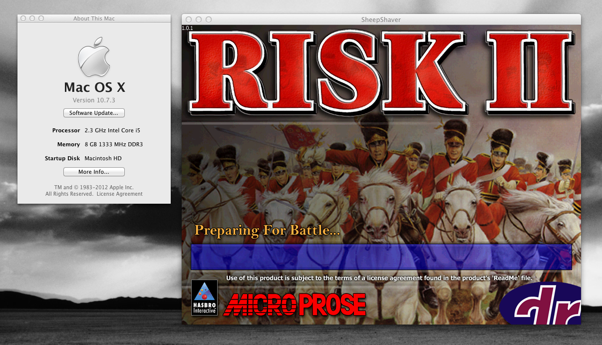

VirtualBox won't work to run OS9 and OS8, those operating systems were written for the PowerPC CPU. Virtual box uses Intel's Virtualization technology in the CPU. You would need something like sheepshaver which is an emulator, you'll need the old Mac os Roms to make it work

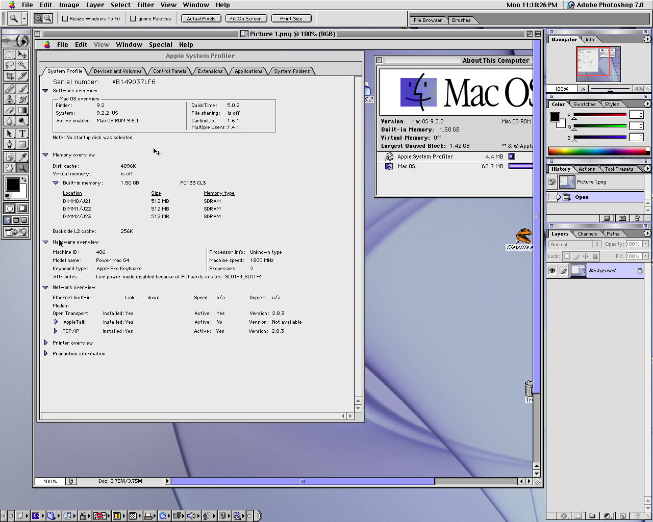

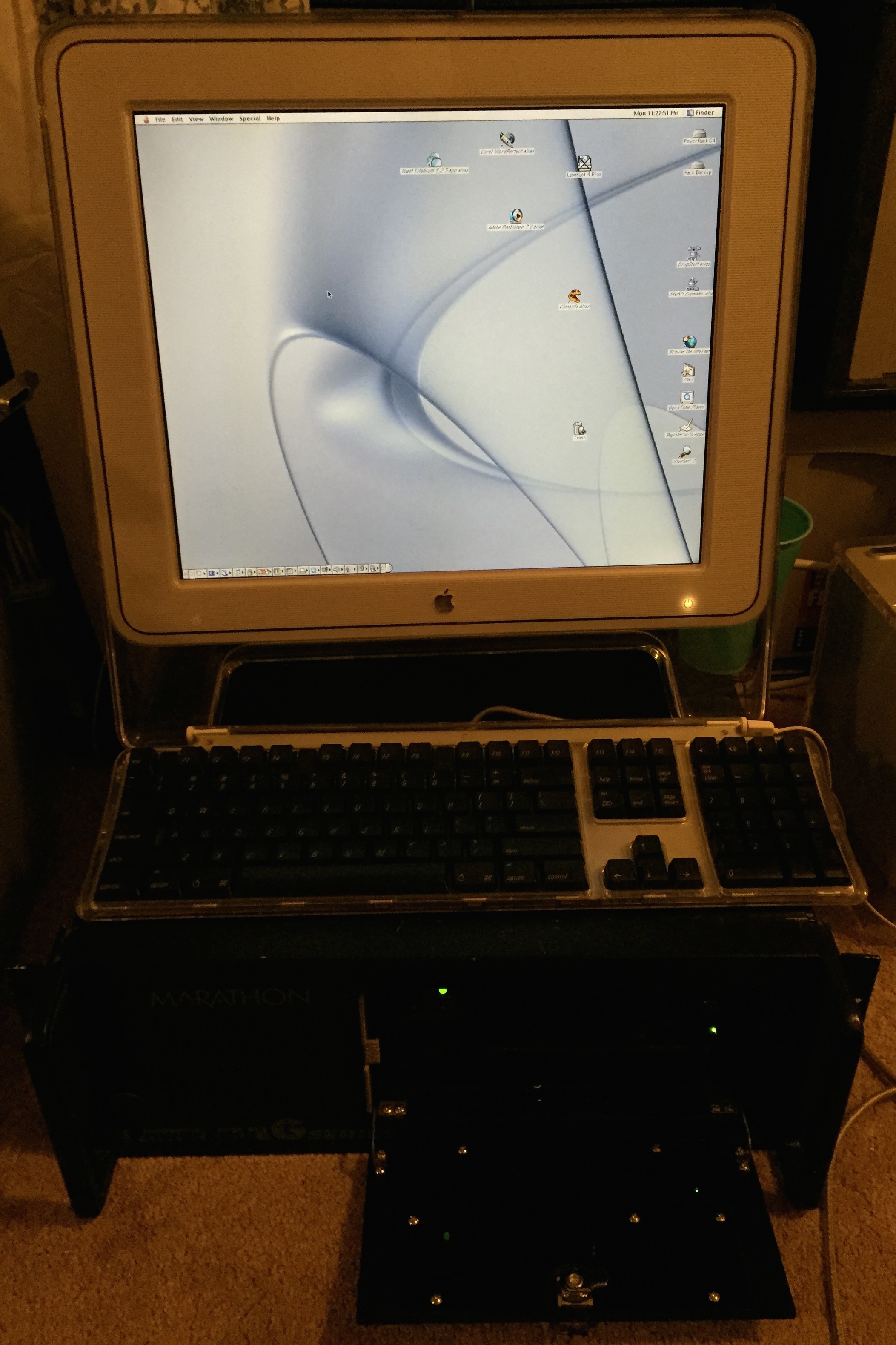

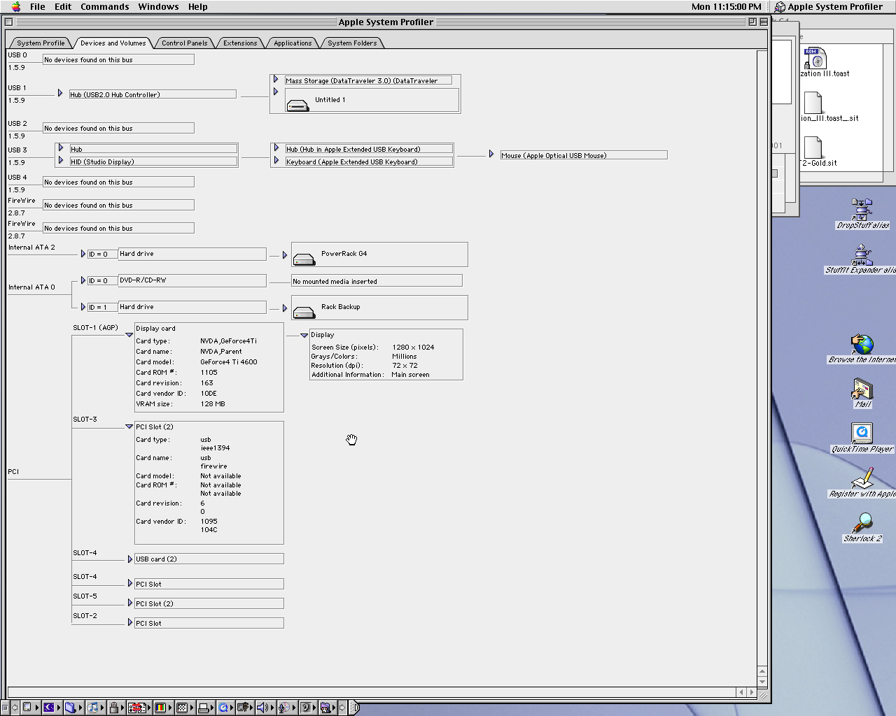

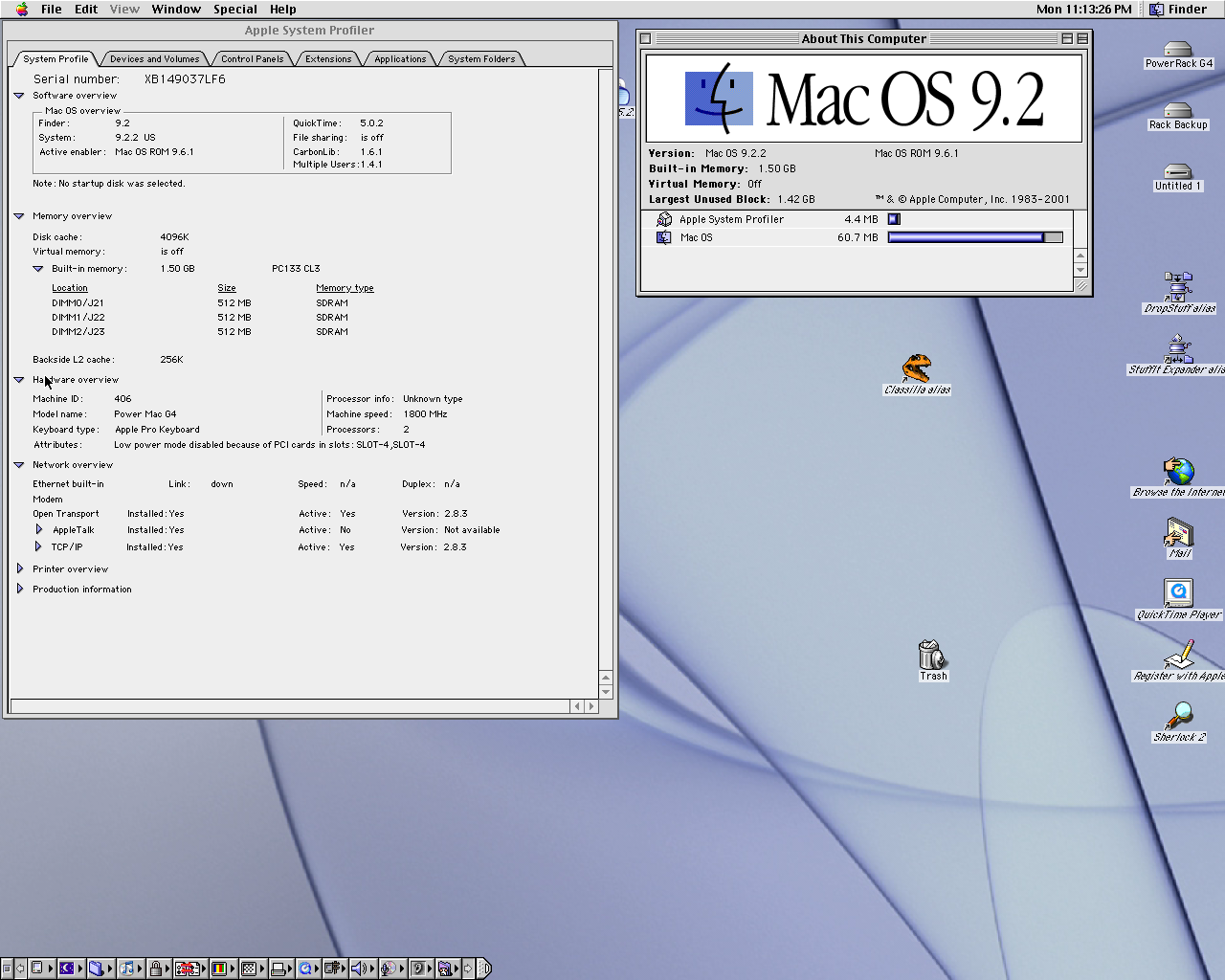

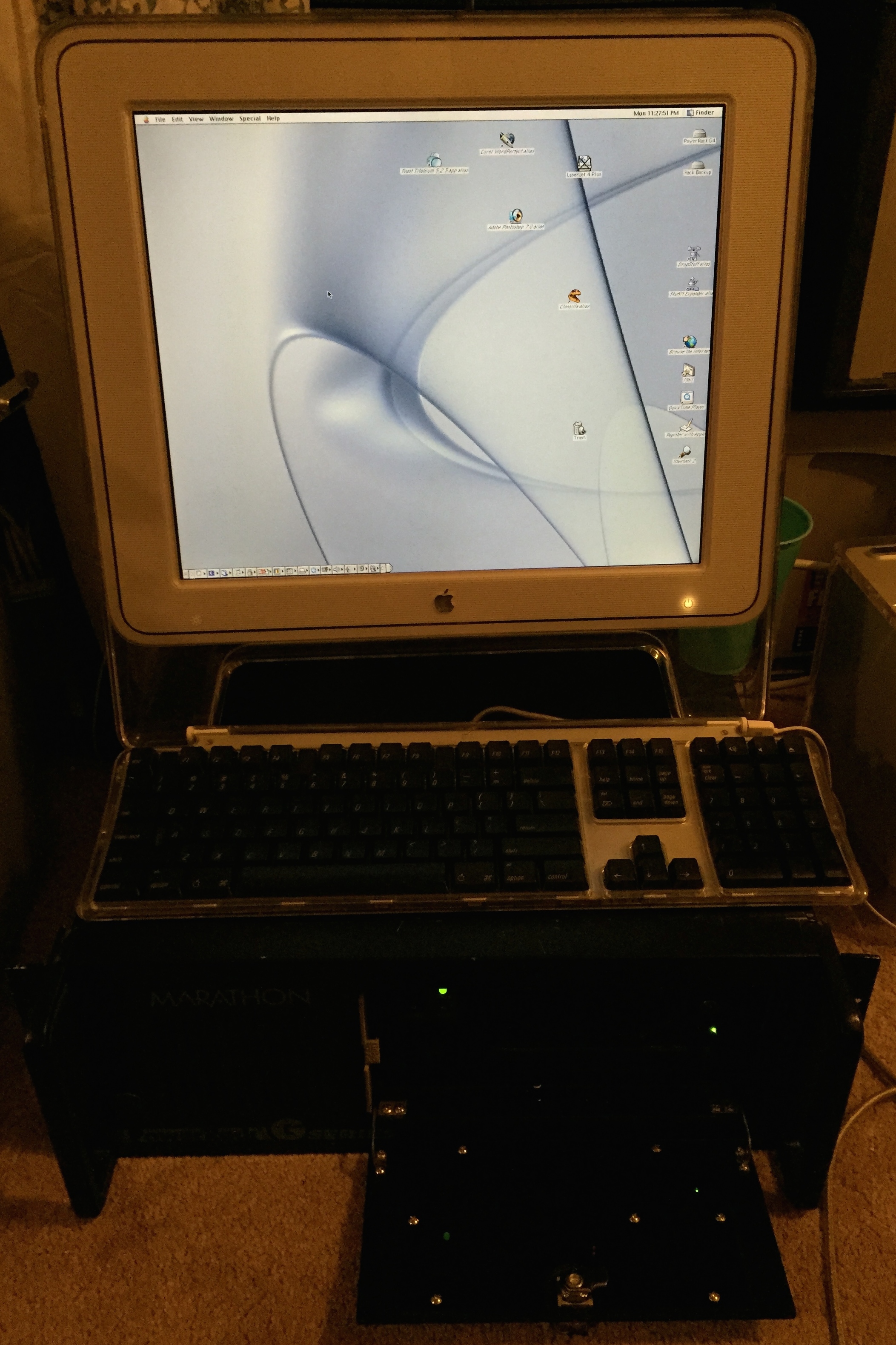

This isn't strictly on-topic, but since I'm pretty adamant about running OS 9 natively, I thought I'd show the below.
I'm not one for hyperbole, but this is likely one of the fastest computers in existence capable of booting into OS 9.
It started life as a Digital Audio G4 that was transplanted into a Marathon rackmount case.

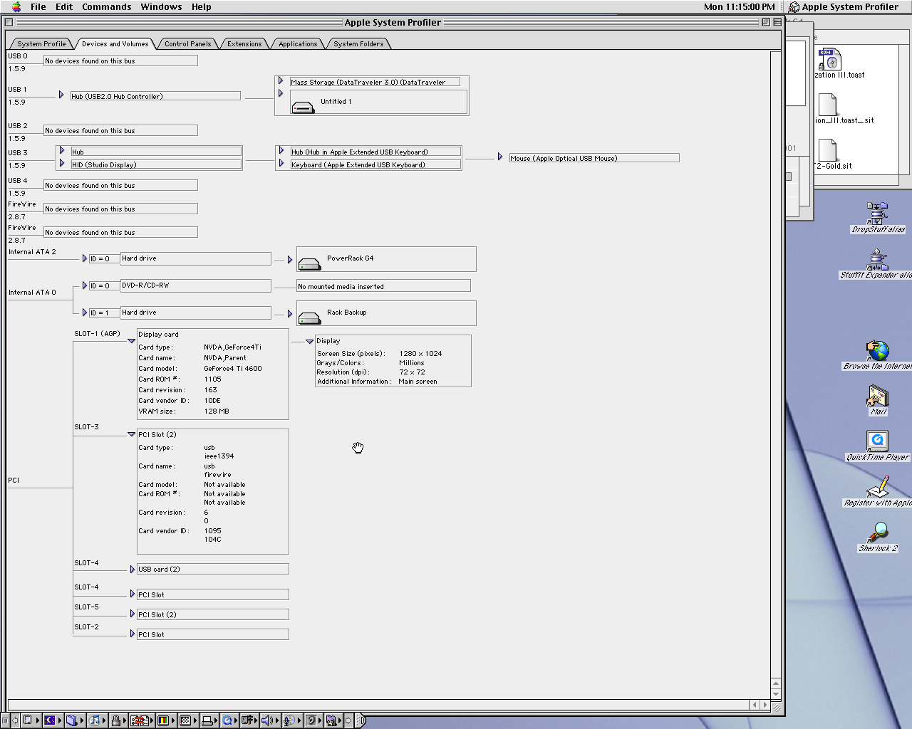

I acquired it a few months back, and have done some tinkering with it here and there. A few weeks ago, I installed a GEForce 4Ti 4600-the highest performance graphics card that is fully compatible with OS 9.
Shortly thereafter, I acquired a Sonnet Dual 1.8ghz processor upgrade. The Sonnet uses 7447A processors(the late generation G4s that were developed for notebooks). They have a native clock speed of 1.42ghz, but are overclocked to 1.8ghz. BTW, I have another dual 1.8 7447A that uses 1.25ghz processors, and has never(through three owners) run reliably at 1.8ghz-I currently have it at 1.6.
The Sonnet applies a firmware patch to "trick" the computer into thinking it's something other than a 7447A, as the computer will not normally even boot with one installed. The 7447A Gigadesigns I have also will not boot into OS 9, although the Sonnet goes out of its way to retain OS 9 compatibility.
Thus, I have a dual 1.8ghz G4 running OS 9. The fastest Apple made that could boot into OS 9 was a dual 1.25ghz.

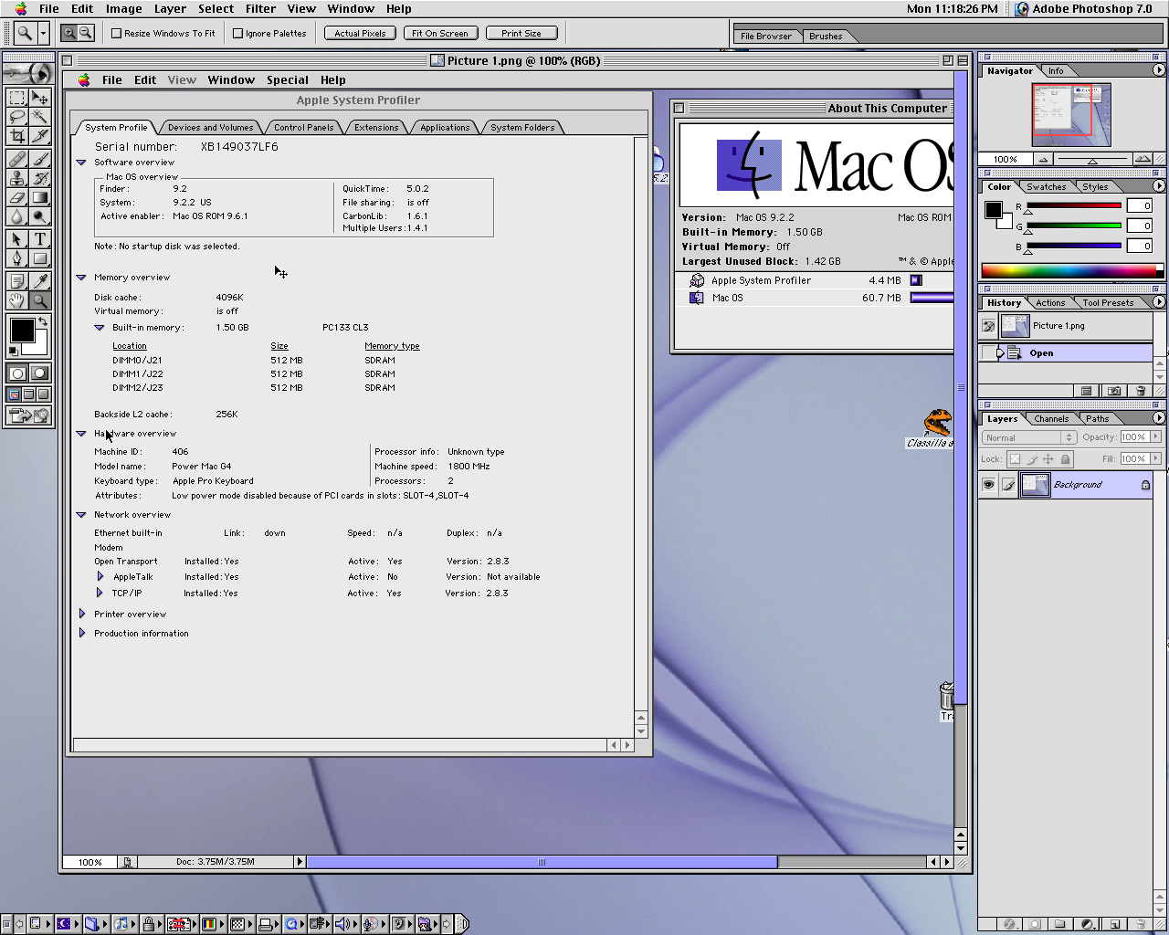

Unfortunately, OS 9 itself does not see any benefit from having multiple processors, although certain applications(Photoshop 7 is the stereotypical example) can use both processors. I can tell you that Photoshop 7 is a beast on this computer(and honestly there's nothing I need to do in Photoshpo that PS7 can't accomplish), although the lack of USB 2.0 support under OS 9 is a bit of a bottleneck. As much as I love Firewire(FW400 has full support under OS 9), high speed USB is a practical necessity for image manipulation now.

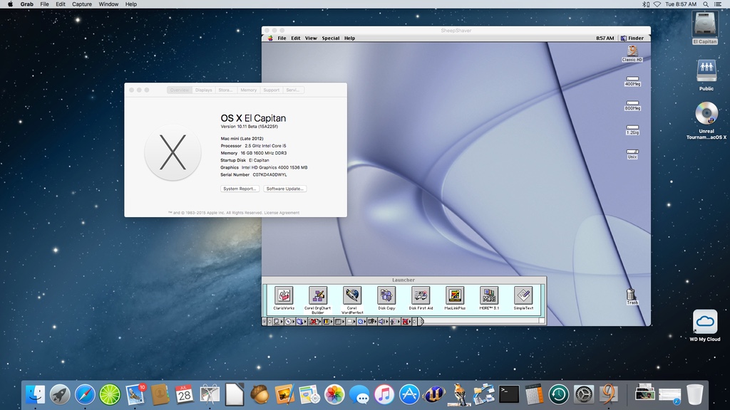

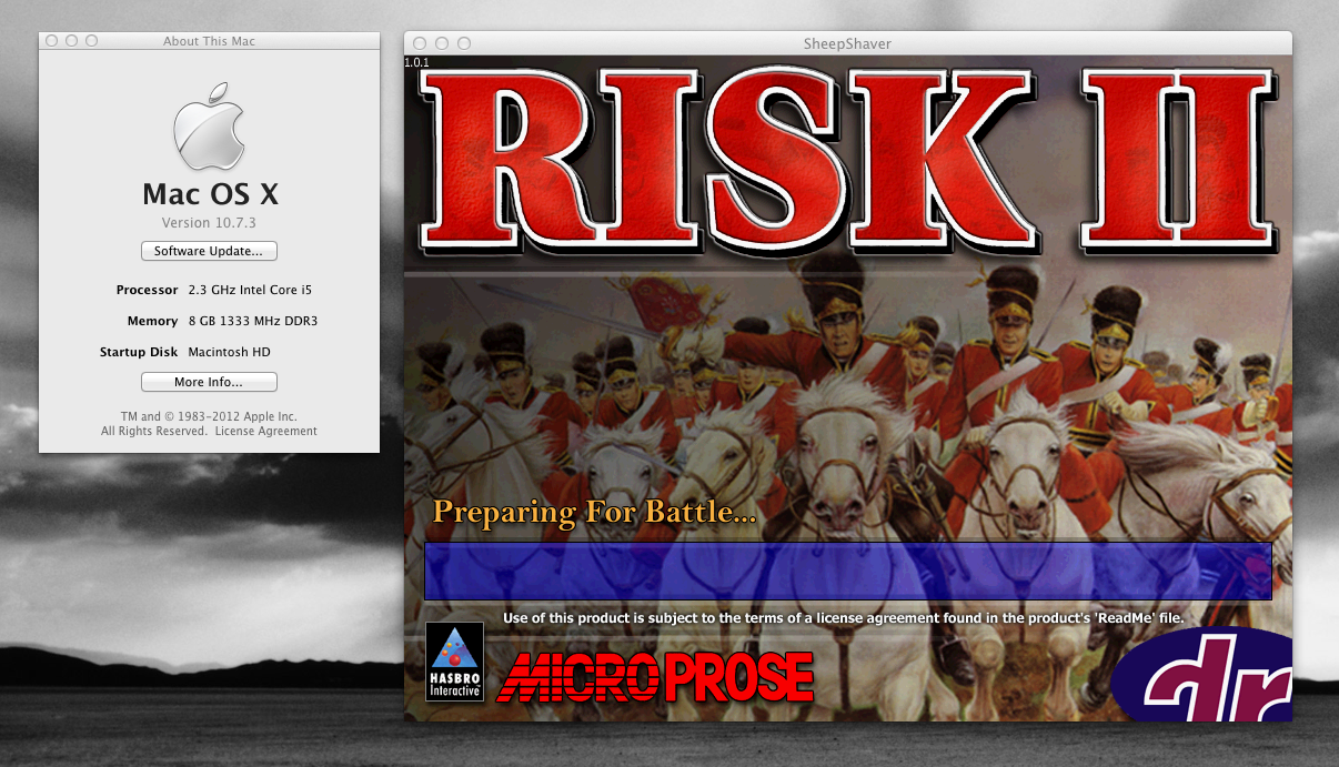

Tiger PPC included the Classic Mode; Tiger Intel had to abandon the Classic Mode as it now ran on an Intel CPU and not the older PowerPC CPU.
The only way to run Classic software on an Intel Mac is to use SheepShaver and it "all in one" bundled cousin, Chubby Bunny.
