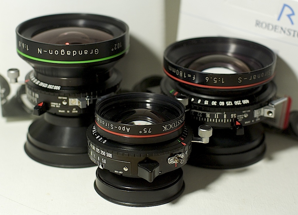

Or, for very cheap used, you could get lots of movements and lots of focal lengths:
