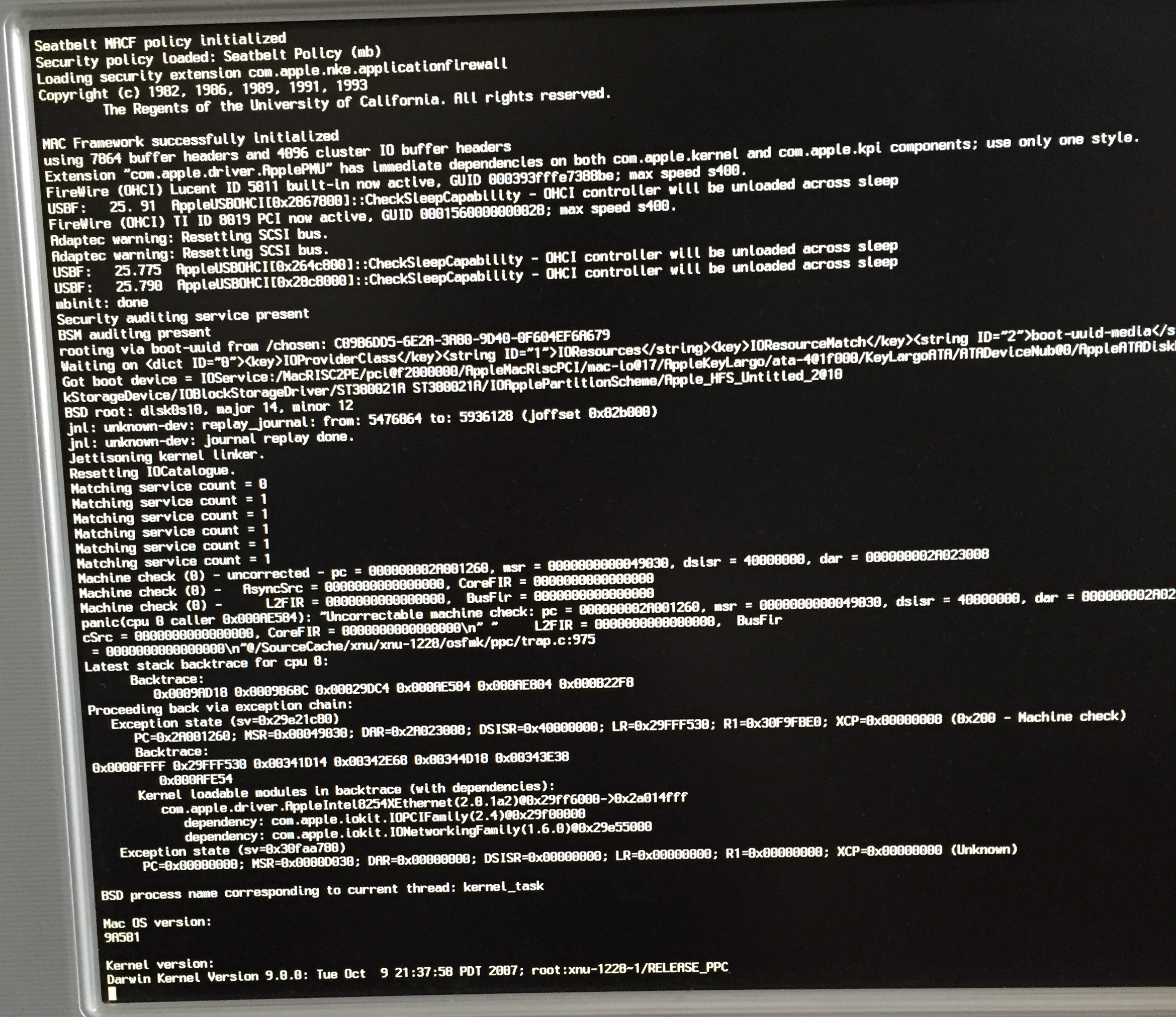

Okay, so as the thread title indicates, I installed Leopard on the DA via TDM, as I've done dozens of times on many computers, including other DAs.
Unfortunately, it still KPs on booting. I don't get a "text dump" either like I often get when it boots-the screen just grays out and I get the multi-language "you need to restart your computer" message.
I'll boot in verbose mode after I get back from church and see if I get any insight.
Does anyone "speak Unix" well enough to know what's going on here? I didn't even get the typical "we are hanging here" message that I'm used to getting. I do see a line that says "Panic..."Uncorrectable Machine Check" with some other text that I assume gives details.
BTW, the computer did boot okay into Single User Mode.

Do you have a SCSI card plugged in?
What happens if you try to boot with the SCSI card removed if you do have one?
Yes, there is a SCSI card at the moment, although I was getting KPs with Leopard Assist even without it installed. Even so, it wouldn't hurt to remove it.
It appears to not like your Ethernet.
There is a Gigabit card installed. Tiger seemed to have no problem with it.
Could this be the problem? Of course, I can always pull it also.
It seems to be a problem with a network card causing Leopard to KP. Try blocking that and see if it boots all the way.
I do suggest removing the third party card. Always best to make the machine as stock as possible when installing a new OS.
The machine is loaded with cards-GigE, USB 2.0, a combo USB 2.0/FW 400 card, and a SCSI card that I added.
I'll start with the GigE card since you all seem to think it's an ethernet problem. I'll take them out one by one and hopefully get it to boot.
I should add that this is not-in and of itself-a stock G4. The logic board, PSU, etc are all pretty much stock but it's in a rackmount case. I wouldn't think that would affect anything-it looks to me like all the original DA parts were used, including the front panel.
I pulled the GigE card and all is well. After Intell's suggestion of an ethernet problem and looking back over everything, I noticed that it mentioned a "Intel network", and I know that the chipset on the card is Intel.
I just find it funny that the card worked great under Tiger but caused problems under Leopard. When I say that it worked, I don't just mean that the computer booted off it, but that I actually used the card for a network connection.
BTW, I've heard that the onboard "gigabit ethernet" in most G4 towers will actually benchmark to less than gigabit speeds. Does anyone know if there's any merit to this statement? I'd think that a PCI GigE ethernet card would be bottlenecked by the PCI bus.
The one in this computer was full 64-bit length and PCI-X compliant, so I would think it would work well under those conditions(provided that one didn't have a PCI card in the PCI-X bus). The G4, however, just has standard PCI slots.
