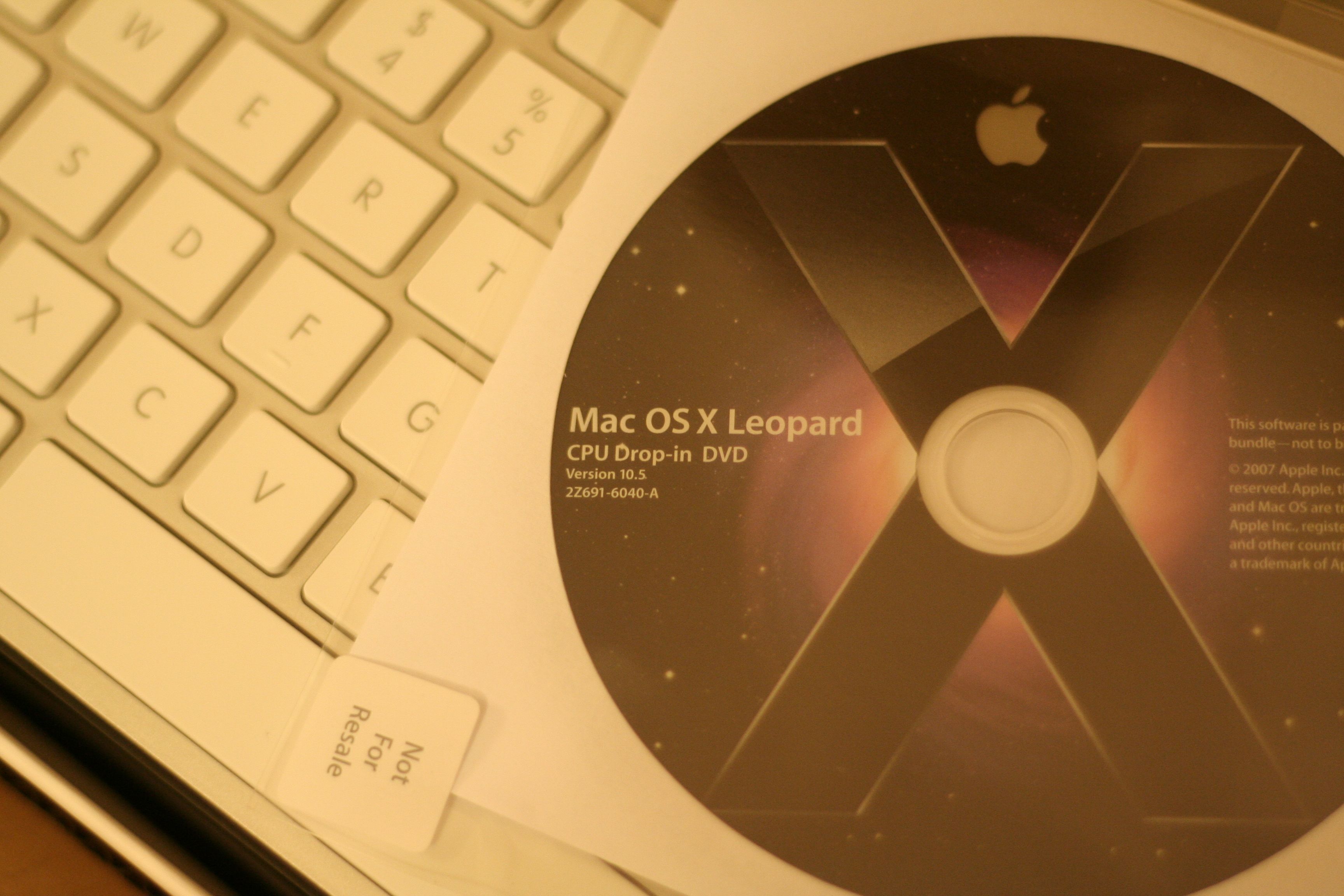

good news for everyone considering to buy a mac before they start shipping them pre-installed! separate install DVDs!!! this is mine which came in the 24" imac.

What are the differences between the drop-in disks that come with newly ordered Macs and regular single user license discs?
(I just ordered an iMac online (so I'll be getting a drop-in disc) and I was just wondering that if in the future, if I ever have to flatten and reinstall would I need to install Tiger first and then use the drop-in disc or can I just use the drop-in disc as if it were a regular single user license Leopard disc?)
There's a chance the Drop-in disc will look for a previous installation of Tiger.
I've heard varying reports from previous versions. I've clean installed using my Tiger Drop-In disc on a Power Mac G3 since I had a site license.
My dad got a new imac tonight, so I tried his drop in Leopard DVD with a MDD 867 PPC Mac (1.75 GB Ram, ATI 9600 Pro) and it hung the system. I tried it with a freshly formatted drive, but the installer says you need 10.4 installed on the volume. I also tried it with another drive with 10.4.10 installed, but it hosed the OS on that drive (lucky I didn't use my primary drive!). I may try again in the next day or two.

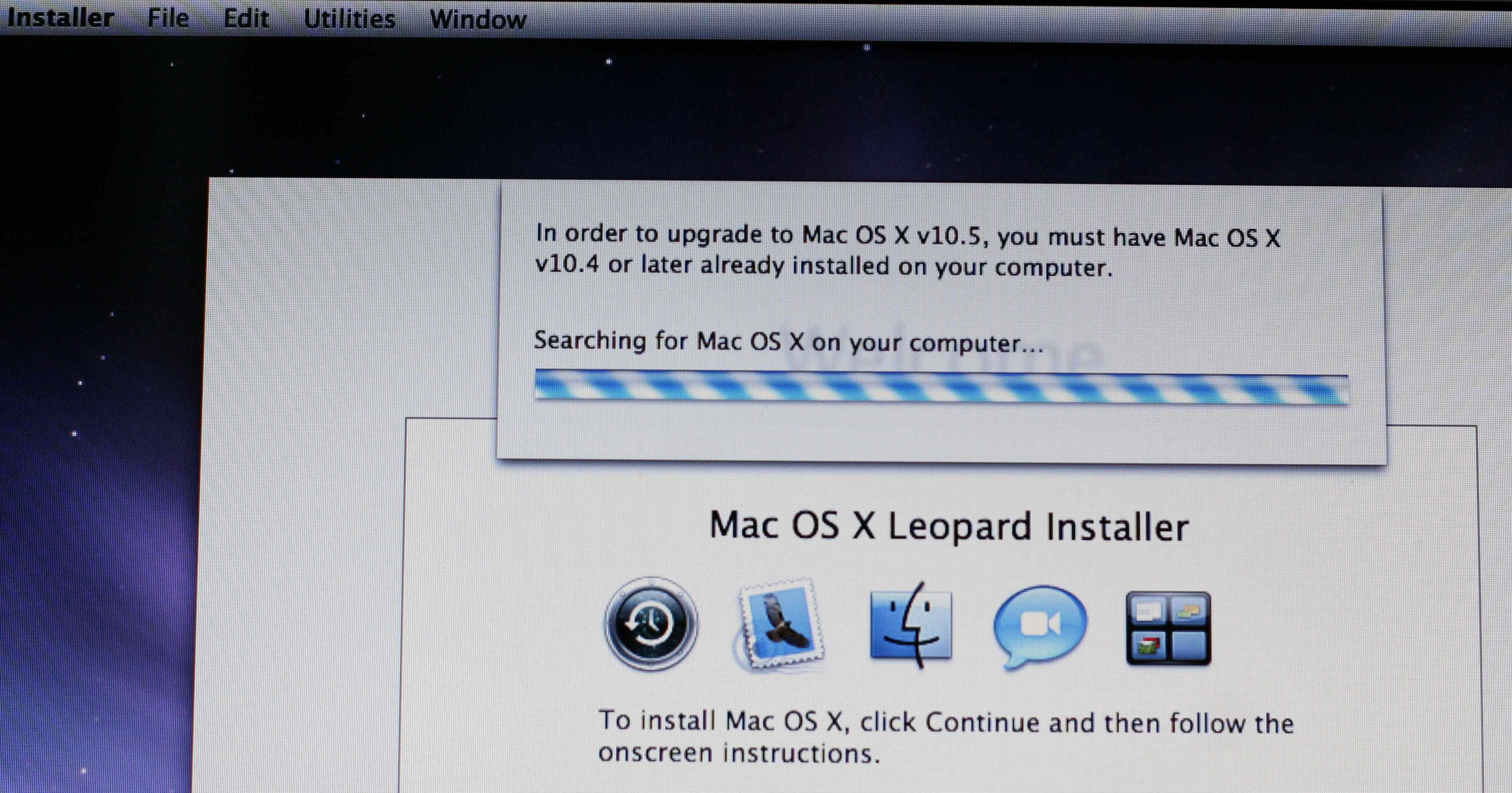

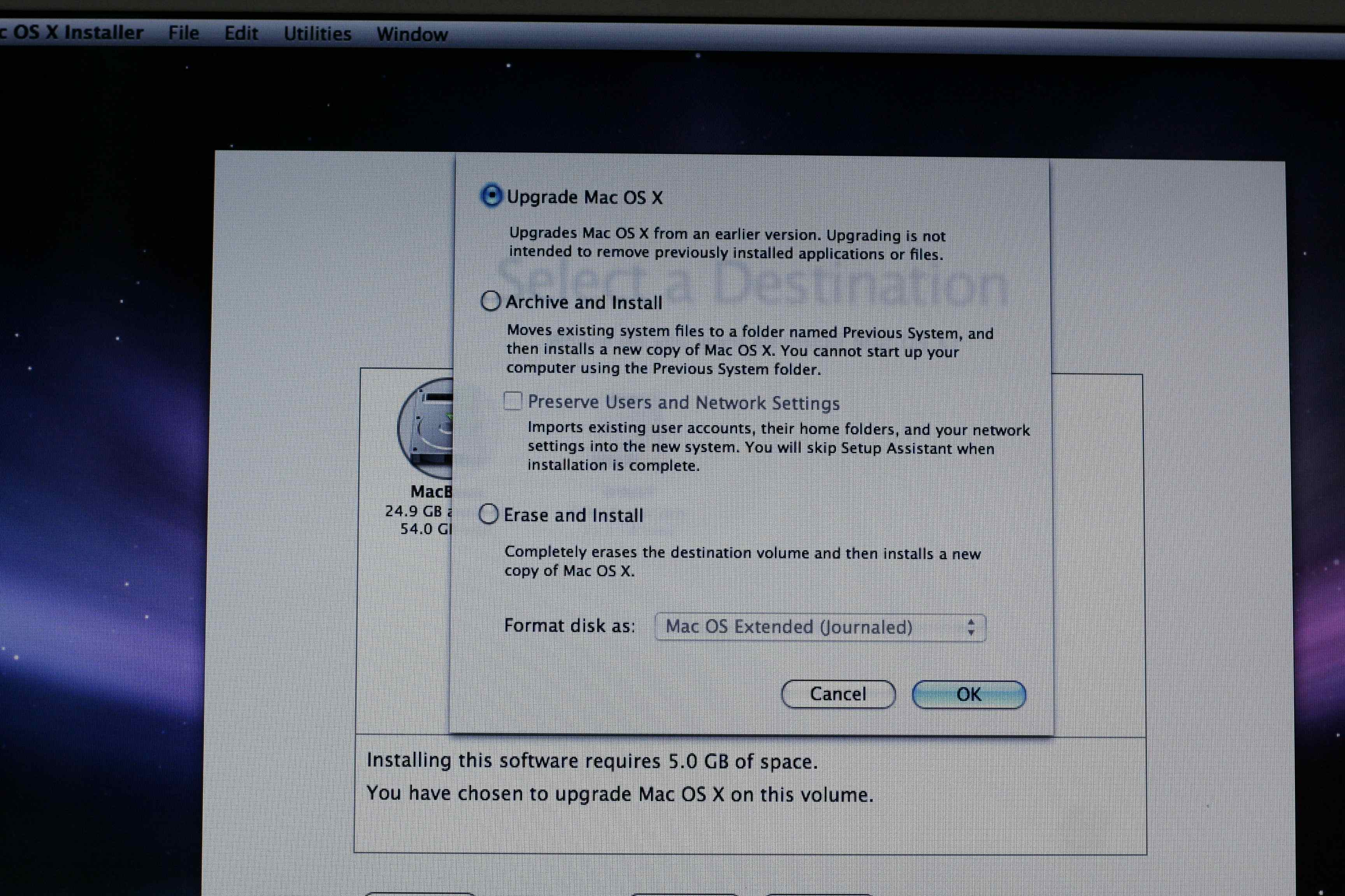

great news, i can confirm the drop-in DVD Leopard disc provide option to Upgrade or Erase & Install. The only thing is it will check that you have a current 10.4 installation onboard.
also, unlike the restore discs that comes with the computer, these drop-in discs aren't tied to that specific model. My friend bought a MacBook yesterday as well and she received the exact same drop-in disc.
