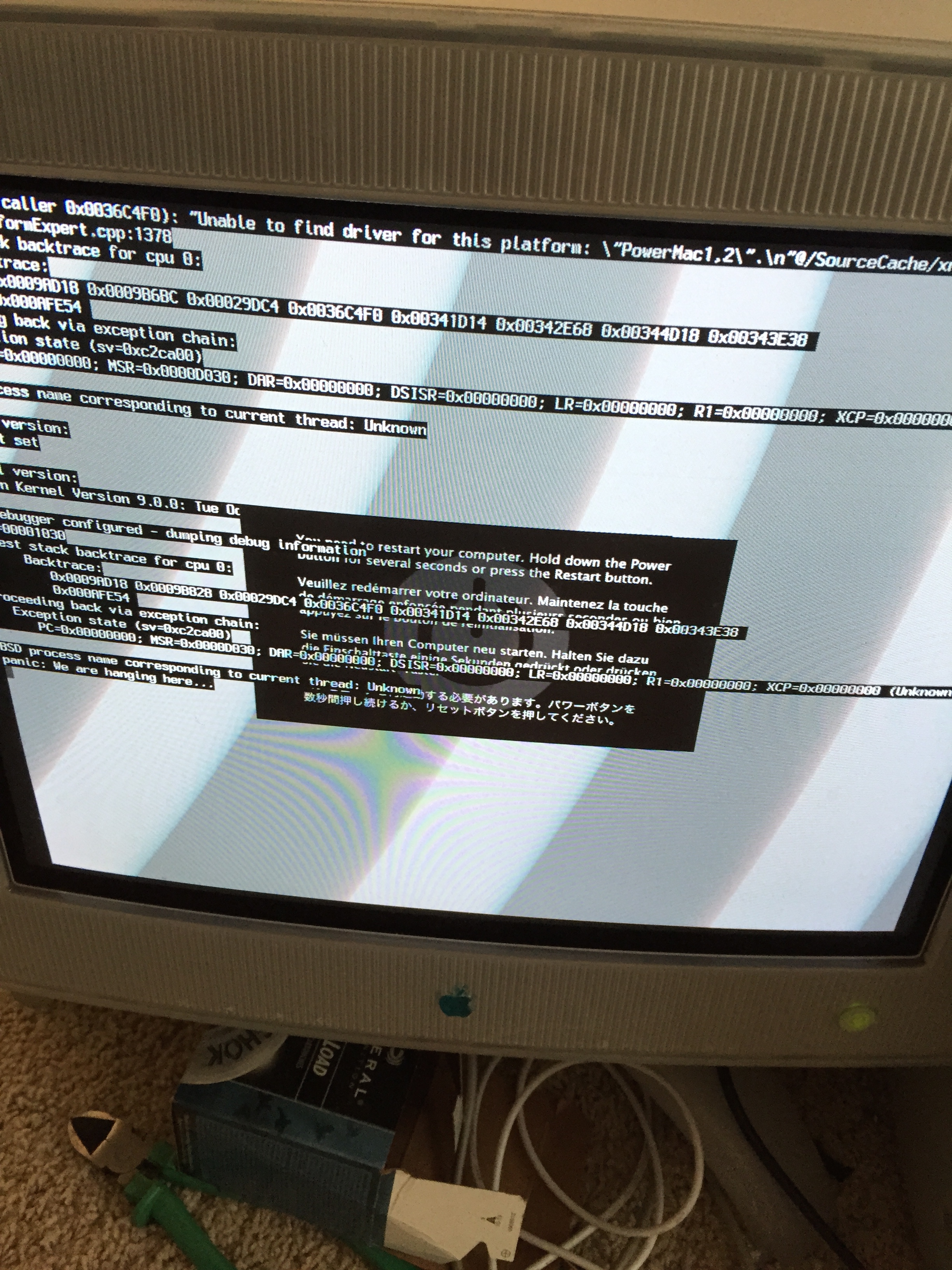

Someone asked about this a week or two back, and I speculated that it probably wouldn't work with the common tricks like Leopard Assist or swapping hard drives. I was basing this on my experience with attempting to install Leopard on a G4-upgraded B&W(which essentially is a Yikes! with an ADB port).
In any case, I just tried swapping hard drives, and can confirm that a plug-and-play install does not work.
I'm sure it can be made to work with similar techniques used on other PCI based Macs, which involve installing additional kexts from a couple of pre-releases of Leopard, but it's not as simple as installing on an AGP-based G4 Mac.
So, for those interest, there's my report.
I may tinker with it, but don't have the time or inclination right now(perhaps after my thesis defense on the 17th...)
Here's the KP screen on booting, which is the same as I saw on my B&W

using the kexts and the PDF I linked in another post it is possible to boot leopard on a Yikes/G3 B&W (I did try boot leopard in an emulated Grakle PCI mac and I got the same Kernel Panic you did about a missing platform driver once i installed the kexts i got past that point but then it couldn't find Root Device and stalled I suspect this is a fault of QEMU as the sawtooth emulation has the same issue)

for me to get the kexts to load I had to install xpostfacto on my leopard disk... otherwise i still got the Unable to find platform driver for Powermac1,1 kernel panic (what I did was install the needed kexts for leopard then I install xpostfacto on the disk let it do its thing and then booted on the grakle PCI mac)
