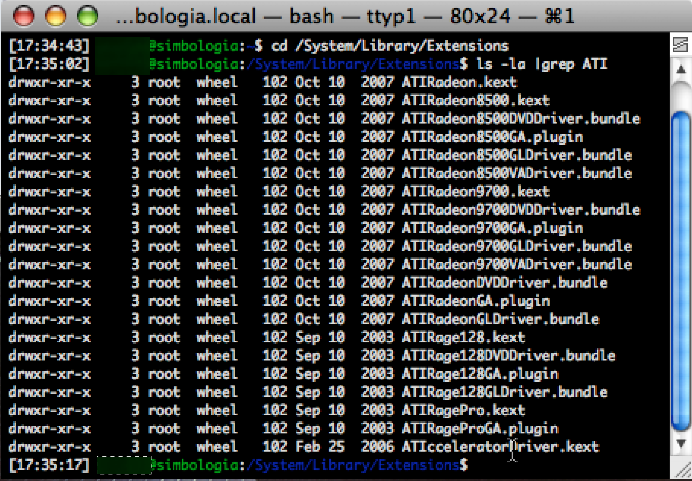

This is what I have:
what happens when you manually load the kexts with kextload?
keep in mind even with the Rage 128 kexts loaded, the UI will still run like crap theres no getting around that, it just might run slightly less crap, but still like crap LOL
if your using the 9A343 kexts you should have OpenGL working, so try opening OpenMark or such, if it opens and does not display and error then the 9A343 kexts are working 🙂
