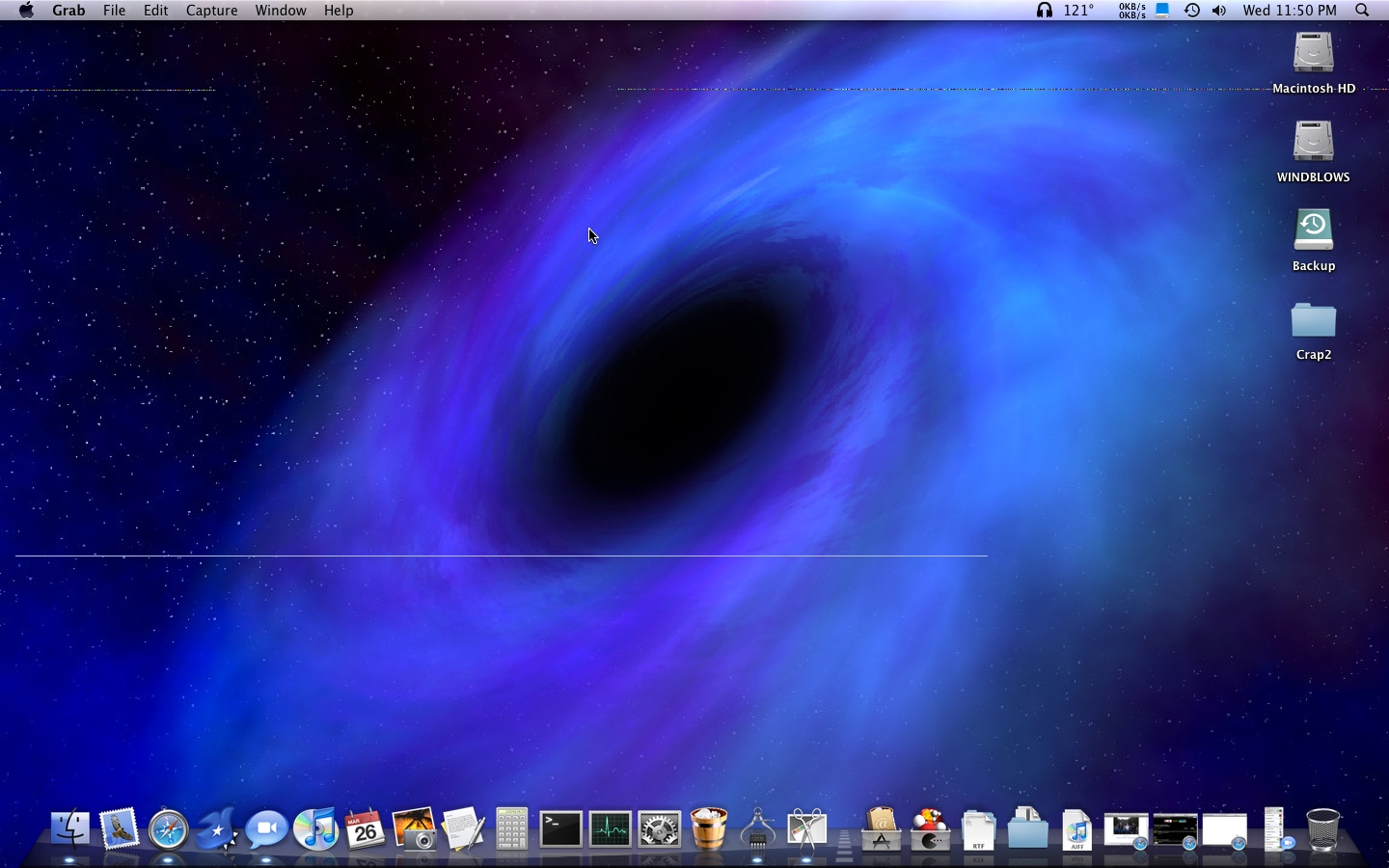

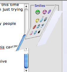

So I was having screen artifacts, and randomly my screen would just go black. The computer was still running, because any Music I was listening to etc..., would keep playing but I couldn't see the screen. I replaced my RAM about a month ago (was upgrading anyway), and both problems seemed to go away, until recently. I way doing a screen sharing session with a friend about a week ago, and my screen went black, we were still connected, and he said that all he saw on my screen was a mess of lines and static etc.... Im also getting the artifacts again, and some windows are getting distorted when dragging. Im assuming that the artifacts, and the black screens are related. I don't know why it started happening again, but Im getting kinda annoyed! The computer has also froze 2x today while moving the mouse around in the dock/stacks kinda fast, I didn't get the black screen this time just freezing. I've been reading the discussion on Apples site, and people are saying Leopard is frying the Graphics Cards. Im just trying to figure out exactly what is to blame here?
Is my Graphics card dying, which I think is unlikely since so many people are having the artifacts
Is it just a driver issue with Leopard
Or is Leopard (specifically Core Animation) just pushing my Graphics card too much and causing it to overheat?
Right now my GPU temp is 76C 169F, with nothing graphics intensive running, just OS X it-self. Is that too hot? What temps are you guys getting with your X1600s?
I have a 1.83Ghz Core Duo iMac with an X1600
Here are some screenshots. Am I correct in assuming if it was actually Hardware related that I wouldn't be able to see the artifacts in screen shots?
Sorry for the long post, Im just getting really annoyed 😡 I was hoping 10.5.2, and the Graphics Update would fix this, but apparently not!

Well this is interesting. I just installed Tiger on an External HD just for troubleshooting, and the default fan speeds in Tiger are the same as Leopard, and my GPU is running at 76 in Tiger too. I also got some artifacts right after I installed Tiger. I don't exactally know what to make of this.
EDIT: Well Im back in Leopard, and Im at 62C with the fans turned up, which is good. Still kinda confused, but hey if ti works Im happy. 🙂

That looks exactly like the artifacts I saw on my 20" Core Duo iMac when the logic board failed. Actually, it may have been the GPU that failed but the only repair Apple does in such a situation is total replacement of the logic board to which the GPU is attached. Someone suggested at the time that excessive heat may have caused the GPU to work free and lose it's proper connection to the logic board. I have no idea since Apple never tells you what the problem is. They just do the replacement.
I started seeing those lines on the desktop right after startup and then the machine started freezing. Eventually it got so bad I couldn't get the machine to boot into OS X at all. Strangely, Boot Camp XP worked fine.
The worst part was the machine was 6 weeks out of the one year warranty and I had passed on Apple Care (never again!) and I ended up shelling out $500 for the new logic board.
Don't Say That!!!!! I can't afford a new Logic Board right now (or for quite a while TBH) So far smcFanControl seems to be doing the trick, lets hope it stays that way.
Well, of course you may not be in the same boat that I was at all. I am hoping that in your case it is just overheating.
One thing you could try is to clean the vents and de-dust your iMac to the best of your ability. Dust buildup in the tightly enclosed chassis is a common problem and can lead to fans functioning at less than their ability.
