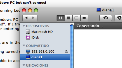

A couple of hours later the Vista laptop showed up all by itself (under SHARE) as a computer, not as a server (someone please explain to me what's the difference between this two) whith a CRT bluescreen icon and the laptop network name. But I couldn't access this one either. Same problem as before. (see Attached Thumbnail)
So, same laptop showing up twice under SHARE; once as a mounted server that I can't eject, once as a "computer"; but I cannot access either instance.

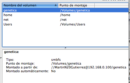

Attached is an image of the volumes shown in System Profile. "genetica" is a folder I set to "shared" in Vista just to see if I could see selected folders from the Mac, which I could for the short period the "server" instance was accessible.

When I turned it back on It started whithout delay but the volumes were no longer showing under SHARE in the side panel. I kept working on other stuff for a couple of hours and when I came back to the Finder I found the volume "diana1" had came back and was working just right.
When I click on it I get connected as a guest and I can see Public and Users shared folders. I had changed the "genetica" folder sharing status in between edits of this post and now it's not showing up anymore. Besides, the mounted volume is showing the eject icon which was lacking before the restart.

Shared volume got stuck again so I started searching again and I found a couple of things that may be of help.
First I learned something about force unmounting stuck volumes but I guess it won’t work with stuck SMB shared volumes...
http://www.macosxhints.com/article.php?story=20020426083026328
http://www.creativetechs.com/iq/cant_eject_a_disk_find_which_files_are_open.htm
I found the latter particularly helpful for future use.
Now, there are some procedures that may be better than rebooting, shutting down or, in my case, hard resetting...
https://forums.macrumors.com/threads/530028/
which basically says:
1. Run "lsof" in terminal
2. See about what smb mounts it complaints
3. sudo umount -f [any_failing_smb_mount]
Be aware though, that unmounting a filesystem using the force flag may produce unexpected results, but I guess it's better than hard resetting the Mac and thus hitting the HDDs every day ;-)
http://episteme.arstechnica.com/eve/forums/a/tpc/f/8300945231/m/259004456931
which goes through a couple of simple procedures being the more convincing: “(performing a) sudo umount -f /Volumes/Share followed by a sudo rm -df /Volumes/Share dispatches the zombie volume, and I can re-connect without all that Sharename-1 rubbish.”
At the bottom of that thread there’s a mention to “TCP keepalive” as a possible solution to this problem and a brief mention to the cause being a network failure. That would make sense with the fact that the laptop I’m networking goes to sleep after a while, and that could be taken as a network failure causing the “zombie share”. If that’s the case I would be forced to turn on and off sharing from System Preferences each time I want to share files with the laptop as it connects itself whenever file sharing is enabled, just to become a zombie when the laptop goes to sleep.
