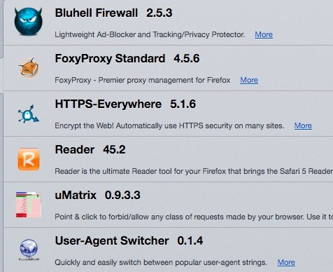

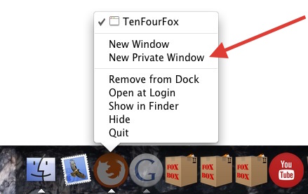

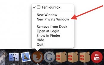

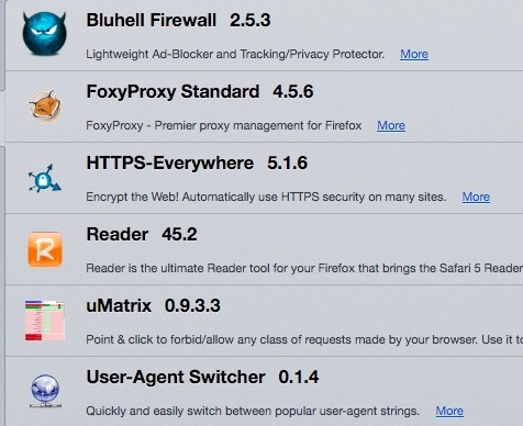

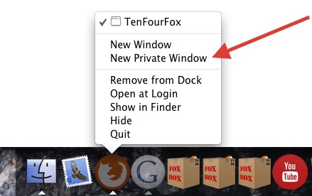

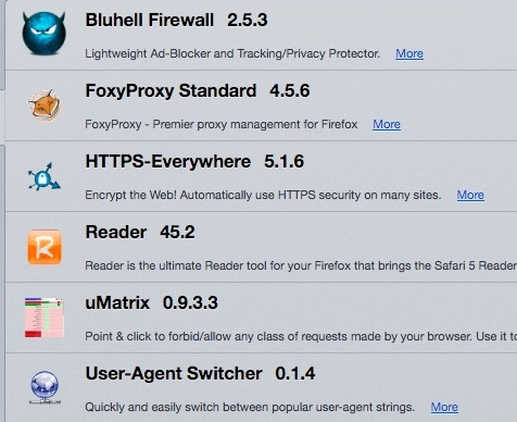

TenFourFox (TFF) is my default browser with some speed & security add ones and tweaks. TFF supports proxy settings allowing me to use TOR vs needing to change the system proxy (causing unwanted traffic to be routed over TOR). However there are times when flash is needed and that's where WebKit with my hacked version of Flash comes into play. Like TFF a select group of add ons are installed to enhance security.
Yeah I tend to get the concepts of privacy and security mixed up sometimes. I've never tried onion routing as I haven't thought it necessary for anything I do online. In terms of privacy I'm one of those irritating people who thinks they have nothing to hide ;D but in terms of security I'm not sure how exposed I might be to be exploited somehow on certain sites that can readily be accessed from Google etc.
So far I'm not finding a straight TFF counterpart to Safari's private browsing. I suppose the privacy settings at the TFF preferences could be used.
Can you recommend any of those TFF addons?
Are the Firefox addons that are linked from the TFF front page supposed to work on TFF?

Because most extensions slow down your browser I try to minimize the number in use on my PPC machines. On my PowerBook the follwoing extensions are used in TFF
Although there are 6, you only need three to help secure your browser - Bluehell Firewall, HTTPS-Everywhere and uMatrix. And yes these are the same extensions avaialble for Firefox.
