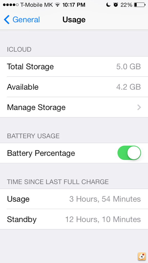

So, just got my 5S October 9th, and I always see the battery go down. I've supplied a screenshot:
It's already down to twenty and I just took it two minutes ago!!!
The provided information is pretty useless. You haven't told us:
  • how you use your iPhone
  • what settings you have on (e.g., background app refresh, parallax, location services, etc)
  • how your signal/coverage is during the day
  • your battery charging habits (e.g., always drain down to 0%; charge overnight)
Also, you're showing us your usage with almost a quarter of your charge left.
Less than usual battery life
I Apologize for the lack of information i gave. Here's some more:
Parallax: on
Background refresh: off
Location services: on for find my iPhone
Wifi always on
Bluetooth on maybe ten minutes a day
Four to five dots all of the time.
Usually discharge to around 40 then recharge overnight then leave it off charger for the rest of the day.
That any better?
Also, battery down to 14% now. Going to recharge it overnight.
