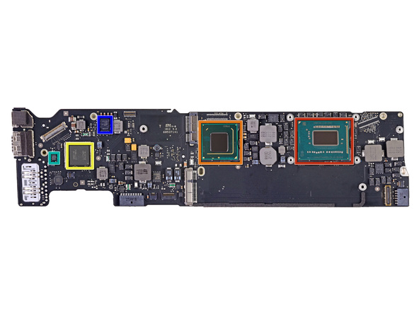

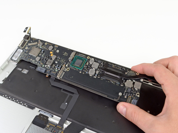

I don't think you even bothered to look at the iFixit presentation of the MBA board. the CPU and TB controller are on opposite sides of the MBA. This whole close proximity to CPU thing is smoke.
tjBDmrcNjDPUwOTI.medium
The TB is near the platform controller, which controls the PCI lanes and graphics in the Macbook Air.
I've also heard rumblings that Thunderbolt does require support in the CPU. That one doesn't make much sense to me, but the sources I've heard that from would normally be reliable and in the know. Something about how even though Thunderbolt just uses PCI lanes, the CPU has to be aware of which PCI lanes the Thunderbolt controller is on.
Not sure why you used that picture. Here is the more direct one.

Thunderbolt controller in yellow on the left. The CPU in red on the right.
Yes the orange IO Hub /Platform controller has the source of the PCI-e lanes the TB controller is "consuming". For this generation the video is routed out of the CPU and into the IO Hub. Future generations the video will likely come straight out of the CPU+GPU package.
If the TB controller , IO Hub, CPU , and GPU were all combined in one package it would "land" where the TB controller is now. That other stuff would either disappear inside the new package or get moved into the now far more empty spaces left behind.
