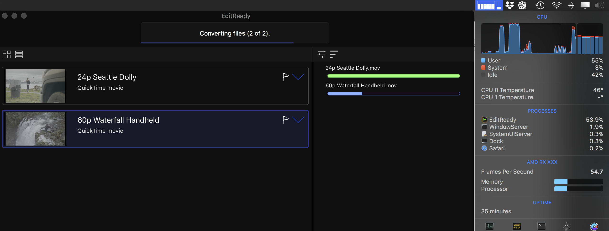

Did a little test today, and transcoded two H265 GH5 clips with EditReady, a very well optimised program.
I don't know how to interpret the results though. It looks like the GPU (VEGA) kicks in and transcodes basically realtime
BUT maybe it's just the program being GPU-optimized? That wouldn't necessarily mean H265 hardware transcoding...Would it?
[doublepost=1516199380][/doublepost]Test on a test-system with 6 Core, and 1 x RX VEGA
If you mean that 54.7FPS, that's nothing to do with the conversion rate.
If it can transcode in real time, then it should able to finish transcode a 1 min long video in 1 min time.
I just downloaded it's free trial version. The CPU usage is same as your screen capture, which is actually low if compare to ME, FFmpeg, or Handbrake. My GPU occasionally kicks in, VRAM usage definitely increased, may be because OpenCL is enabled. But since I am not using the Vega now, can't tell if any hardware encoding is enabled.
I am more thinking about the "Processor" in iStat.
And I timed it, so it is a tad faster than real-time. But I don't really know if this is to be expected.
That's interesting, even a relatively low res H265 video, it's still pretty hard to finish encoding in real time with that CPU usage.
I use the trial version to transcode a h264 video to h264. And it takes 8.5 min to finish a 57s 2160x1080 video (2 vertical 1080P video SBS). So, it definitely no hardware acceleration on my Mac (that's expected with the Nvidia GPU). If your Mac can do H265 in real time, that's almost sure hardware encoding is being used.

I wonder if EditReady is optimized for Polaris as well as Vega? Will test and report back, most likely not optimized though.
[doublepost=1516230408][/doublepost]
I also used the trial version to transcode A 2 min (1 minute limit) H.264 GH4 test clip to H.265 And stopped it around 5 mins. iStat reported miniscule GPU usage and average memory usage. This is a sign that there is no hardware HEVC support in macOS for Polaris ATM. (Pretty sure this has been tested before with Polaris, but wanted to put my suppositions to rest 🙂 )
Reactions: h9826790
Quickly testing EditReady before I call it a day. It's going to be MUCH longer than 10:1 for HEVC/H265 encodes. Already passed the 10-minute mark that it's been running. The trial only encodes 1 minute of footage. According to the progress bar, seriously looks like it has 90% of the way to go still. Will leave running overnight to get an actual time, but would not recommend EditReady for HEVC/H265 encodes over Adobe. Absolutely is not optimized for GPU (at least NVIDIA) and seems much less optimized than Adobe for CPU as well.
EditReady ended up being almost 47:1 for an HEVC/H265 encode with same test file. Would have been around 141 minutes for a full 3 minute vs. about 30 minutes for Adobe Media Encoder CC 2018. May test Apple Compressor next week.
