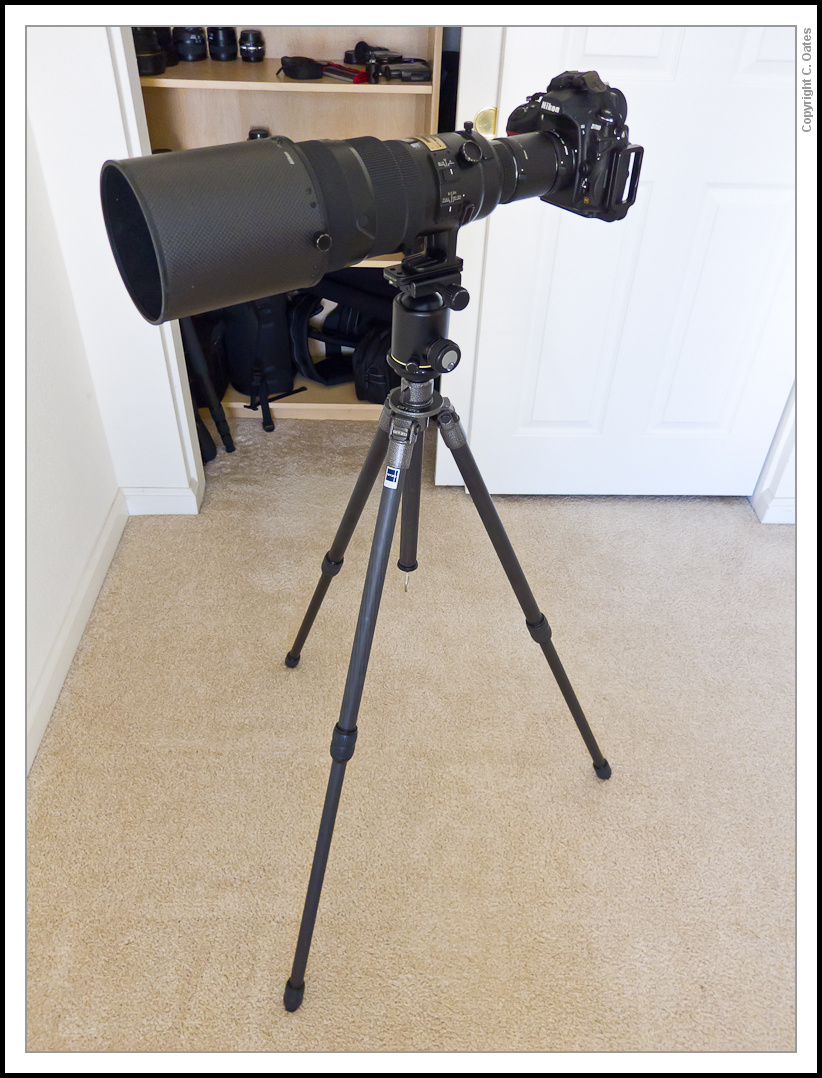

FWIW, Gitzo 1127 legs with an Arca B1 head. I have had both for around 8 years. The legs are pretty much at their limit with the pictured 300/2.8 lens and a set of Gitzo Series 3 legs are on my wish list. I use both RRS and Kirk plates.
If I had to do it again I would have gone with 4-section legs for a travel tripod like this one. These will fit inside a 22" carry-on, but only if I remove the center column. 4-section legs would be an easier fit.

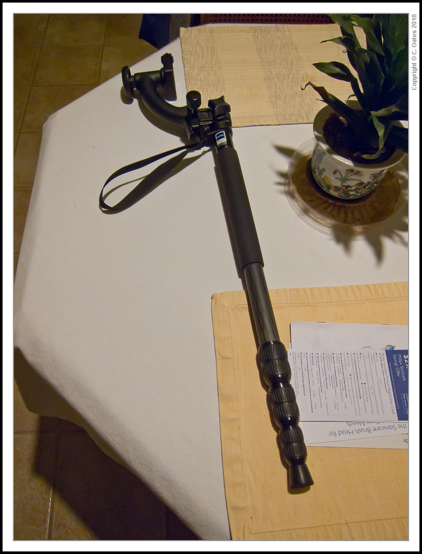

I have a Gitzo 1568 monopod with the 234RC bracket and a RRS clamp. When shooting with the 300/2.8 I flip the bracket over 90 degrees and attach a Wimberly Sidekick to the clamp. I have found it works very well.
