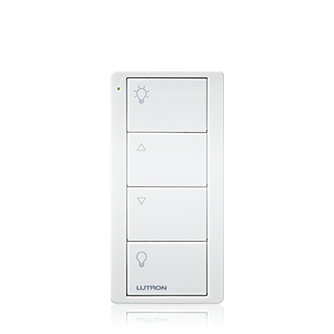

The solution I went with is using the Lutron Caseta dimmers and switches along with a Wink hub and Amazon Echo. (Yes, I have a bunch of systems hobbled together.)
My kitchen is a good example. It had two switches controlling the ceiling lights (task lights and center light). I replaced the task light switch with a Lutron dimmer so now it had a wall switch and smarts in one package. Next I hard wired the center light and removed the original switch. In its place on the wall I added a Lutron remote control.
In the light fixtures I put a Hue lamp in the center and regular LED (not smart) bulbs in the task lights. The Hue is always on and controlled as a normal smart light. The task lights are dumb bulbs that can be controlled at the wall switch or through your smart app. The buttons on the Lutron remote can be programmed (via Wink in my case) to do whatever I want - including turning the Hue on and off.
So one option is to hard wire the light with the Hue bulb and replace the switch with a Lutron remote. In that case the Hue will always have power and the remote will let your guests "manually" turn it on and off.
For reference the dimmer switch looks like this:
The remote looks like this:

[doublepost=1491479372][/doublepost]Last question. So I'm debating between the Lutron Pico and the Lutron LZL-4B-WH-L01 (the one pictured above). I like the idea of the Pico having a favorite setting so I can quickly set my Hue lights back to the default, normal bulb setting. My question is, with the Pico, do I have to purchase the in-wall Lutron switch for it to work or will it work like the one pictured above without a switch?
For starters, on the three switch faceplate I'm going to replace, one switch is to my overhead fan, one switch is to the lights in the fan (non-Hue), and the other controls the can lights (HUE BULBS) in my living room ceiling. So my plan is to replace the fan with a smart in-wall switch, the fan light switch with a smart in-wall switch, and the can Hue Bulbs (BR30) with the Lutron remote. I'm going to hard wire the Hue Bulbs so they are always on. So in the end, on a three-piece faceplate, I'll have two in-wall switches and one remote. Is that the way it should work?
