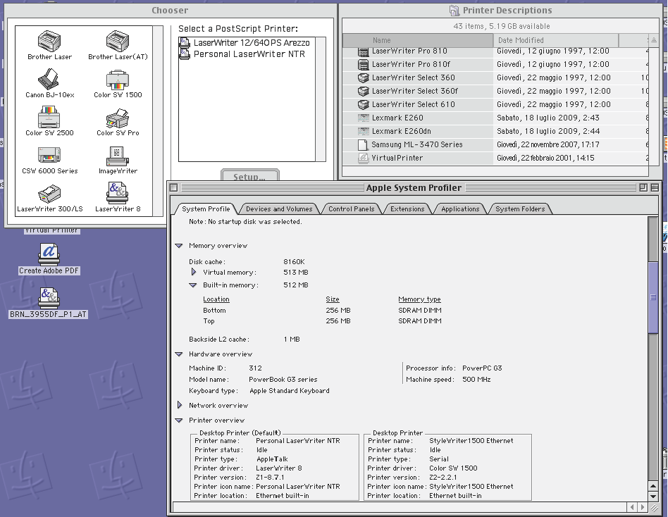

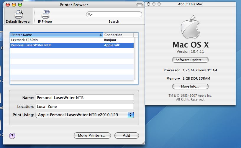

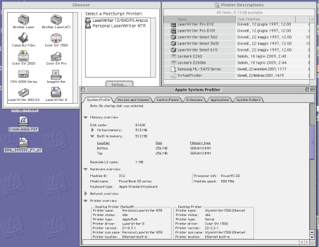

These are the situations, from a PowerBook G4 running OS X 10.4.11 I can see the Lexmark, along with other AT printers, while from the PBG3 (this is a Wallstreet with the Bluechip processor at 500 MHz) running Mac OS 9.2.2 I can only see the Apple printers. The printer description files are correctly in the Preferences folder. What is missing?
tried everything on a series of different Macs from system 7 to os9.2.2: the printer, although set up as apple talk, is not seen by any mac running less than OSX, who knows?
SOLVED
You need to check the queue name from a Mac running osX and then create a desktop printer with Desktop Printer Utility and type the queue name and printer IP. Then it works
