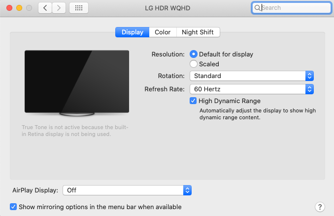

Hi All. I have yet to do more digging in this subreddit but figured I'd post anyway as I do my digging. If I could get some assistance, it would be greatly appreciated! I purchased the following monitor: 34WK95C-W to pair with my 2020 MacBook Pro. The monitor supports USB-C and so that is what I am using to connect the monitor to my MacBook. The issue I am having is that the resolution on the monitor is still not what I expected as in the text in every app is still pixelated/fuzzy. It's not "retina"/crisp like it should be.
The resolution of this exact monitor is 3440x1440. It's a 34 inch 21:9 Ultrawide. I went to the Display settings under system preferences and set the resolution to "Default for Display". I also tried "Scaled" and set it to the max of 3440x1440 but no change from "Default for Display". I did notice that the LG monitor has a setting named "Super Resolution +" which is grayed out. Was told by the LG rep that the reason its grayed out is because the Macbook sends a set signal to the monitor. In other words, the Macbook is disallowing the "Super Resolution +" setting on the monitor. Any ideas how I can get a crisper picture? Is there a program out there that maybe I can use to upscale? Or am I just not understanding the compatibility between this monitor and the Macbook in terms of resolution? Again, Any help would be appreciated!

Thanks for the reply! Are you referring to the settings on the monitor itself? If so, those are very limited. Not sure how I would go about doing that. Or is there something on my Macbook that I need to do? Thanks
Try turning off HDR?
Hold the option key and click Scaled?
Post results of /System/Library/Extensions/AppleGraphicsControl.kext/Contents/MacOS/AGDCDiagnose -a > "AGDCDiagnoseMacBookPro2020.txt" 2>&1 It will tell us the actual output resolution and pixel format (macOS does not report these).
Try SwitchResX? Show us a list of the Current Resolutions.
I think Super Resolution + should be off for best results.
Unfortunately 3440x1440 @ 34” ultra wide is not a retina-quality resolution. I have the LG 34WN80C-B connected to a 2019 MBP 13 and the display is running 3440x1440 @ 60hz over USB-C and the display is not (and physically cannot be) as sharp as the laptop’s built-in 2560x1600 13” display. That being said I’m a huge fan of the display and at my typical viewing distance I‘m very happy with the sharpness vs real estate trade off.
The MBP display is 227 pixels per inch, 34” ultrawide 3440x1440 displays are ~110 ppi.
