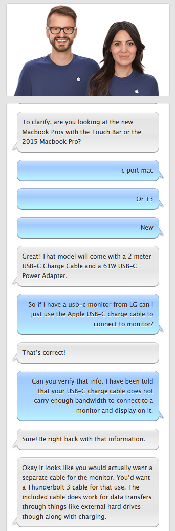

Are you using a "proper" USB-C cable and not the charging cable that came with the Mac? That won't have the bandwidth.

No sure wasn't and no one at Apple, LG, or Micro Center suggested this was the problem. You would think Apple would have released that information sooner than 11 days ago. They are still telling people that Cinema Displays with mini display port connectors can be used on the new MBP via T3-T2 connector. Which it can't. And, as I just found out as I am writing this, Apple is still telling people their charge cable can connect to monitors for display purposes.
