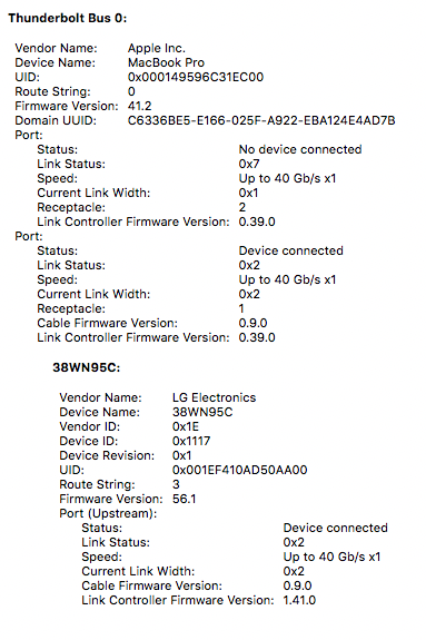

Thanks for the reply. How do I change the Displayport Version? Is it based on the cable or a setting?

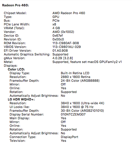

Here are the settings for TB3 and the Radeon Pro 460 shown in the system info

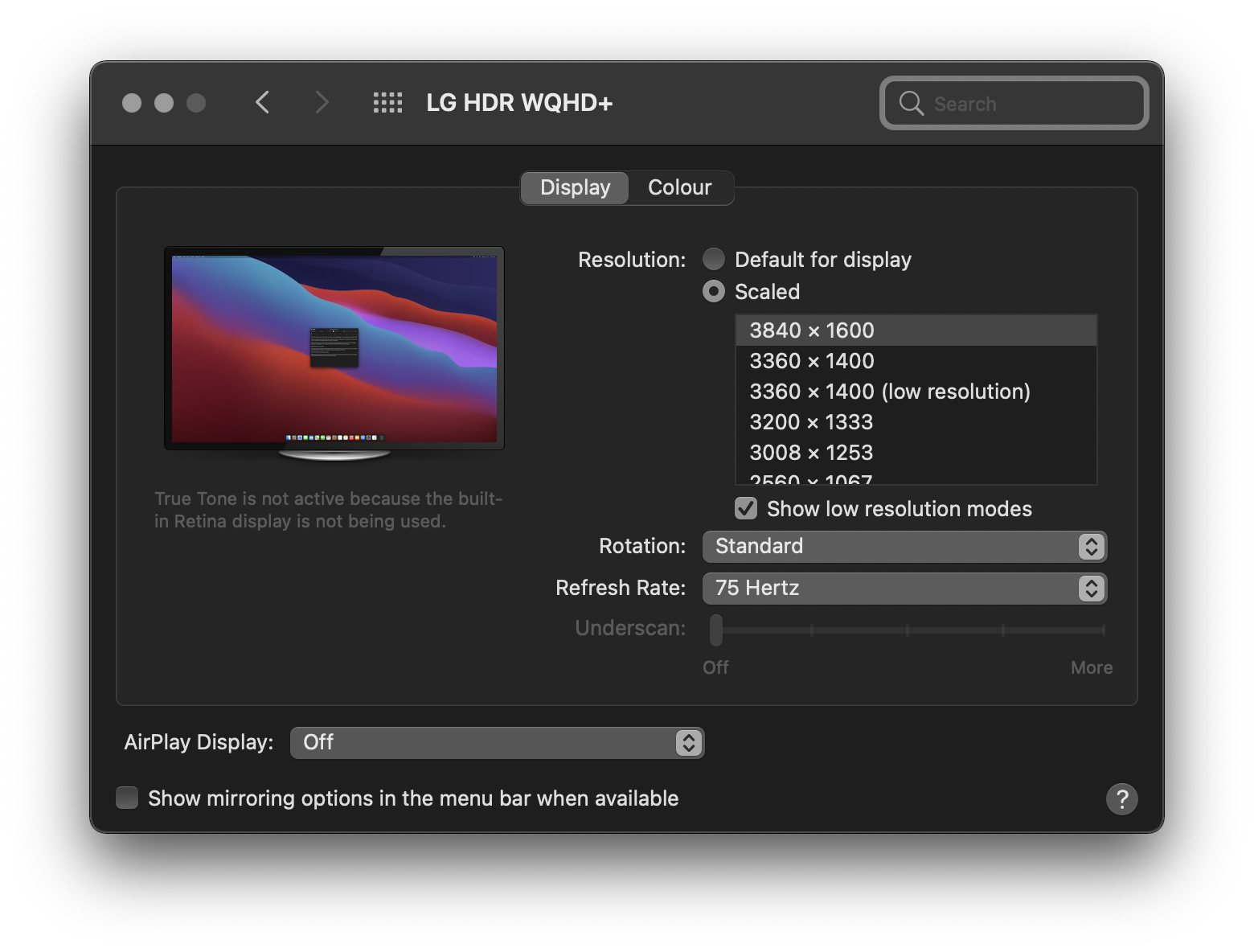

I have contacted Apple support with the same question. (I have the same LG monitor) The official answer is that macOS doesn't support anything above 60Hz. They even told me it's strange I am getting 75Hz at all, as the system should be capped at 60Hz. Not sure, if they just didn't feel like helping me out...
I can see you got it to 75Hz as well, so it is possible to get higher than 60Hz. However, this seems to be the official answer... no 144Hz.
Edit: I have the 2019 MBP 16", so I assume it should have DP1.4. If that one doesn't have it, not sure which one does.
The only thing we can get from that is that the Thunderbolt connection is working at 40 Gbps instead of 20 Gbps so HBR3 is a possibility (except your Thunderbolt controller will only take HBR2 as input).
To determine the Thunderbolt controller type, you need to see the PCI ids of the Thunderbolt devices.
2016 is prior to Titan Ridge so it's probably Alpine Ridge. Or 2016 is the first Thunderbolt 3, so it's probably Alpine Ridge. 2015 was Thunderbolt 2.

Yes, I did. Although the option-key only works for resolutions, not for refresh rate afaik.
Out of curiosity, have you ever seen an Apple system running at more than 75Hz? Now that I think about it, even their Pro XDR display with all its awesomeness is running at 60Hz. The LG UltraFine (and other displays from LG for Mac) run at 60Hz. I don't see a reason why either Apple or LG would not go up to 120Hz apart from the system not supporting it. Mind you, all the "for Mac" displays cost way more than the LG 38WN95C that we are talking about here, so I don't think it's a cost issue.

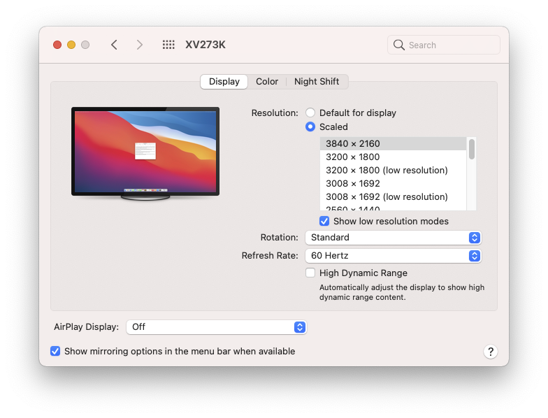

There is no limit in refresh rate in macOS. Click "Show low resolution modes" also.
View attachment 1687680View attachment 1687679
SwitchResX is useful because you can see which resolutions are just scaled resolutions or actual timings.

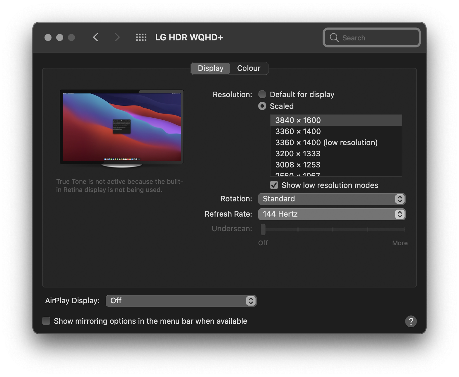

Ok, that is awesome. I never thought it is possible to get night shift, full resolution and high refresh rate. Acer does seem to have figured out how to support Macs... How is the monitor connected? Is it DP or TB? Maybe it's worth a try connecting the monitor over DP. I only had it ever connected over TB.
Ok, so I did some digging and now I am even more confused than before.

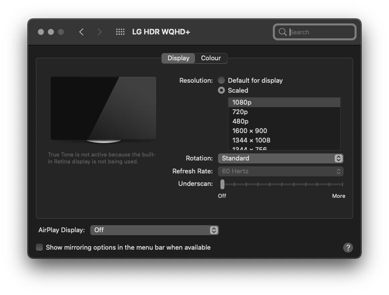

So I set the DP version on my monitor to 1.1 (it's connected with TB, mind you) and I get this:
Locked at Full HD and 60Hz, no surprises there. Then I switch to DP1.2.
Same as before, full resolution but only goes up to 75Hz. Then I go back to DP1.4 and then this...
I don't know why, but now I have the full resolution and 144Hz! Ok, that is weird. Still no Night Shift though, but some progress at least!
connection via DisplayPort or Thunderbolt doesn't matter - they both use DisplayPort. Thunderbolt could be limited to 20 Gbps if the cable is bad. In that case, the DisplayPort signal would be limited to HBR2 link rate.
DisplayPort 1.1 should be able to do 1440p 60Hz.
