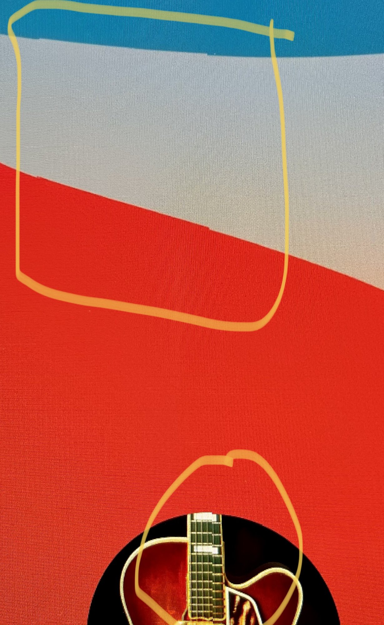

Is anyone else using an M1 MBP with the LG 5k display and experiencing these lines every now and then?

Yep (via a dock as well). Unplugging and plugging back in again solves it.

I experience the same with a new LG 5K running off an M1 mini. It’s pretty rare. I restart the machine to be rid of it. I haven’t tried unplugging and re-plugging. Guess we should at least report it, as the monitor’s sold through Apple as a compatible item. It’s been so rare for me, it hasn’t bothered me enough to get that done but I’ll do so now.
I have an Intel 13" MBP and have had that a couple times also, so I don't think it is limited to M1 Macs.

Yes that has happened with the right side of the display dropping down a few pixels. If you unplug the thunderbolt cable it and plug it back that fixes it. Annoying though.
yes...as others have said, resetting the cable fixes the issue.

Yes. I reported this to Apple via Feedback couple of weeks back. I don't see it much anymore under 11.2 Beta.
BTW, you don't need to replug the cable - you can just put the machine to sleep and wake it back up.

Since I installed 11.5.1 on my M1 Mac mini, I have not seen the pixel shift problem.

I'd been getting it once or twice a week--putting the LG 5K screen to sleep for two seconds cured it. But now that you mention it, I haven't seen the pixel shift since 11.5.1 arrived.
