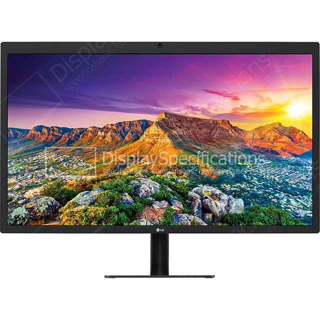

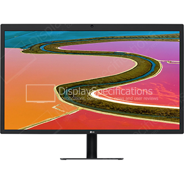

This website listing display specifications shows both have the same LM270QQ2-SPA1 panel. FWIW...
